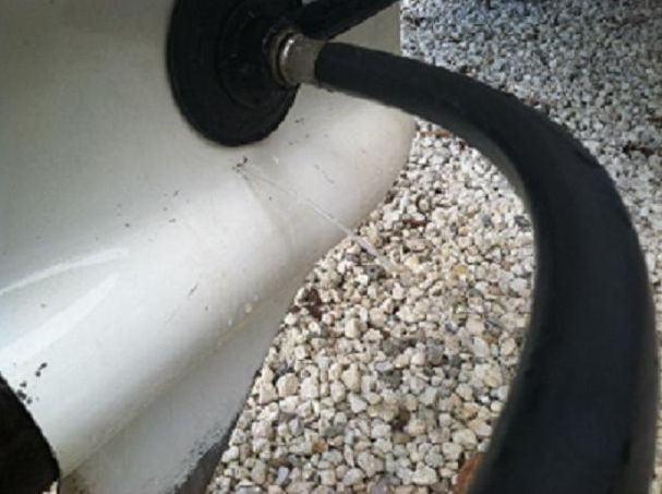

First off, I feel like an idiot for not knowing this, but does water normally come out of this hole in the lower unit? I don't really remember seeing water shooting out of this hole. See below:

There are all manner of drain holes specifically designed to get your shoes wet when running on muffs. Don't worry about them (the holes).
You cannot test a water pump by running on muffs. Have you checked the temps with the boat in the water?

I was running it on the muffs. I'll have to see if I can drag it down to the ramp if the weather cooperates.
This whole thing started because not long ago I felt the "pee stream" while the motor was running and it was unusually hot. It hasn't done that since, but it made me wonder about the health of my cooling system.
