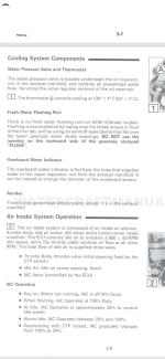

Where is it then? The manual says below oil reservoir?

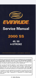

Are you finding this in the SUZUKI manual for your motor ?----What manual are you using here?

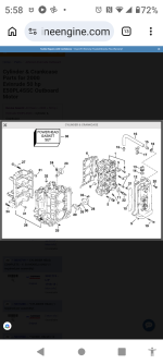

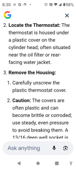

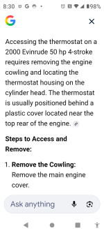

So this should be the assembly, and where does this go on the block?

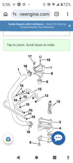

Parts 5, 6 and 7 will give you "the glory" but like everyone says....you need nothing. Follow the yellow brick road and get what the scarecrow needed. 🤓

This should help
