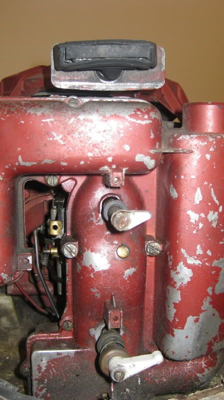

Well, I'm converted. Looks like a Javelin powerhead. Cut off switch is upside down, but that's the only thing that doesn't look right to me.
Someone has obviously done some work to it. Maybe they swapped powerheads, but it doesn't matter. You can easily restore it to original if you so choose. If you do you will need the manual throttle lever and cover pictured below. The cover and lever isn't unique to the Javelin so its not hard to find.

The Javelin is a sought after motor. What is your model number? I don't think you have Javelin. The 1956 has a red (Holiday Bronze) midsection and lower unit. Also, I don't believe the Javelin was offered with a tiller handle. Your motor is white even below the re-paint and has a tiller handle. Also, the tiller grip looks like a 1957-58. You probably have a 35 hp hiding under the cowl.
Yes get the water level up, but you should still replace the impeller. Especially, if you ran it for any length of time without it in the water.
Your motor should like Steve's.
That "D cell battery" sized thing is your choke solenoid. It operates the choke only when using remote controls.
3/4 of a turn might be a little lean on the low speed jet. Standard start position is 1.5 turns out from gently seated. The top jet is the low speed and the bottom is the high.
True he has some parts finagled but I had a 56 tiller Javelin.Didn't appear to have been changed.

Yes it does and I don't believe you can convert a remote Javelin to tiller without changing the belly pan.One of the pictures someone posted shows
the remote style tiller stump.Not adaptable to a tiller.
Actually, I think it can. It looks like a simple swap when I compare my Javelin to my 25 hp Big Twin. The "stump" is only held on by a single screw and a tab. Looks like the tiller arm should bolt right in. Later models can't do it, but I believe this one can.
I certainly can't argue if tiller steer was an option ,but it still doesn't explain the white. Could have been stripped and repainted. I don't know.
