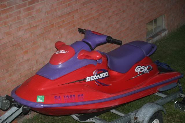

I know its off topic but Ill throw up a pic of the new toy...
Im starting to run out of toy space...

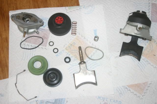

I had to clean the RAVE valves, and do some other routine maint. work...
