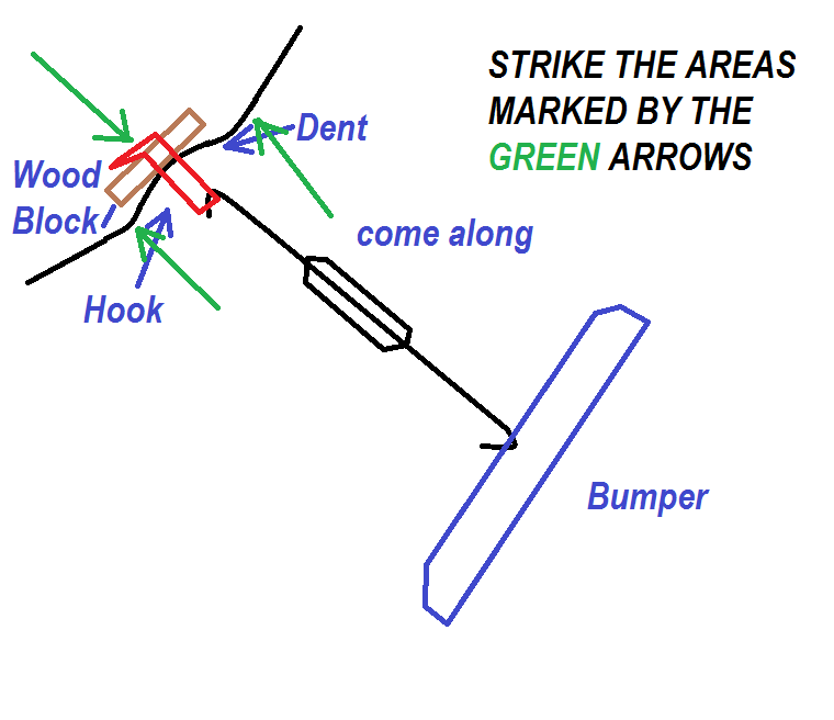

Odd push/dent in bow gunnel. Maybe PO hit the dock? I'm open to repair ideas? Rubber mallet?
Your alum skin should push out no problem but the gunwale trim may end up cracking on ya so go gentle broham.

Brutha Bear,
Good on you getting the all set up for some indoor winter fun with your new tin tub...
My suggestion on banging out the dent is similar to "maryhannaj"s" idea...
Use a chunk of wood to help spread the blows, but instead of a buddy, try to rig up a come along with a deep hook attached to rub rail and anchored to a fixed spot, like the bumper of a car/truck...
Apply tension to the come along and a firm application of force using a 2-3 pound sledge on the wood...
Start out easy and get a "feel" for the amount of force needed...
Here is a bit of a sketch showing what I envision...
As it begins to give apply a little more pressure with the come along...you might have to ratchet strap the hull down to the trailer in case it wants to "walk" off of it when you begin to apply the pressure from the come along.
Use a rubber mallet on the outside part of the dent to help shape it.
As you get closer to the original shape, you can use a smaller piece of wood to localize the pulling pressure to get the curve and switch to using a rubber mallet for the last bits...
You will probably have to adjust the angles between the "pull" to get the dent to go where you want it to and to keep the "hook" in place...
Hope this helps some...and have FUN!:D

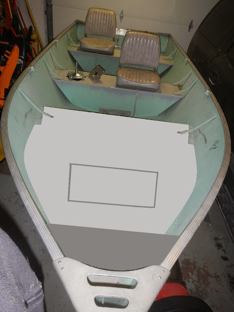

I'm trying to use as many parts I have laying around on this build. Seats came with the boat and plan on using the style of mounting hardware shown in the pics. I'll have two adjustable posts stashed if higher seating in favored.
In the bow area I'll be adding a casting deck with seat, storage for trolling motor battery and whatever else will fit. Quite a bit of room actually. Not sure if I'll use the hatch in the pic, or make the hatch from plywood cutout? The small forward bow step is lower than the forward bench seat top... I'm thinking of using z-channel aluminum stock to raise the bow step level with the bench, and tie it into together for extra deck support.

Re: 14' Sea Nymph Oh Yeah! Now 1971 LUND 14-S
This is kinda what I'm thinking for the front casting deck. I'll also be adding a small plywood deck aft of the bow cap for my trolling motor mount.
Darker grey would be trolling motor mount deck.

It is going to be a nice fishing boat when you are done! And not a bear to haul around either...

Nice little fishing boat, it should fit the bill alright. The flat deck is a real good plan and if you're planning on keeping the tin seats the way they are then I have a suggestions for you.
I've had similar boats with that style of seats. I know that there isn't any way to securely fasten the swivel seats to those thin tin seats. What I did was build a frame that I mounted the swivel seat to which had 4 legs spaced far enough apart to drop over the sides of the tin seat while the swivel seat rested on the top. They could just be lifted out too. With those 3/4 pin seat bases you'll have to make a huge hole in the tin to accommodate them and once again no way to back the thin tin without removing the seats and foam to get a backer on there.
Makes me want a little tinny now!
Thanks I love the boat!
Actually the seat bench tops are 1/2" plywood. So I'm thinking my seat mounts should be plenty sturdy.
