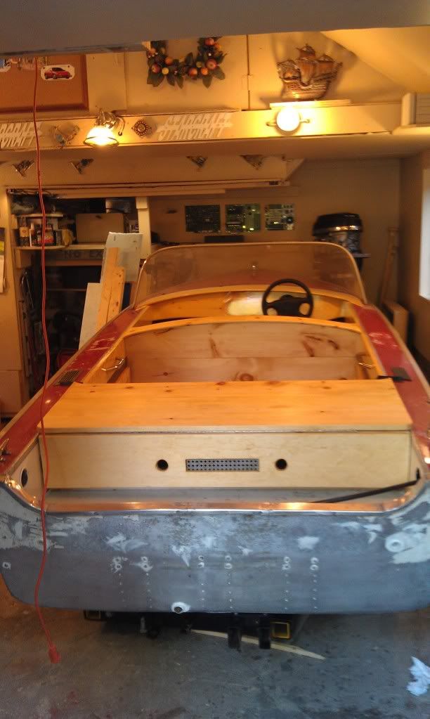

Quick update:
Managed to get the back seat with LED light underneth installed, plus the back seat back part as well. I also cut the side pieces for the rear quarters as well as the signature "shwooop" pieces for either side. Just need to finish them up tonight and I will snap some shots with them installed.
Also remember to connect the rear LED light to the panel under the dash... realized I had not since there wasn't a light and I did not want to short anything out while testing the system with the battery hooked up.
So next up over the next few days:
- finish the rear quarter side pieces
- grab handles in the rear quarters
- splashwell wood pieces
- attach/hinged etc the sun deck piece
- sand everything
- spar everything
Then I have some odds and ends to get done before painting.

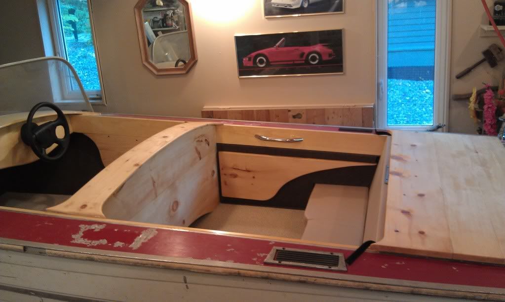

Ok... fair bit more done... essentially, the interior is done! Just gotta put 2 more coats of spar on the wood...
One coat of spar on the above photo's. Just realized that it kinda has a fiat 500 front end to that back piece!
Short list is now written on a small piece of scrap wood... so it's getting closer to completion... I can smell it! :)
Ended up using a piano hinge for the sun deck... worked great. Just need to get a "thing" to keep the lid from falling closed when it is opened!
Anyway's fella's have a great father's day to all the father's out there!!!
Jim

I noticed you only have one drain hole from the bilge. What happens if water collects on the other side of the support? I am having the same problem and not sure of what to do.

At the back of the transom braces there are holes to allow the water to drain through the braces from side to side... I made sure they were clear of any debris.
