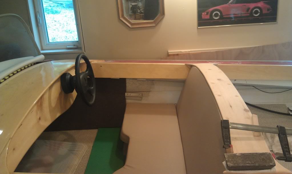

I've got a tough angle to deal with... you see I have the back of the seat meeting the seat back that someone sitting in the back seat will be looking at all while curving laterally across the boat. Then I am screwing and gluing a seat top pad of wood with radius curves where it meets the gunwales --- both front and back. Like an old Chris Craft --- creates a cockpit like environment. Anyway... the seat back top will be sanded tonight to be conistent with the backer that will be looked at by the folks sitting in the back so that the seat top pad can be properly screwed and glued down.

You mean something like this Jim?? behind the Captains seat.

Bingo!!! Just won't be anywhere near as nice as that!!! :)
Also no seat way at the back and no step through at the front --- it's low enough to just step over! But in principle... that's more or less what I am doing for the front seat top!

Yup. U gotta it there... that's what I am doing.

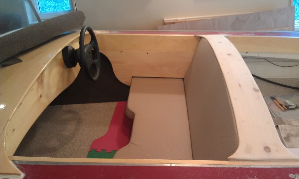

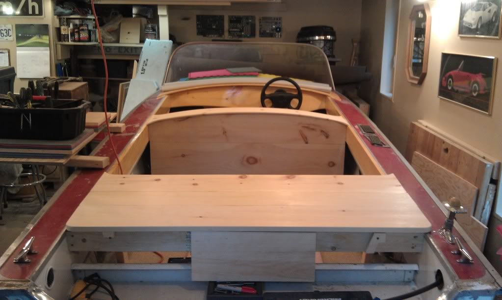

Hey fella's... got some progress to show here...
Got the seats (bottom and top) installed and secured + the side pieces with a gap at the bottom just so that there is no moisture trapped there. Then I installed the top pad... which went well... interesting. Because the seat back is at an angle it creates a little curve in the top piece as the top piece is curved over the top of the seat! As a result I had an interesting time marking the curve and then cutting it to fit. Anyways, got it install first time... but it was a little un-even on the top of the seat... so I thought... no problem, I'll just unscrew it and put it back on! Well... it ended up with a split in the wood, some mumbling --- well a lot actually if I'm being honest... and some PL and a clamp...
But... it turned out decent --- not perfect... but such is life
Then I got the 60 rude all put back together and ready for testing this week.
Got the back of the seat installed and somewhat sanded... not done the curve at the bottom yet or the screw holes... but getting there...

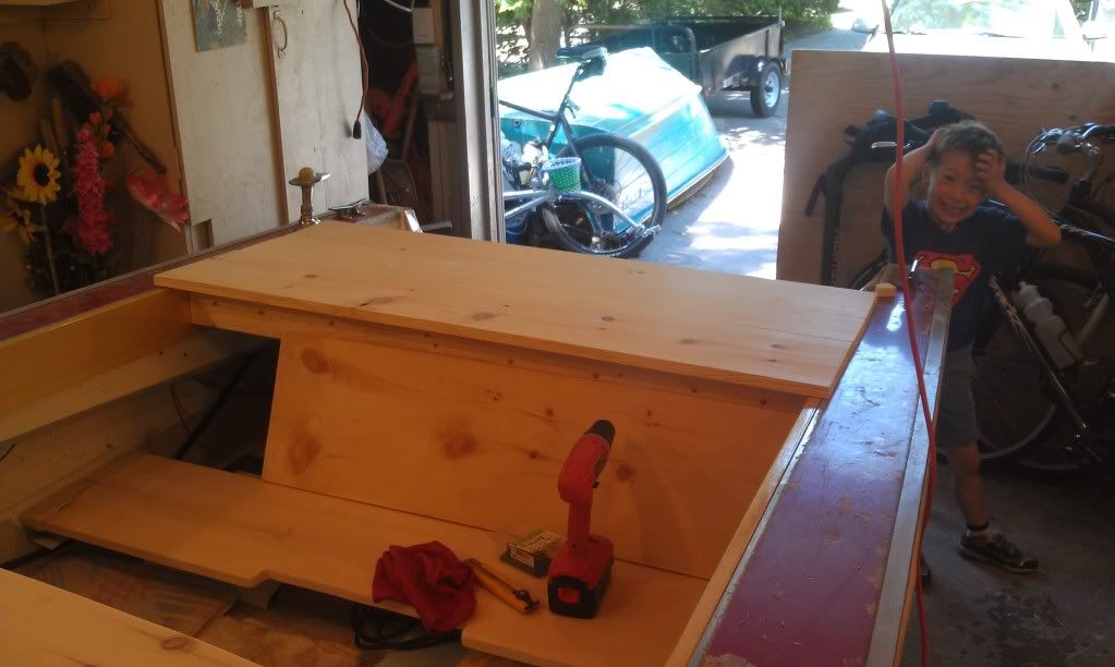

And lastly I got the back deck framed and the sun deck pieces rough cut and the seat bottom is cut. This is the next part of the project...
Superman leaped into that shot!!!
Lots of sanding to do on the seat top pad ends and screw holes plus the back of the boat... but I am starting to see the light at the end of the tunnel.

Looking just awesome Jim

Coming together real nice Jim. I really like the design.

Nice work!

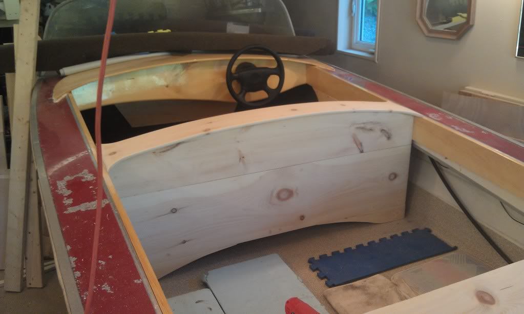

What's between the front & back pieces of the front seat vertical?
I saw this the other day & thought it might be something I'd like to duplicate 1 day:
Can't have too much storage on most boats. And it'd certainly look like a 1 off.........

Man that's one sharp design!! Are you improvising as you go or has this been the plan all along?
good idea JB...a ton of space in those seats for some compartments...even hatches.

I can just imagine you cruising around the lake & turning heads. Love the curvy features, it'll surely be one of a kind!

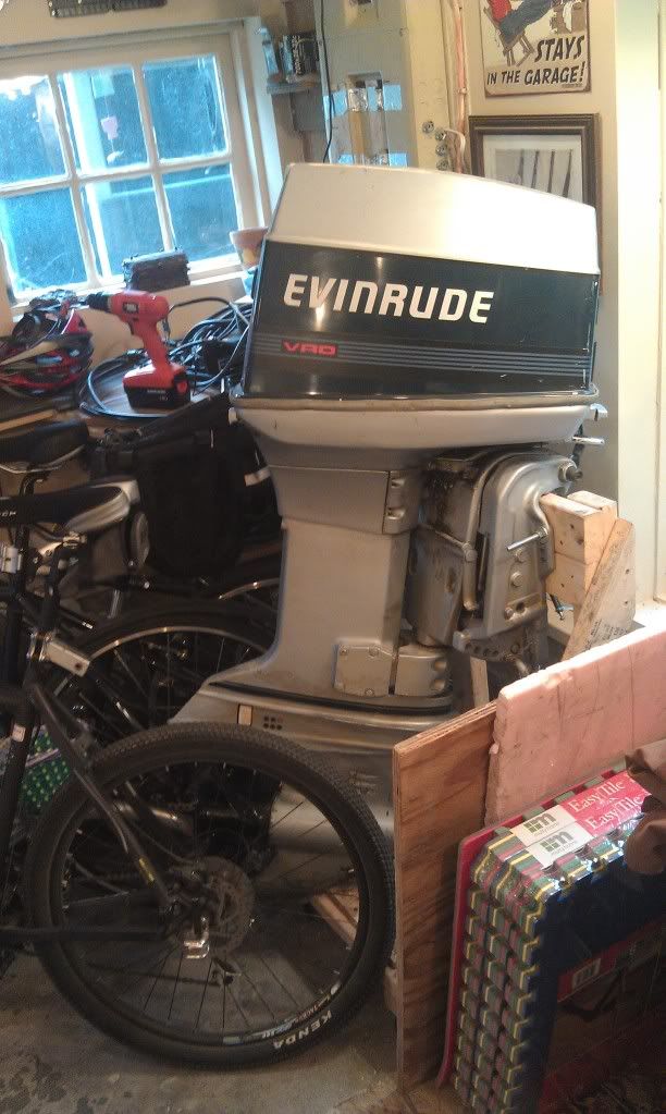

Are you concerned at all about the extra weight of the wood & the 60?

Thanks guys!! It is coming!!!
JB - Interesting idea! There is not much room there to be honest --- maybe a couple of inches... but could be incorporated into the next boat!
BF - Most was planned --- but some of it was definetly improvised!!!
LL - Nah... the 60 is not going on this boat. A 50 johnson will be! Surprising the weight of the wood is less than 100 lbs... I weighed it. So figure the weight of 2 back to back seats is gotta be in the 60-80 lb range for the two... it really isn't much more. My concern was having the wieght/ center of gravity too high.... we shall see!! Good news is that the foam for the seats and all the wood ADDS to the floatation of the boat!! :)

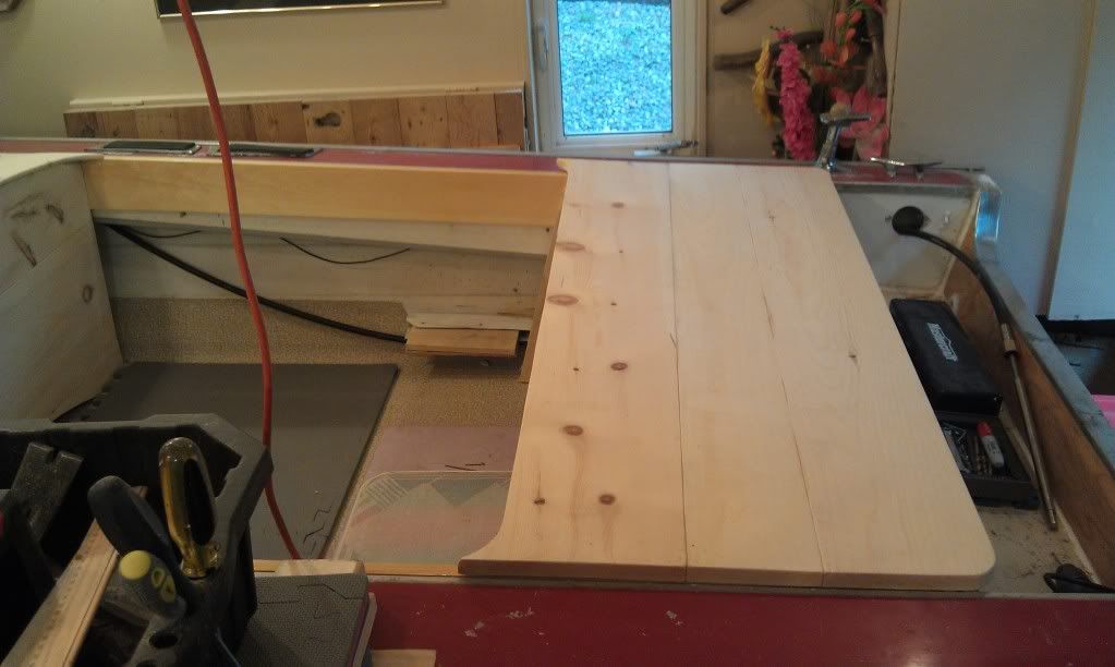

Got the back sun deck thing cut, glued and screwed together. I added about 100 lbs of weight on top of it over night to make sure it didn't twist while it was gluing... and sure enough it is straight! I also added some ply underneath to screw the board to from underneath.
Little rear end shot of the boat... note that I have to add a board to the back of the sundeck as well as the sides of the splashwell. I am going to leave a gap at the bottom to ensure that the boards are not in any water...
Also build and foamed the seat back and bottom. I installed the angled supports for the seat back and did a major clean of the interior of the boat and the floor! It really was ankle deep in all manner of stuff --- from tools to foam bits to saw dust etc etc etc.... good shape now!
So there you have it... moving forward now! Next is to vinyl the seat back and bottom, install the seat bottom supports and nice little bits, fab up the two side pieces and install them. Then a bunch of sanding and spar and voila! A couple of hinges and struts for the sun deck and voila!!!! the interior is pretty much done!
