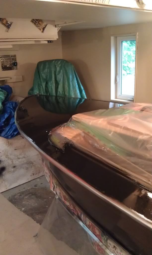

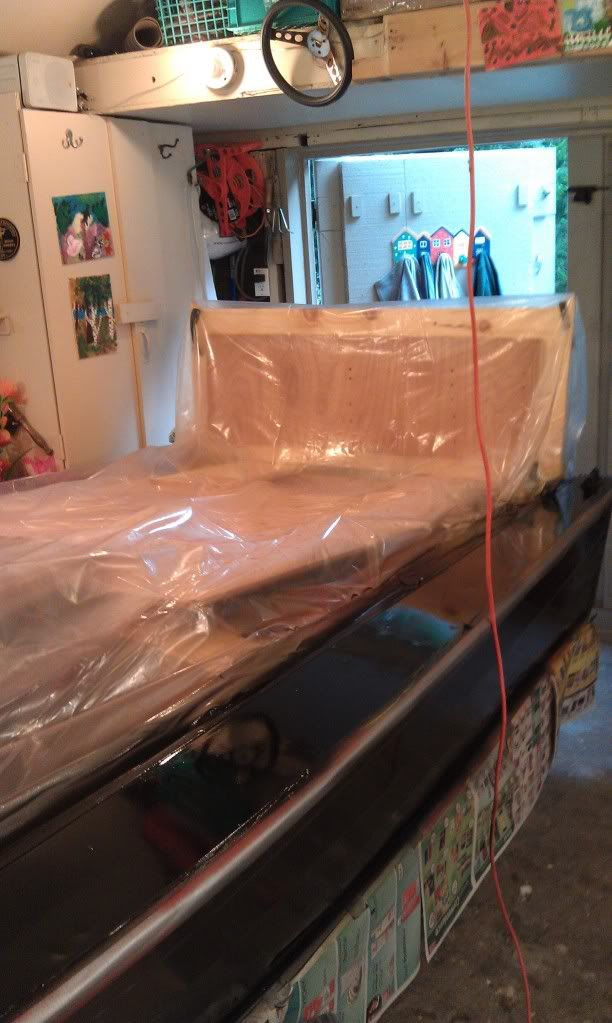

Ok... Ok.... I know... no pics no done....
Rattle cans for the etch and primer... HVLP for the black. 25% acetone to get the sprayer to work well.
Ok... Pics of the boat...
Before all wrapped up:
After bowwise:
After Looking sternwise: Note: the semi painted silver on the rub rails is duct tape!
Came out pretty decent. Only area that is not is at the stern where it was pitted due to the PO having a piece of PT plywood.
Two options: Leave it and have it look like pitted pavement... or I can spar up a nice piece of wood and screw it and glue it over the whole area. Give that the next owner will be keeping it garaged I am not concerned about rot. It really comes down to looks at this point. So... my vote is for the hunk O' wood.... anyone got any semi-convincing arguments against??? :)

Shiny and black. :thumb: Hunk o'wood sounds good to me, IM.

All of that light wood is going to pop off of that black! sharp!
Is hunk'o aluminum out of the question?

Looks great. Can't wait to see it out of the garage all finished.
Don't forget to make a video of its first splash.
Not sure what area you said was pitted. Gunwale or transom? Some nice shiny aluminum diamond plate would look amazing next to the great woodwork and shiny black paint.

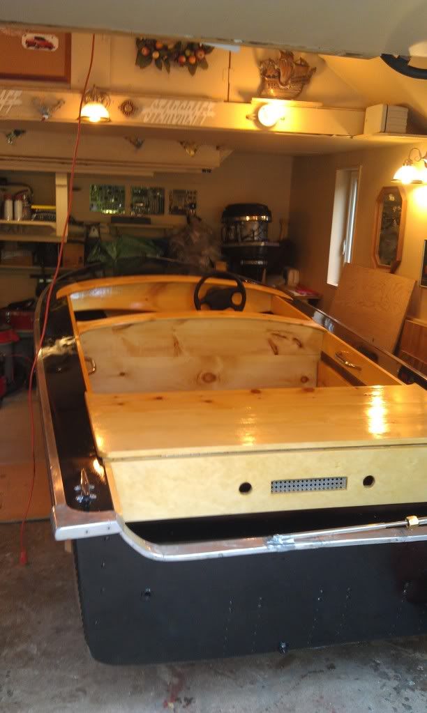

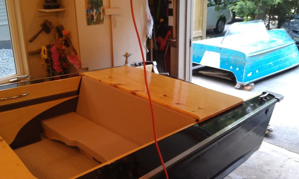

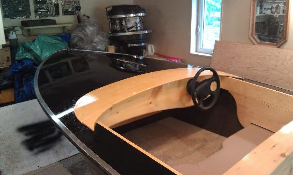

Here are some post taking all the wrap off pics...
What is doesn't show is that I cut the line of paint on the sides just above the splash thing (forgotten the name... heat stroke I think!). Using the green frog tape really worked fantastically!
I think the Falcon in the background of the last picture was just a little jealous... :)
Have a great "HOT" day!!
Off to finish the windscreen and cut and spar the transom board.
Gonna wait a couple of days before putting all the hardware on the paint --- to tacky still and it is just to hot and sticky to dry fast right now.
J.

The black n' wood combo looks pretty cool man!

Much better with with the masking gone, Jim. Black and natural wood! :thumb:
Is it the chine you masked below? The splash thing?
