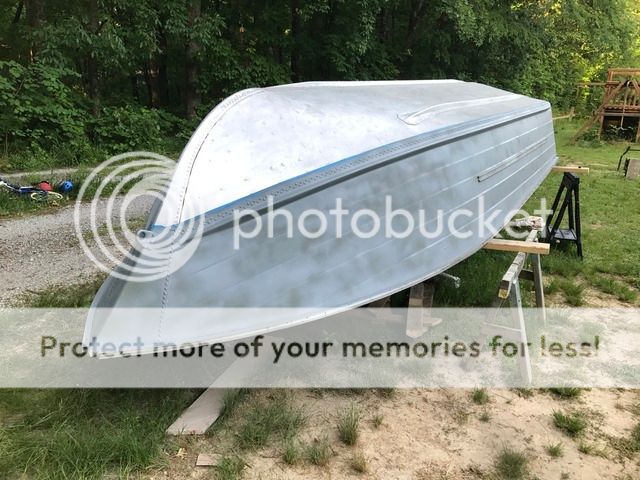

Ok now we're getting somewhere! 3 coats rolled on following Woodonglass' recipe. 1 day between coats, scuffed with scotch brute and rubbed down with mineral spirits dampened rag. For now I'm sticking with the KISS scheme
Paint seems quite durable, and I certInly wasn't going for gloss so some orange peel is no problem.
Almost time to flip and start on the interior!!! Happy dance.....

Still a few screwups to clean up where I painted outside the tape lines. However, I don't think I actually entombed any insects. Oh well, maybe next time.

Yeah man she's green and no poo or bugs :heh: and one step closer to the back on the trailer and the rebuild, exciting times!
