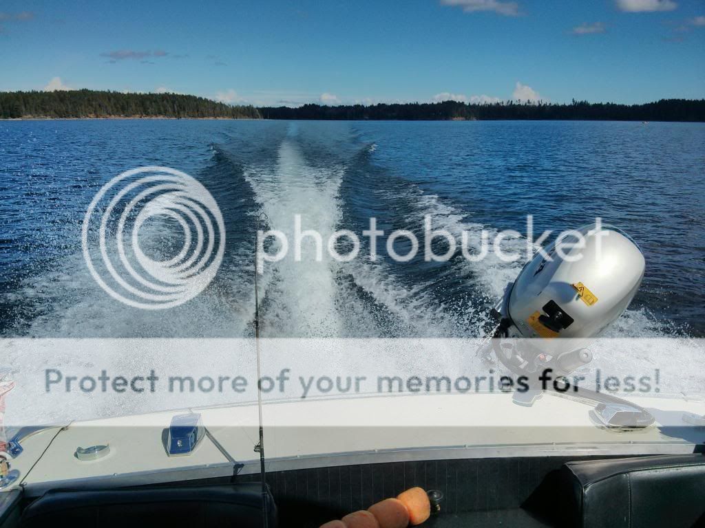

you mention you have a kicker - how do you steer it?

I fabricated a stainless plate for the top of the out-drive, a bracket for the kicker leg, and used air-hose quick disconnects attached to stainless threaded rod. I then purchased a telescoping steering arm from the local marine shop, added the male air-hose pieces to the steering arm and it works perfect. I don't have it connected in this pic but I can take a picture of the arm if you want. When trolling I leave the main motor down to help rudder the boat while the Honda is running. I start the main motor for quick turns.

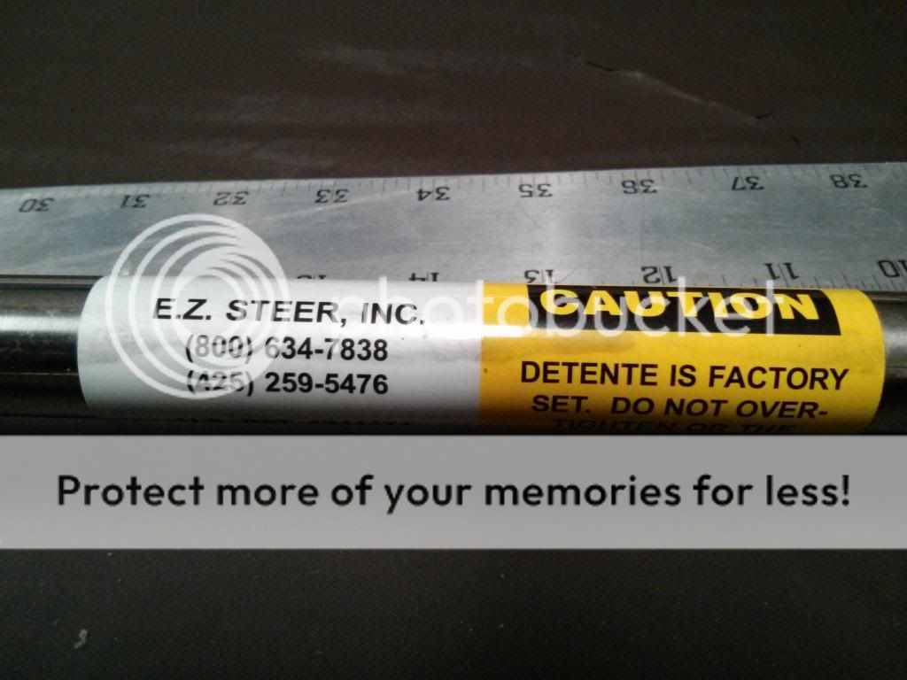

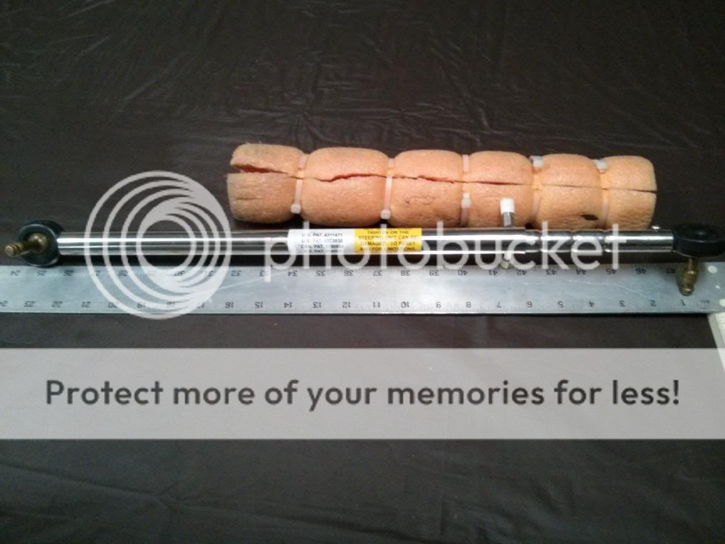

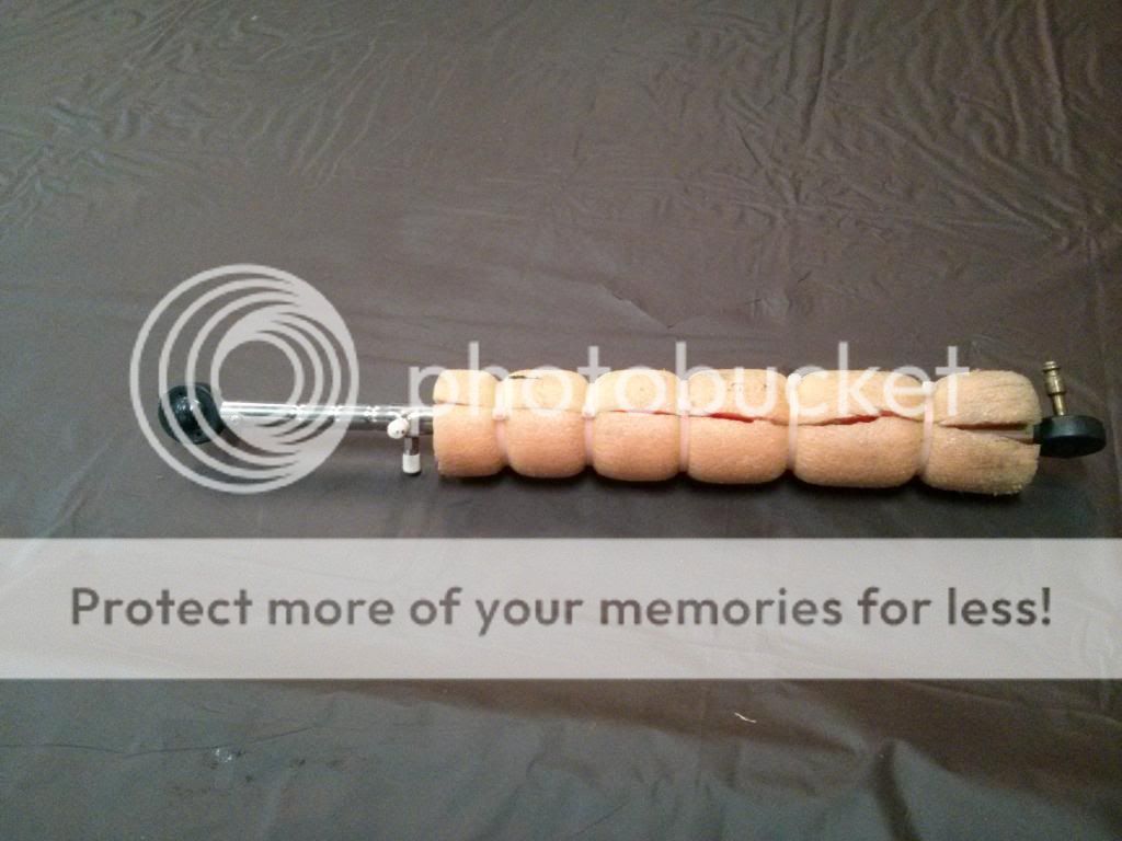

This is what's called an EZ Steer. It Telescopes, once you have your distance between motors you tighten up the set screws. I have added the float so it doesn't go to the bottom...
Thanks for the info about photo bucket... seems to work better..
Redneck Joe, I think I only paid $50 for this piece, it's stainless, but maybe the phone number on it will help...

ok I thought I was looking at the EZ steer but thought more than that. BTW call me Joe or RJ.
