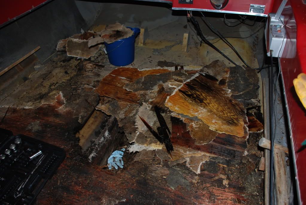

I have been reading more posts and I do want to make sure that I have positive drainage as well. I will post pictures of my progress so far of ripping up the fiberglass from my deck.

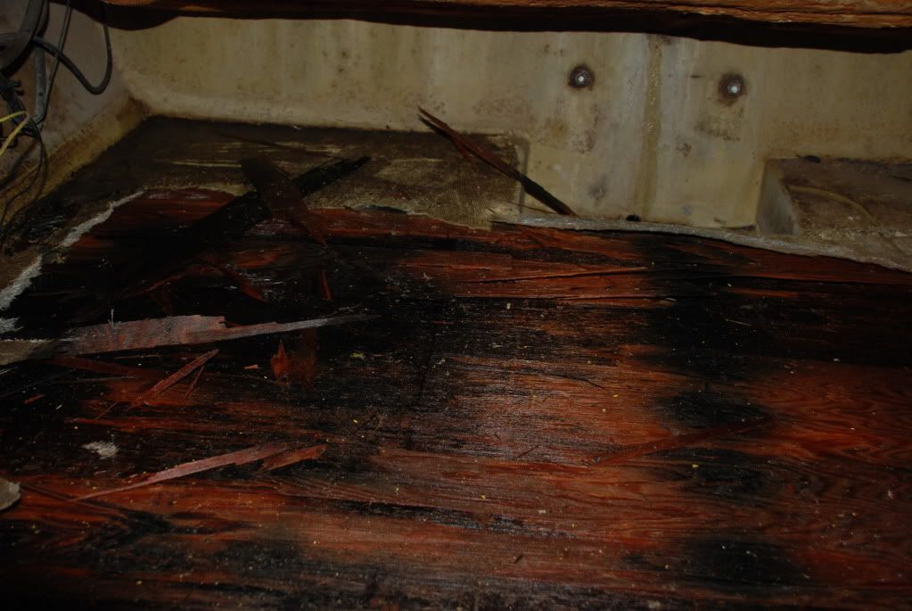

The picture you have there strongly resembles what I am dealing with wood wise in the deck. I still need to inspect my stringers and my foam.

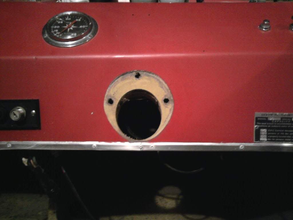

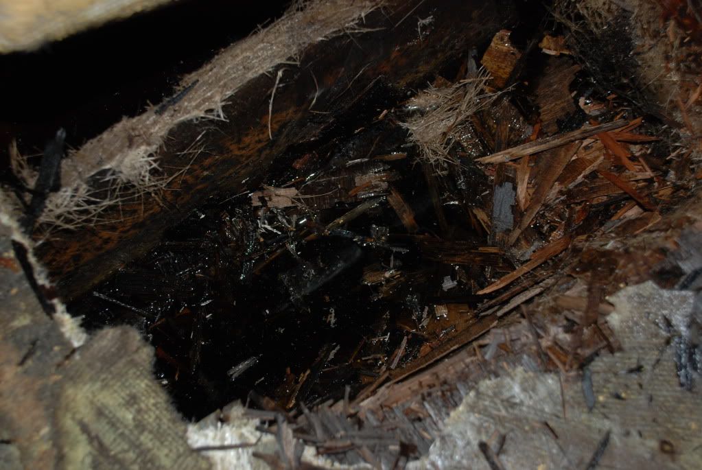

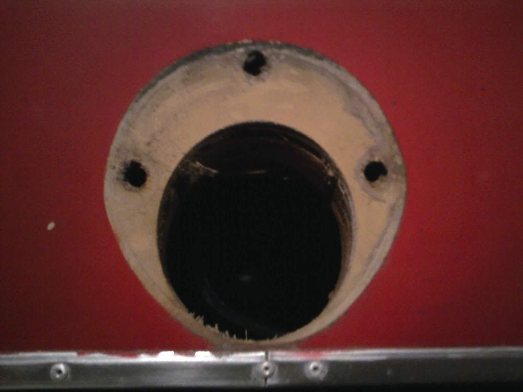

Removed the steering mount due to my steering cable was bad and found out that the new steering mount does not fit the holes so I need to replace the backing in my console due to the size of the holes. I will need to remove the old wood and replace with a new piece without harming the fiberglass exterior of the console. The deck in my boat has finally dried so that I can do a better assessment of the condtion of the rest of the deck and examine my center stringer.
