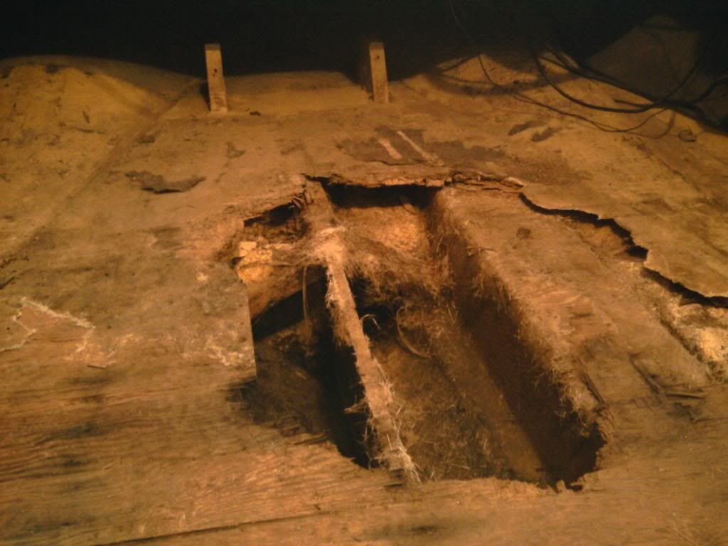

When I drilled out my holes for my transom mount for my steering regular sawdust came out instead of anything wet or discolored so I am not worried about my transom. I will inspect my stringers once I get the deck removed but, this is what is looks like so far under my deck.

Yeah I would get that wet deck out,check the foam for water saturation. If your foam is waterlogged you may be looking at a stringer replacement.... Get some pics up when you can and we will help you evaluate what to do next.

I took my boat out to a local lake and it started on the first try. I am pricing 1/2" plywood AC/BC grade or exterior grade from a local lumber yard. The next part of my project is cutting out the remaining decking material. My biggest challenge is how to fix this irregular hole in the deck. Any suggestions on how I can work around these rises along the sides with my deck replacement?
Just duplicate what SeaSwirl did, cut/grind out the old deck plywood and replace it with the new plywood,,, cut to the same size/shape. Don't try to repair the hole, replace the entire section of plywoo... IE; cut the entire deck out and replace the whole thing.
Check out the looooong post by oops! "hull extension" something or another. it's going to have all the info you'll need for your project.
