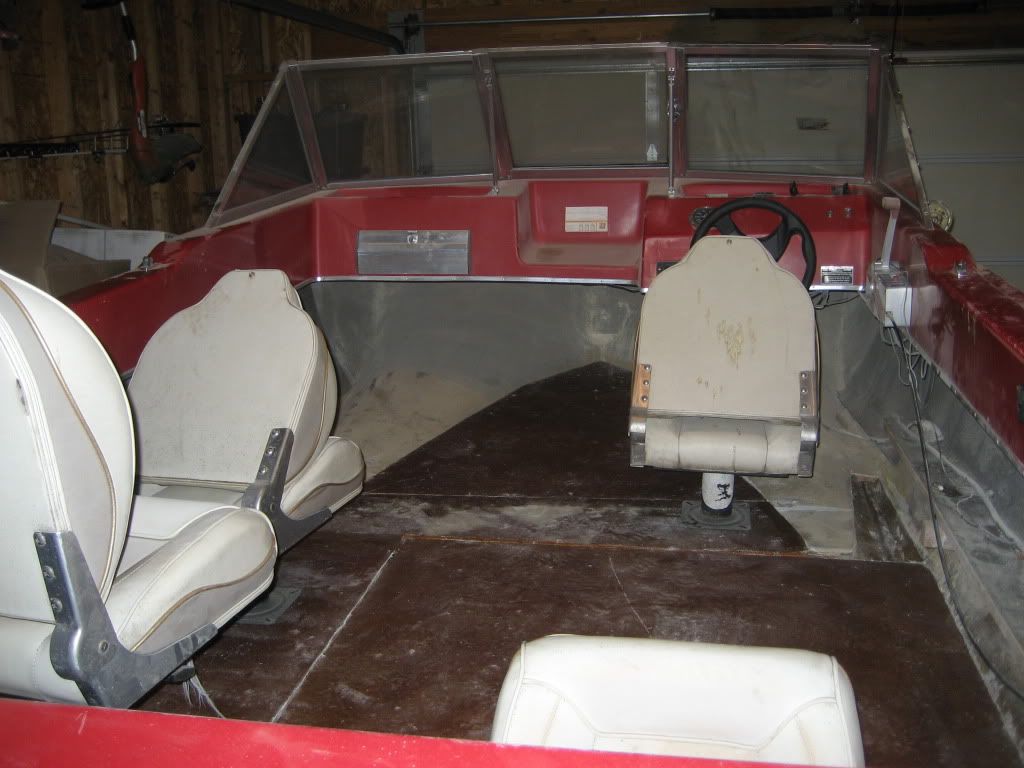

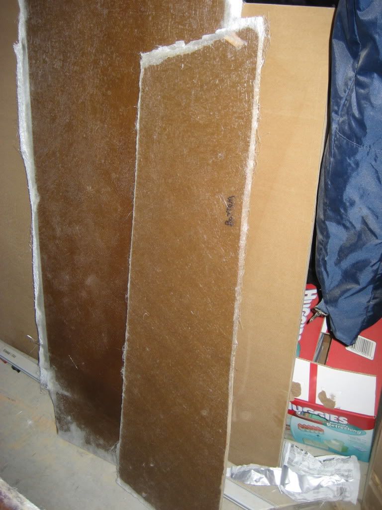

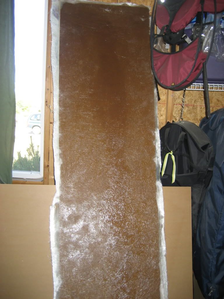

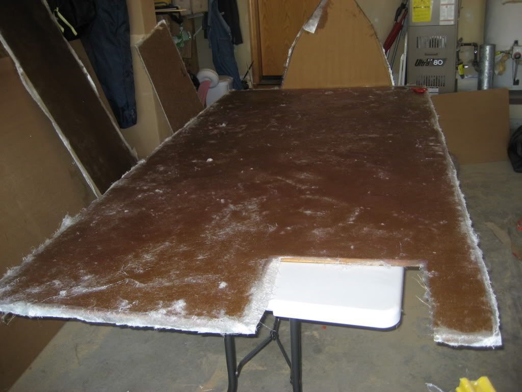

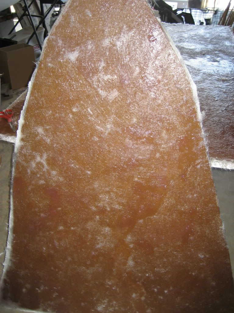

Between last night and this afternoon I glassed the underside of all my plywood pieces. I still have to do some sanding and then glass with more CSM on the top sides before I take my boat out for a test run on a local lake to ensure i don't have any leaks I need to fill in the hull. I have also included some pictures that I took today.

Looks like a lot of dry spots to me (or is it the light angle). Did you precoat the wood with resin, and use a roller for those large areas?
Just wanna make sure you got a good seal on your plywood..

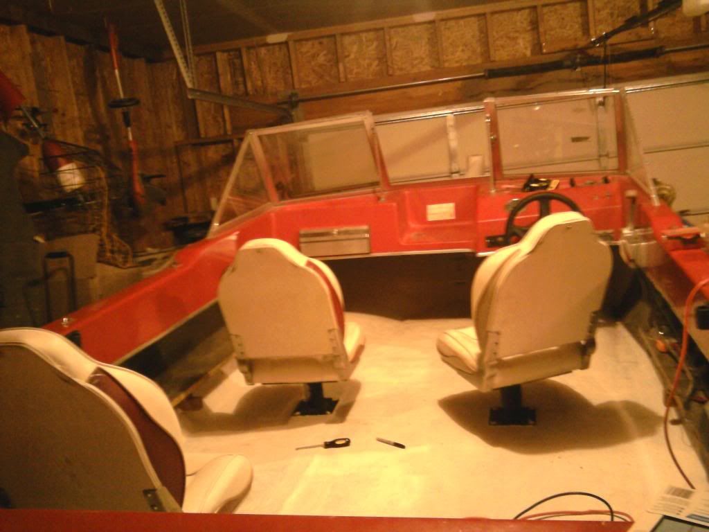

I have finally uploaded some new pictures to photobucket. Some of these are old and some are just from 2 days ago. My first restore so gave it my best. Tonight I was applying some Kiwigrip for the finishing touches on my deck

I applied my Second coat of Kiwigrip. Now I just need to register it and insure and I still have some electrical work to do before it is a complete project.

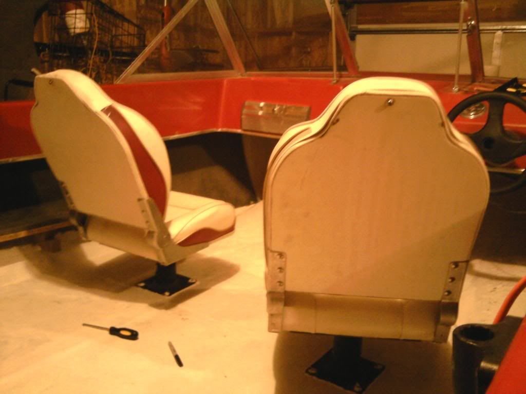

jigngrub
Mar 19, 2011
8,155
Re: 1970 Sea Swirl 16 foot with bad wood floor
How did you install the bases on your pedestal seats?
You've done a lot of hard work on that boat and should be proud of it now.

Jgngrub I pre-drilled my holes smaller than my bolts and applied 3M 4200 inside the holes on my bolts and underneath my pedastal bases so that I have a strong and water tight bond. It wasn't too hard and I referred to a post that Woodonglass made on another thread.
