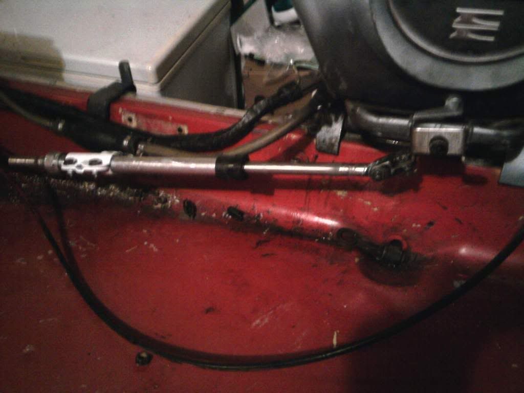

I recently complted my project with my steering and it works great and I attached a picture of the completed installation.
