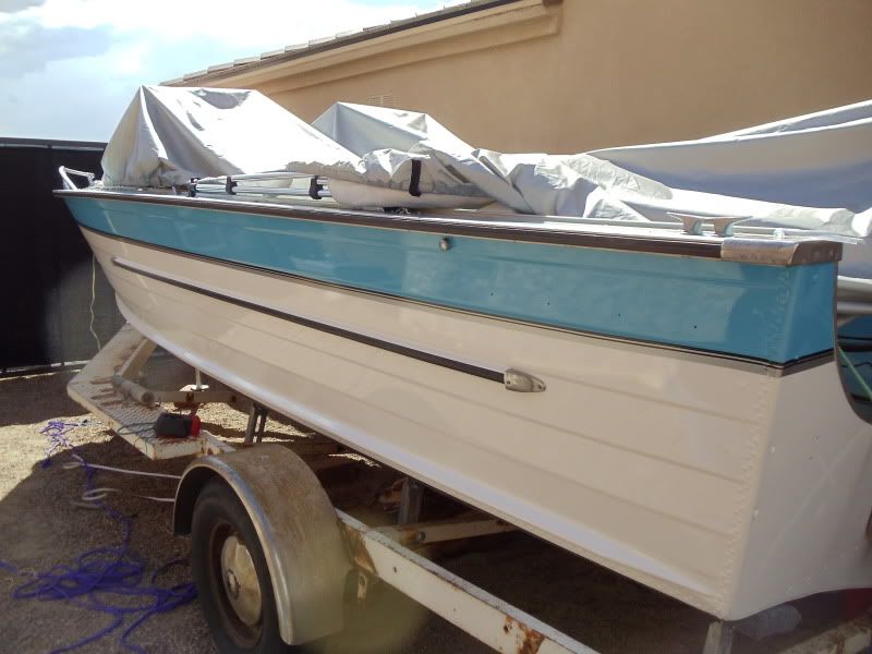

Okay...more progress this afternoon. I didn't do much but it is another item checked off the list!
She now has a stripe. This wasn't too difficult but it was time consuming and tedious. It isn't perfect and I still have some air bubbles to work out, but hey...it's mine! It is black on silver...the same colors I am going to use for the Starcraft logo.
I also bought some close end rivets and a gun today. I just need some 5200 and I can fill the badge holes with my tiny 1/8" rivets, and also reinstall the transom hooks.
Here are some more pics:

That stripe really makes a big difference. Beautiful.

fan-friggin-tastic!
