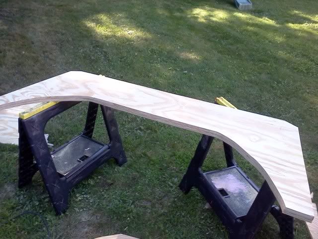

Last night I got the two 3/4" transom pieces cut out and made an epoxy sandwich. Just got the clamps off and hope to get a coat of epoxy on it yet tonight.

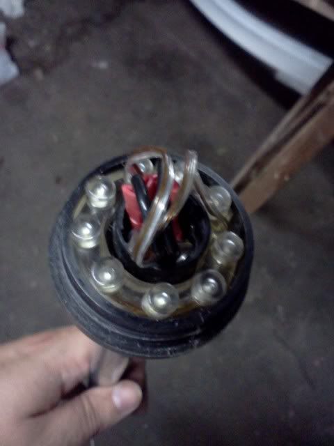

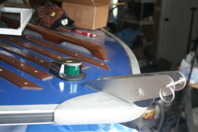

Mounted up the bow and stern lights. Also put an anchor roller on the nose, wanted something I could manage the anchor with and not have to crawl out on the bow, prolly not the best looking thing but its functional. My bulb was burned out in my stern light so instead of getting a new bulb for it I managed to trim down one of my extra LED strips and wired it up inside there, worked out great.

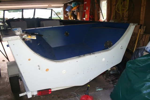

Got the transom in, spashwell drains, the rear corner pieces and that top transom trim done.

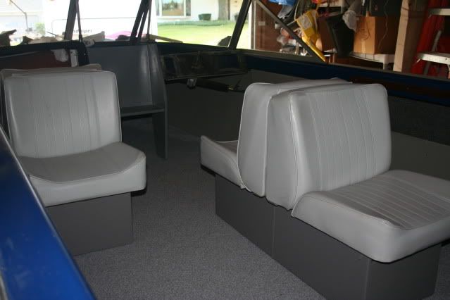

Seats are mounted on the bases now and rebuilt that step piece that goes between the dash pods.

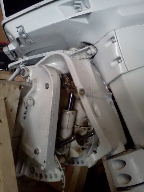

Installed my tilt and trim on the motor, that is going to be sooooo nice to have.

Great progress Charlie :) Those rubber boot thingys for the cables on the splashwell look new if so where did you get em ?? Thanks.

Looking good! Yes, TnT is a fantastic upgrade.
Thanks guys! Hey yoop, the one in the center is new, iboats has them and other places. Look under control cables I think. The other I salvaged.

Great looking boat with the upgrades. The deck looks nice enough to sleep on. Just need a camper top and it'll be some all night fishing.
I'm digging the paint spraying myself compared to rolling after doing the trailer.
What kind of anchor roller did you do...
