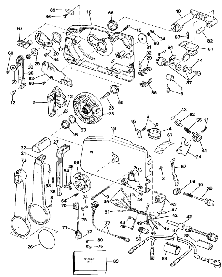

Quick question if any of you guys happen to know: I have two wire harnesses coming out of my controls. One set is obviously the T&T. But I don't know what these are for???

In the parts list for a 84 90hp, the remote control shows a battery cable + & - running to the control box. Part #87 in the 1 of 6 model #'s I looked up....

An '84 was set up to have a kill switch clip lanyard as a dead man/overboard switch, & an the ignition key, both as part of it's remote control box...
Which remote is this again? Hard to keep what parts came from what dead glasser straight :)
Oh, and then to have to remember the year, make & model of the relevant parts :facepalm:
1 diagram of the 6 models from '84:

Yah JB, sorry, different controls.
These are OMC, year/model unknown. Ignition switch is completely seperate on these so I can't think it would be for kill switch. Appreciate the effort!

Somewhere on 1 of the control parts there should be an OMC part #....
For a 60's bow light of unknown year & make, that came on the Jet, there's a small # cast into the interior, 6250-02, w/ that & marine bow light, my best bud google found the exact match Attwood light.... $90 on flea-bay:eek: Carp, should have paid the $30 & replaced it:facepalm:
There's no #'s anywhere on any part of the control box? May have to crack it open or look at the 'back', but since you're considering putting some silly-cone behind & under it, maybe that won't be such a big deal to pull it out for a #....

From a post on TheHullTruth:
SeaBOB4:
On a side mount OMC binnacle, without the keyswitch built in, there will be 2 sets of wires. One set, red, green, and blue, is for your trim and tilt switch. The other set, 2 wires, yellow w/red strips, are your neutral safety switch wires. __________________
Maybe.....

Neutral safety switch? That makes some sense!
