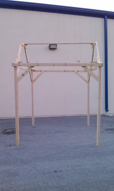

I've got a little bit of progress to report from the last week or so, still battling this Texas summer heat. Makes for a short work day when the temperature hovers around 100F before noon.
I made a shade cover from 2x4 dimensional lumber because where I am working has no shade at all. I covered it with a tarp and added a few gussets after this picture was taken. Considering the time and money spent, I would suggest just purchasing a canopy rather than going this route :facepalm:. Guess I thought this solution might be a better long-term outdoor storage solution - we will see.

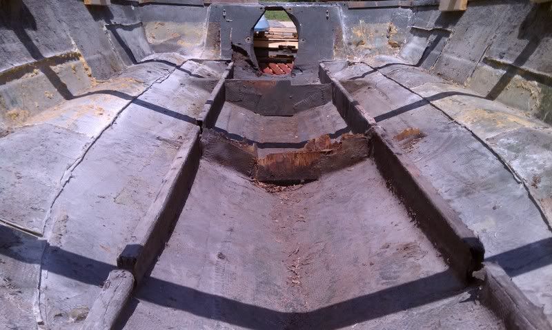

With the judicious use of a cutting blade on the old HF 4.5" angle grinder I took out the remaining sole in short order. To eliminate some grinding in the future, I first made a rough pass, cutting through the fiberglass ~2" away from the hull. After removing all the old wood I was able to make a close cut to remove the excess 'glass very close to the hull.
Here is the end result:
Now to go back and re-read all the excellent posts on how to properly measure and place the stringers in the hull so that the reconstruction goes back to factory specs. I have read many posts with some good info, just want to make sure I understand before I go cutting out any more!
Looks like tomorrow the stringers and transom come out, then the real fun of grinding begins!

That support system should be fine.....the only slight problem is the inside bracing being in the way when you're grinding inside. But to place it safe, I'd just remove one at a time...grind that area...replace the brace and move on....etc, etc.
I like the canopy cover frame....you can modify it when you're done and make a bimini top out of it for your boat....LOL (hope you know I'm kidding, but down here in the south, I've seen worse)

Cadwelder, LOL @ the bimini top idea, not too far off from some of the shenanigans that go on here in Texas!

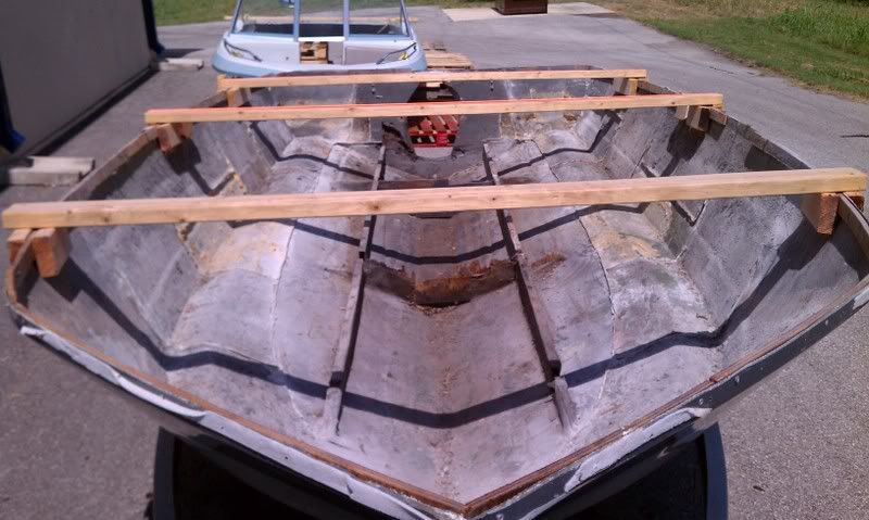

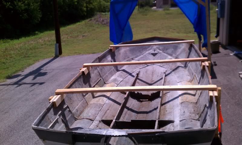

Crazy, what I did was after removing the cap I took 8 beam-to-beam measurements at the top of the hull, marking the locations with a Sharpie. These were taken before removing any of the old decking. This way, I can measure for hull flex before securing any new decking to the boat. I will also test fit the cap as needed to make sure I am still within the factory specs for deck height and such before glassing everything in. There are many ways to grid out the stringers to make sure they go back in the right places - my main concern is making sure they are the correct height as the cap sits directly on the sole. I plan on marking the old deck height by using a straightedge across both stringers, and touching the hull. By marking this height around the hull I can recreate the proper vertical dimensions. This is pretty much the same idea as using the string grid method I learned about on this board. I don't think the old deck had any crowning (bowing) but it difficult to tell for sure. No major issues thus far just the heat!

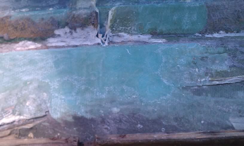

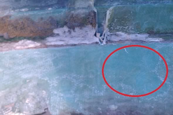

Despite reading quite a few threads, I have a question regarding grinding down old tabbing. I am assuming the only way to properly prepare the hull is to grind out all the old tabbing, getting back to the original hull. I want to make sure I am not grinding away more than I need to, and also to make sure the surface I am leaving behind is ready to properly bond new glass after cleaning. Here is what I have done this morning:
Hopefully the picture is good enough to see what is going on. This is the starboard side of the hull, the stringer at the bottom of the picture, the deck tabbing (middle left and right sides) and some additional tabbing at the top of the picture. Where I have ground in the middle, back to what I think is the hull, is the green area in the middle of the image.
I just want to make sure that is the correct - grind off all the old tabbing down to this green, smooth material which I believe is the hull.
I have gotten this far in about 30 minutes with a 36 grit flap disk on a 4.5" angle grinder.... not fun. I am headed out to get a larger grinder - this job will take forever at my current rate.
Any suggestions/opinions/etc. welcome!
P.S. The stringers are coming out, I wanted to mark the deck height by grinding out the old tabbing, then using a straightedge across both stringers to the hull to mark the correct position for the new wood.

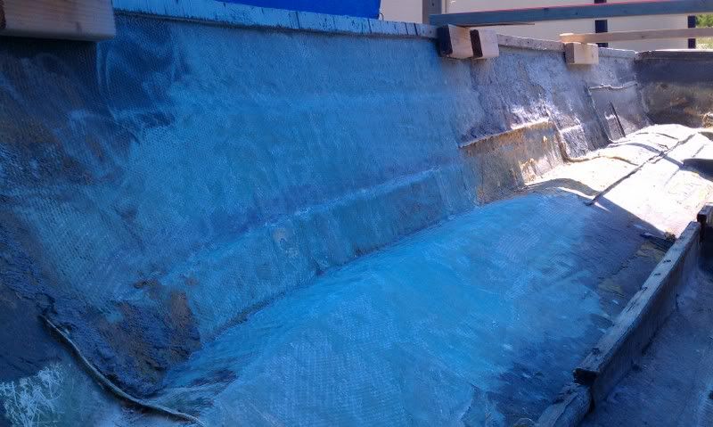

So here's a picture of the starboard side of the hull after some grinding, after rereading some older threads and watching frisco's videos on youtube, my main question is about adhering new glass to the hull:
What should I be looking for to make sure the old surface is ready to stick to new glass and resin? I have a better idea of how far to grind down, just want to make sure I'm headed down the right path.
Hope the picture is a little more informative than the last one.

The "Green" area in your first pic shows GOOD fresh glass that your New Glass layups will adhere to without any issues. this is what you should be looking for throughout your project. I would recommend switching from the flap discs to a back up pad and 24 grit sanding discs. My experience is they work much better and more aggressively. Harbor Freight Sells em

Thanks for the heads up Wood, looking at the pics you posted of the back up pad I can see a LOT more surface area for grinding than with the flap discs... Will have to get some before my next grinding session.
I'm not sure either of the pictures really give close enough detail to really see, but there is a lighter colored green glass and some darker colored "dingy" green. Is the darker color acceptable for laying new glass?
Thanks Wood! I spent about three and a half hours grinding with these discs and I was able to get a lot accomplished. MUCH better than the flap discs! I'd post an update picture but there really isn't much of interest. I think about 10-15 more hours of grinding and I will be close to rebuild mode rather than demo. Very itchy right now, I can tell you that! I couldn't get 24 grit at my local HF, only had 36 grit, but they worked nonetheless.
