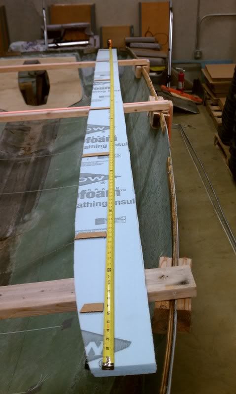

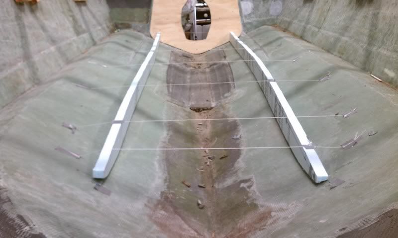

Completed the foam stringer mockups - I used the cardboard cutouts previously made to mark the height of the stringers: (I had previously shaped the bottom of the stringers to the hull contour)

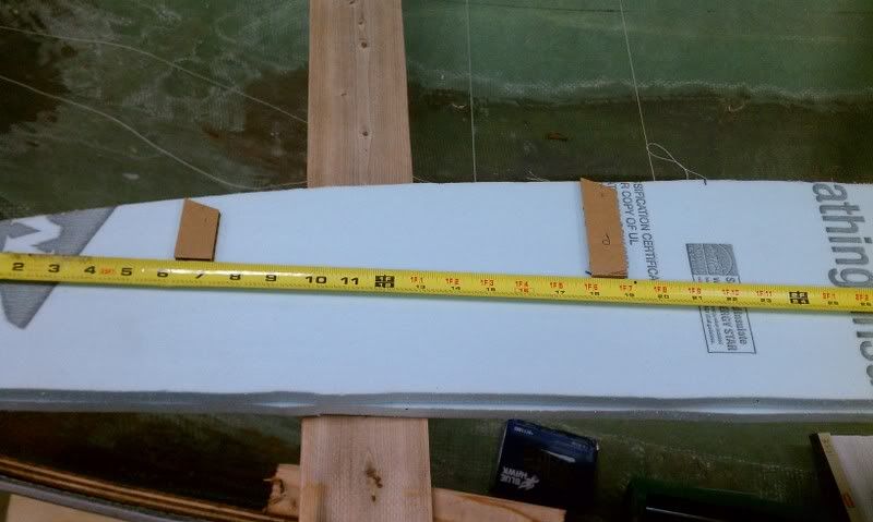

Here are all the cutouts in place, I then marked the correct height using a tape measure as a straightedge:
I then copied the dimensions onto some wooden stringer blanks I made from 1/2" Auraco plywood. The plywood was glued together to create two 1" thick, 6" wide and 12' long stringers. I used the trusty 4 1/2" angle grinder with a 36 grit disc to contour the bottom of the stringers. Once the transom is glued in I will do the final fitting of the stringers before bedding them with PL adhesive.

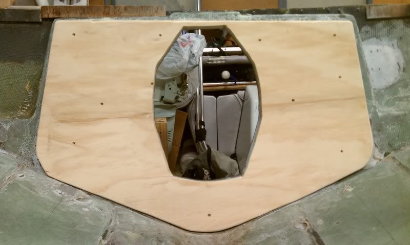

Speaking of the transom, here is the first one I made:
Looking at the top, it was clear to me that I needed more wood for strength. I cut another transom out, this time the top edge is about 1" taller.

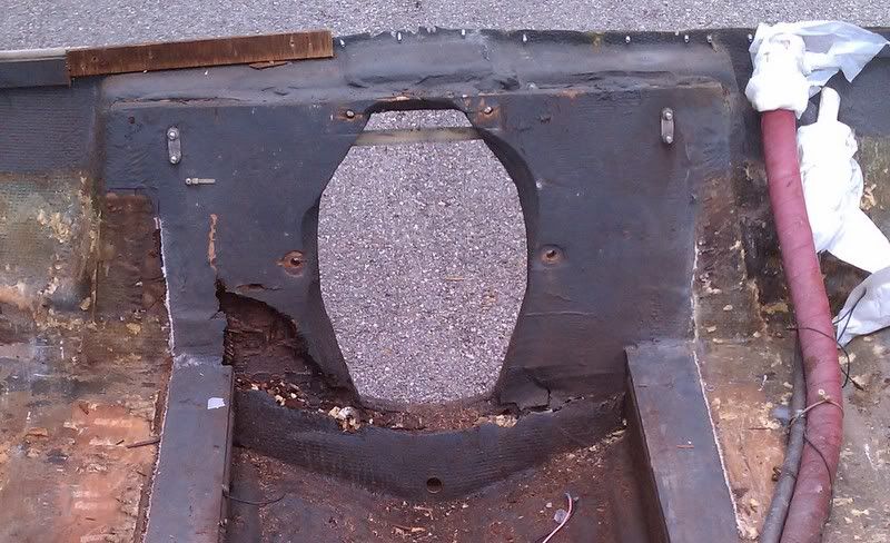

I am preparing to order some fiberglass materials - hopefully next weekend I can really get some progress made. I plan on waterproofing the transom before gluing it in place - here I have a question. As the picture of the old transom shows, there are some bevels I need to make to allow access for various components:
Because it will be difficult (I think) to lay mat and resin in these odd shapes, I am considering using epoxy for the rear of the transom (side facing the hull) and the area inside the cutout (keyhole?) for waterproofing. I would use poly resin, CSM and 1708 on the front of the transom and for tabbing. Does this sound like a reasonable idea?
I have read that several people on this forum have used PL adhesive to join the transom and the hull, which I am planning on doing. Has anybody heard of a negative outcome from doing this? EDIT: I suppose I could use the epoxy to adhere the coated transom to the hull?

Thanks Wood! I will go back and re-read Jay's thread - I thought he had sealed the back of the transom prior to install. My recollection is fuzzy at the moment. Any recommendations for sealing the "beveled" edges of the transom (pic above of the old transom for reference)? My concern is that I won't be able to lay CSM and poly resin down flat, and I don't want to leave those edges unprotected as they will tend to get wet over time.

From the looks of it, I'd say you could coat pretty much all of it with the PB, and then lay some CSM on top of it or some 1708. That stuff conforms to just about any shape pretty easily.

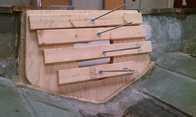

Wow, it's been a long time since I posted anything! I injured my right knee (MCL, no surgery) and was out of business for 3 months but all is well now. Not much to report, but I am getting back in the swing of things. Bought 5 gallons of resin from a local supplier, so I have everything I need to get this project back on track. Today I glued the transom in with some PL premium:
I have read some people like using PL for the transom, some prefer good old PB. Next I need to make some cut outs in the transom for various clearances. Once everything is test fit I can start with the glassing. Looking forward to making some progress and getting back on the water! Now if I can remember where everything goes...
