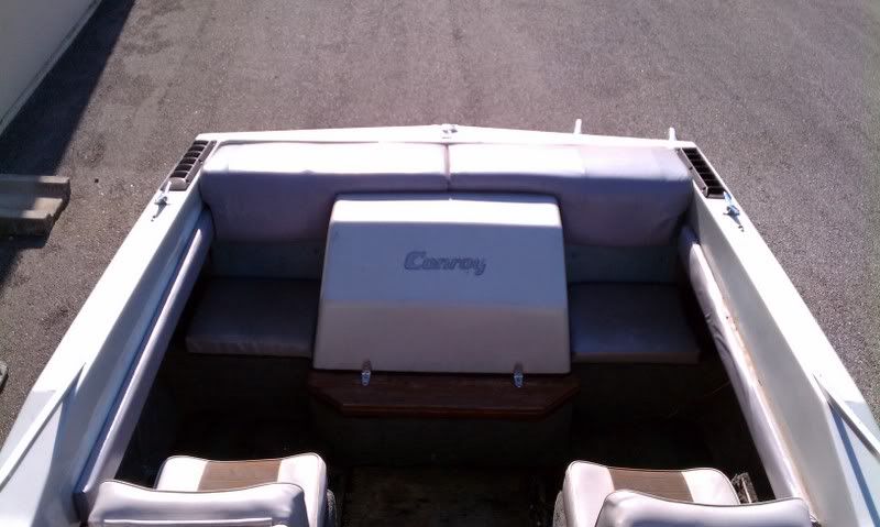

As to the potential redesign of the seating: I am considering changing up the aft section of the boat to include a sun deck and also a swim platform across the entire rear of the boat.
Current configuration:
My thought is to build an engine compartment that runs the width of the boat from the rear to just past the engine cowling, at the height of the gunwale. The sundeck would be fiberglass-reinforced ply with a foam and vinyl pad. The back-to-back seats would have to be replaced with two single captain's chairs for clearance. I would install bench seating along the floor across the width of the boat, butted up against the sundeck's base. Hopefully this makes sense.

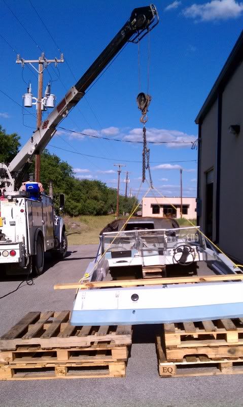

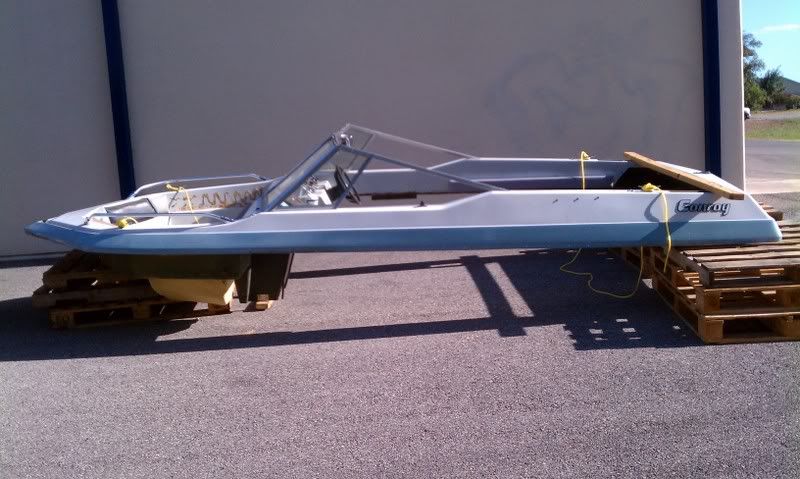

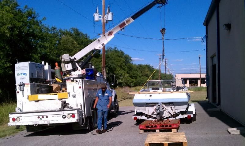

Well, as promised, this rebuild is destined to go rather slowly. Between work, weekend commitments and the Texas heat, I am in no real rush to get this project done. I am just shooting for being ready by March of next year. Here are some shots from the latest progress - I was able to get the cap off in preparation for removal of the engine, drive and stripping down to the hull.
Rigging the cap for removal (Thanks Tommy!):
I don't know what you guys mean when you say this is difficult... :p
Cap on the ground:
Here she sits:

Wow, lucky you, a crane to hoist the cap off....it takes me four guys and a case of beer to get that done on all of mine.
Good looking boat, by the way.
Woodonglass
Dec 29, 2009
25,932
Re: 1983 Glastron X17 restoration
I like your way better. Especially the BEER part!!! But.... If you got a Crane why not use it. You can still have a beer while you watch!!!:p

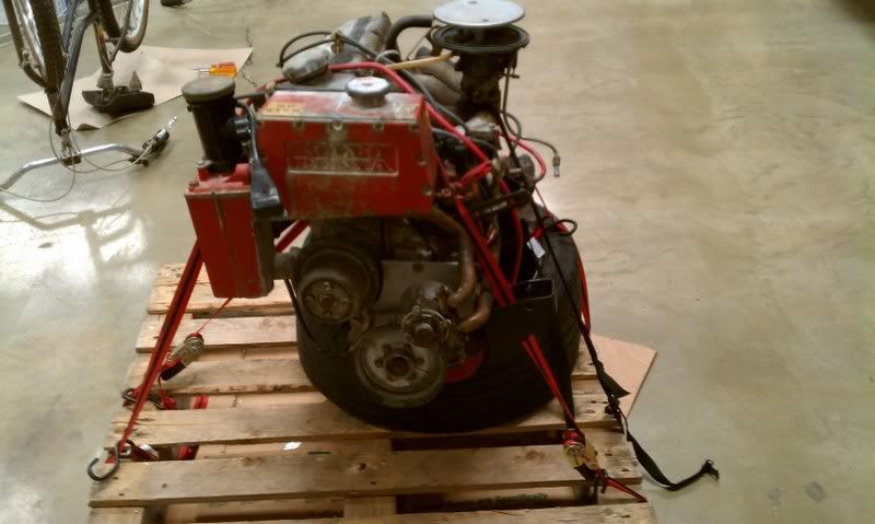

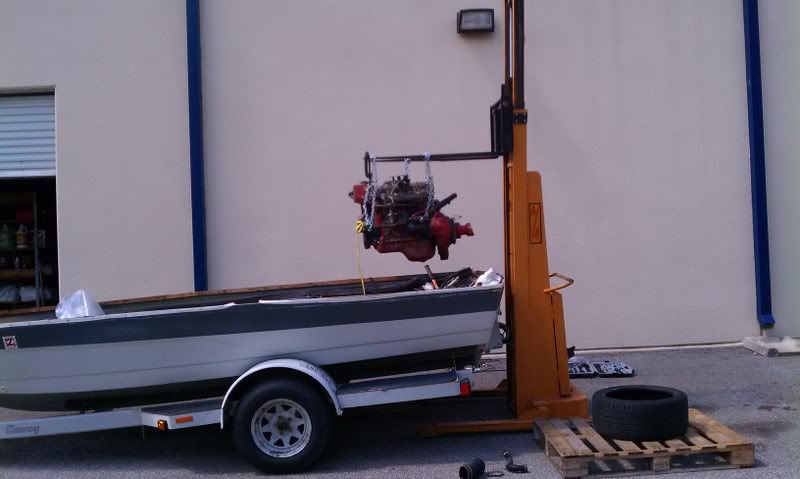

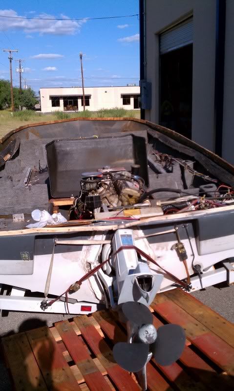

Managed to get a few hours in on the boat this weekend, removed the outdrive and engine. Despite a few hiccups everything went smoothly:
Removal of the outdrive - note the water from the cracked u-joint bellows:
Hmm, not good. I am expecting to have to replace the u-joints and who knows what else when this all goes back together. At least the oil I drained from the leg was clean and looked fresh!
Here's a shot of the pallet lift in place before rigging the chains: (No crane this time)
Motor up, up and away!
Placed the motor assembly on a tire and strapped to a pallet. Looked a little sketchy to me at first, but it's solid.
Now to the fun part - tearing out the old, suiting up and grinding 'glass in the 100F heat!

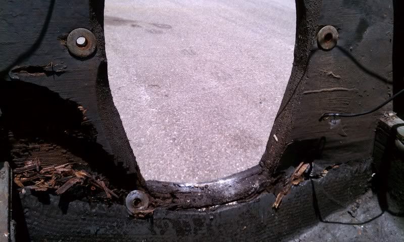

One question: In the picture below, the hole cut into the transom is not what I would call a 'square' cut - it looks like the inner edges of the transom have been routed out somewhat. I am wondering if this if factory and if so what purpose it serves? It seemed to me like everything would fit fine without the added contouring of the transom. Hopefully the picture is clear enough:
Any ideas?

That chamfer on the lower left is for the shift cable, I think there are some other bump outs on the shield also
Ah, thanks! I suppose when I look more carefully at some of my reference pictures it makes more sense to me with your explanation. Will for sure need to make a good model of the transom before removing it to get everything back together right. Lots of measuring to come!

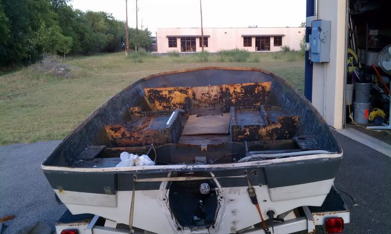

Just a quick update from an hour or so of work this evening. Was able to remove all the remaining electrical and mechanical from the hull, and stripped all the carpet out of the boat. Amazing how dusty/moldy/disgusting that stuff can get! I was also able to get a pretty good look at what I am dealing with in terms of removing the sole.

Slight close up, sure looks all of it's thirty years - soon to be brand new again:

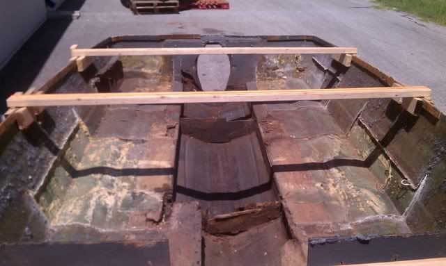

And now a request for some input. I have read in several threads where folks made a cradle for their hull while removing/reinstalling the stringers and sole due to flex. I am considering making a cradle and pulling the hull off the trailer to perform this stage of the rebuild. My other option would be to reinforce the existing support from the bunks on the trailer. For those of you out there who have done it either way, or without any bracing, would you recommend your method? Anybody who regretted their way of handling this task? I plan on taking tons of measurements to ensure the cap will fit back on. I may even replace the stringers and the area of the sole that the cap sits on, then replace the cap and finish the sole install. Thanks for any advice!

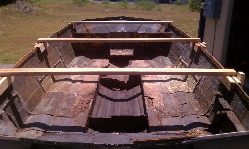

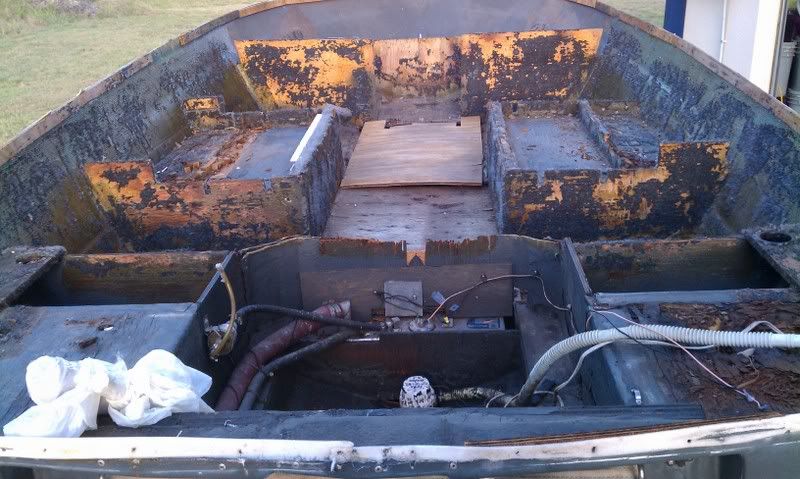

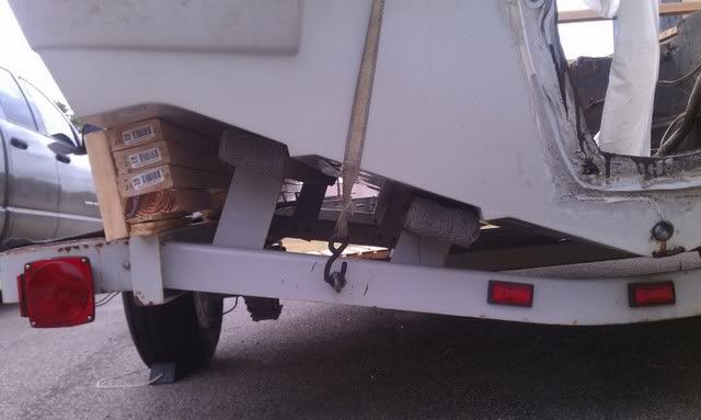

Thanks all for the kind words and advice! This weekend I was able to make a little progress. Got the rear seat boxes/engine bay, back-to-back seat boxes, gas tank and more of the sole removed. Foam was everywhere in the boxes, but it all was dry and came out pretty easily.

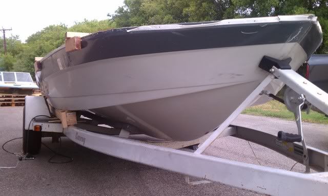

Also put together a brace for the hull - basically I just added some additional bracing between the trailer and the hull, ran some crossmembers and cinched the whole thing down with straps. So far the setup feels pretty solid. I would welcome any comments or suggestions. I guess once the hull is fully gutted we'll see if additional bracing is needed.
Pictures of the bracing setup:
And here's the partially gutted hull:
Still a long ways to go, but it's slowly getting there!
