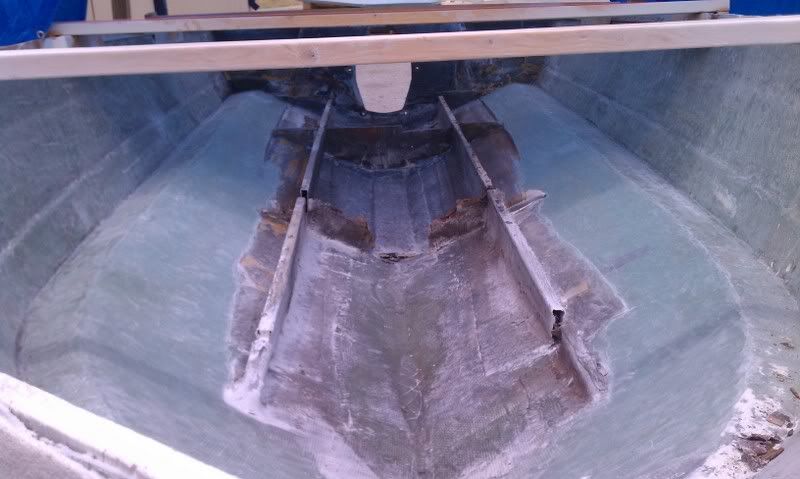

Well, now that the brutal Texas summer heat has broken I can get back to work on the boat. I was able to get the old transom out and got some more grinding done today. I think I am pretty close to the end of the demo stage, getting ready to put everything back together.
Transom gone:
Still a little grinding needed to clean up a few areas, but overall I am pleased with the result. Time to go shopping for some arauco plywood and fiberglass materials!

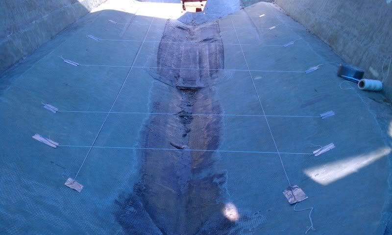

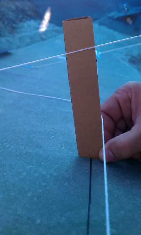

Hope everyone had a happy Thanksgiving! I have been procrastinating on the rebuild, but finally got back into the swing of things - really need to get the boat back together before the colder weather sets in...
I set up a grid pattern using the marks from the old deck (sole) and stringers:
I then cut some cardboard to 1" thick, copied the angle at the hull and marked the height of the stringer at each of my grid lines:
Using these as guides I made some foam mockups of the stringers - now I just need to cut them to the correct height and transfer them to the plywood. Currently I have the new transom and stringers glued up, just waiting on them to dry before I fit them. As has been recommended, I used Aruaco plywood - nice stuff, no voids to speak of. Once I have some real progress I will post some more pictures.

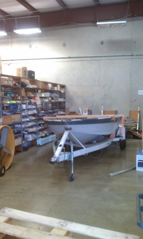

I was able to move the boat indoors, courtesy of my FIL, it will be really nice to be able to work after dark and without worrying about the outside temperature. Here she sits:
Looking forward to reviewing all the excellent threads here to refresh my memory going forward!
