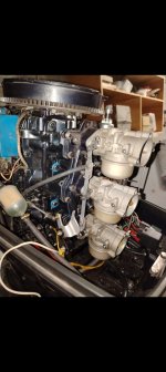

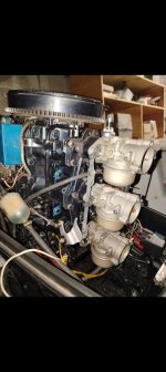

Attached is a few pics of the 125 HP motor I am currently working on and having issues with figuring out where some wires should hook up. I also made a short video and hope it's not too large to post here.
This motor has 2 C-D units, they are from 2 different manufacturers so the wires are not all the same color, unfortunately. Anyway, all the wires except for one on each of the two are all hooked up where they belong as I did not have to detach them during the tear down process. This one wire from each of the C-D units are located in the same spot so I'm almost convinced they serve the same purpose. Please see pics and hopefully short video. For the life of me I cannot figure out where they are supposed to hook up. Both are too short to reach the port side where there are a few empty spots on the terminal block that is on that side. The terminal block that is located right next to the coils and C-D units is all filled up, no empty spaces where these wires might go. The service manual says the white wire is supposed to go to the e terminal block and thee black wire next to it is supposed to go to ground. One of them has the white wire but the other has a black with yellow stripe wire that is located in the same spot as the white wire on the other unit, see the last two pics on the right side below. The video won't upload, unfortunately.
I am lost with regards to these two wires and could really use any help or suggestions anyone may have.

Oh, one other thing I forgot to ask. When the motor overheated and shut down in the middle of Lake Erie there was never any sign that it was overheating, no alarm of any sort. The motor just suddenly started slowing down while on plane, dummy me, at this point I pulled back the throttle and pushed it full forward again and she took off for a few seconds and then shut down completely. I have to believe that there is supposed to be an alarm of sorts for this. If so, what sends the signal to the alarm as I have to believe that it is faulty or the alarm or wiring to the alarm?
Nordin
Jun 12, 2010
2,744
There should be a sensor mounted in the head.
A orange wire goes from the sensor to the terminal strip.
It is a sensor not a sender, it is a bimetal and when to hot it short out to the block (ground).
OEM the sensor is connected to a horn but can be connected to a indicator light.

Here a few other pics from mine, are you planning to replace the flywheel? It might vibrate if broken?

Thank you, Nordin, I appreciate it. I thought that might be what it is. I don't know why my book wouldn't spell that out for me, but it doesn't. I will just replace it and follow the corresponding orange wire from the boat wire harness. I'm assuming the alarm or light can be tested with a jumper wire from the battery.
