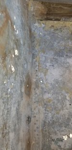

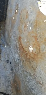

SHSU...the boat was a charter out of Puerto Lobos, MX 25 ft center console with TWIN 250 Mercs...1st day was pretty windy with 3-5 ft swells, but Sunday we nailed them...had a blast...The 220V is a winter project. Going to start with the splashwell removal and transom replacement. WHile im there, Ill check the status of the floor from underneath the deck near the bilge. With a covered deck (thick pain, carpet, vinyl, etc) what s the best way to locate the rivet path to get then drilled out...any diagrams or landmarks?
No such luck. That would make it to ease. lol
Best bet is to pull up the carpet/vinyl and look for the rivet heads. You should see them along the edges and where it follows the stringers.

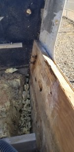

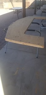

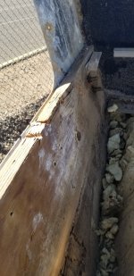

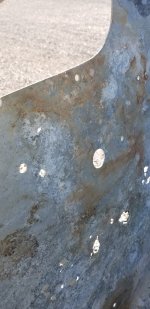

Trying to group the rebuild pics in one area...bear with me...got the transom out..new one is cut..glue and screw and seal this week...floor removal starts tomorrow..prior owner covered rotten floor with 3/8 ply and white roof coating...more to come...I'll try to locate and delete earlier posts..so everything is in one spot...

Old transom out..new one glued and screwed ..finesse and sealing over next couple of days...pulling up some more of the "overlay" and original floor tomorrow

Transom corrosion, a common theme on these old hulls.

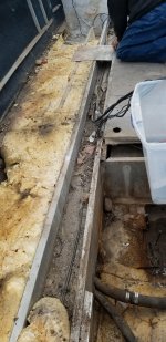

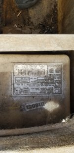

Got the top layer and the bottom layer of decking off..working on the foam...ugh!!..Bonus find..prior owner installed a poly 52 gallon fuel tank and found a 10amp on board charger under the starboard gunwale...
