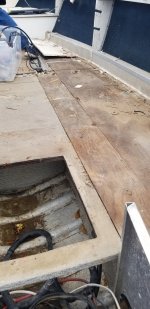

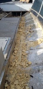

Best method of removing foam...just sawzall into sections and keep breaking it off in chunks..tried the short,square shovel..not much hell?? Pressure wash after...any ever used "Zep-A-Lume" for cleaning the corrosion off in prep for repair and sealing?

Just looked up the MSDS on Zep a lume...pretty nasty stuff..like complete bunny suit nasty...Next idea...

Sadly think you had the right idea with the shovel. I have seen people use cheap roto tillers, but that was on a large ship and had literal rooms filled with foam.

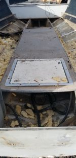

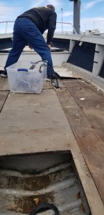

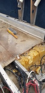

Got the majority of the foam out...NINE 55gal trash bags..phew! Now hands and knees for the other bits...then pressure washer..will pressure washer get the remainder? Or is it wire wheel and scraping?

The foam removal and the paint stripping are the two tasks I am not looking forward to on my MR180. My other two Starcrafts both had the foam sheets, not the pour in, so removal was rather easy. And...with the new stripper material available today without all the good stuff, not sure how its going to compare to the old stuff I used before. I still have a small supply remaining, so I'll save that for the trouble spots.

Can't hurt to try with power washer, but would still want to wire wheel back behind the foam. Want to make sure all the corrosion is out and no pitting is hidden under anything.

That pour in foam is the bane of AL boats, not sure why anyone would want to use it. Yeah it does look like a large amount of crud and corrosion is under the foam from the pics.

Know anyone with a media blaster? I had the exterior and some of the interior done that way. I didn't have foam, but the media blaster should make short work of any as well.

Lots of pitting...some holes. After the wire wheel and the vinegar wash...best way to care of the pitting craters?

Maybe not the best in this case, vinegar works great for minor pitting and total AL cleaning to neutralize normal corrosion. You may need to go to something a little stronger in the acid dept. Since I've not used any acid I'll defer to others who have like @classiccat.

Any pictures of the craters? I used Vinegar and Ketchup for minor ones too. I did try some rustoleum rust stop, but don't think it did any better then the vinegar/ketchup.

For me, just use what you have on hand or can easily get. As long as you clean out the pitting and neutralize as best you can, back filling with JB Weld. You should be fine.

I used mechanical (Nyalox cup brush & a dremel to dig) means to remove the visible alumina (Al2O3).
I then surgically attacked each area using the West Systems 860 Aluminum etch kit (MSDS link). Part A is a phosphoric acid for cleaning and Part B is a Chromate conversion step similar to Alodine. I didn't want these strong acids to get in seams &/or under ribs etc which is why I was very surgical with it.
