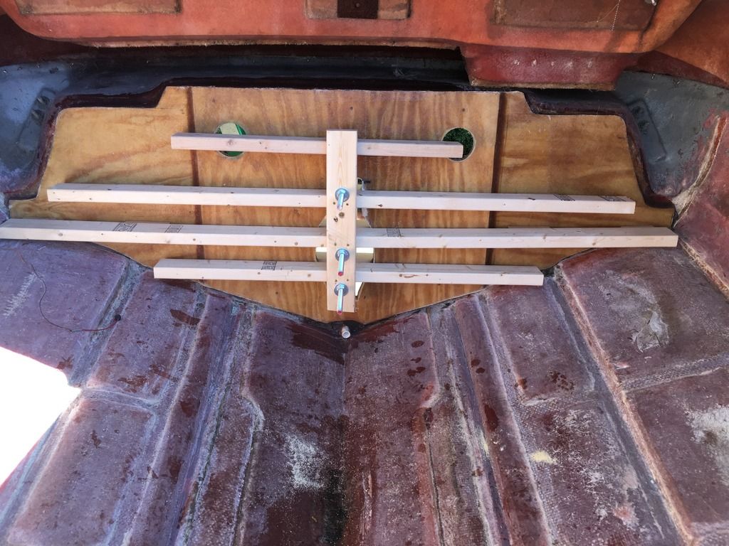

The hinge bolts to the wood under the sun d, and to the rear face of the cap. The sun pad just sits on the frame that's built over the motor. The rear bench actually attaches to the side trim panels once those go back in, you can bolt or screw the bench to the tabs that are at the very rear of the side panels. Neither the pad nor the bench are attached to the frame over the motor. It's only purpose is to support the weight of the pad, and whoever is sitting on it. It's just screws right to the deck. I wish I could fine the pictures I have of these in mine before I started demo. Also if you're interested in selling a template for the transom, it would be very appreciated.
HappyHours, thanks for all the info. I am not interested in selling a template but if you will message me your address i will be glad to make and mail you a paper template.

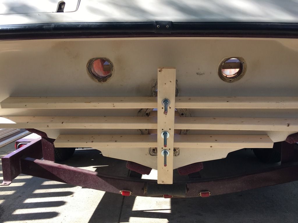

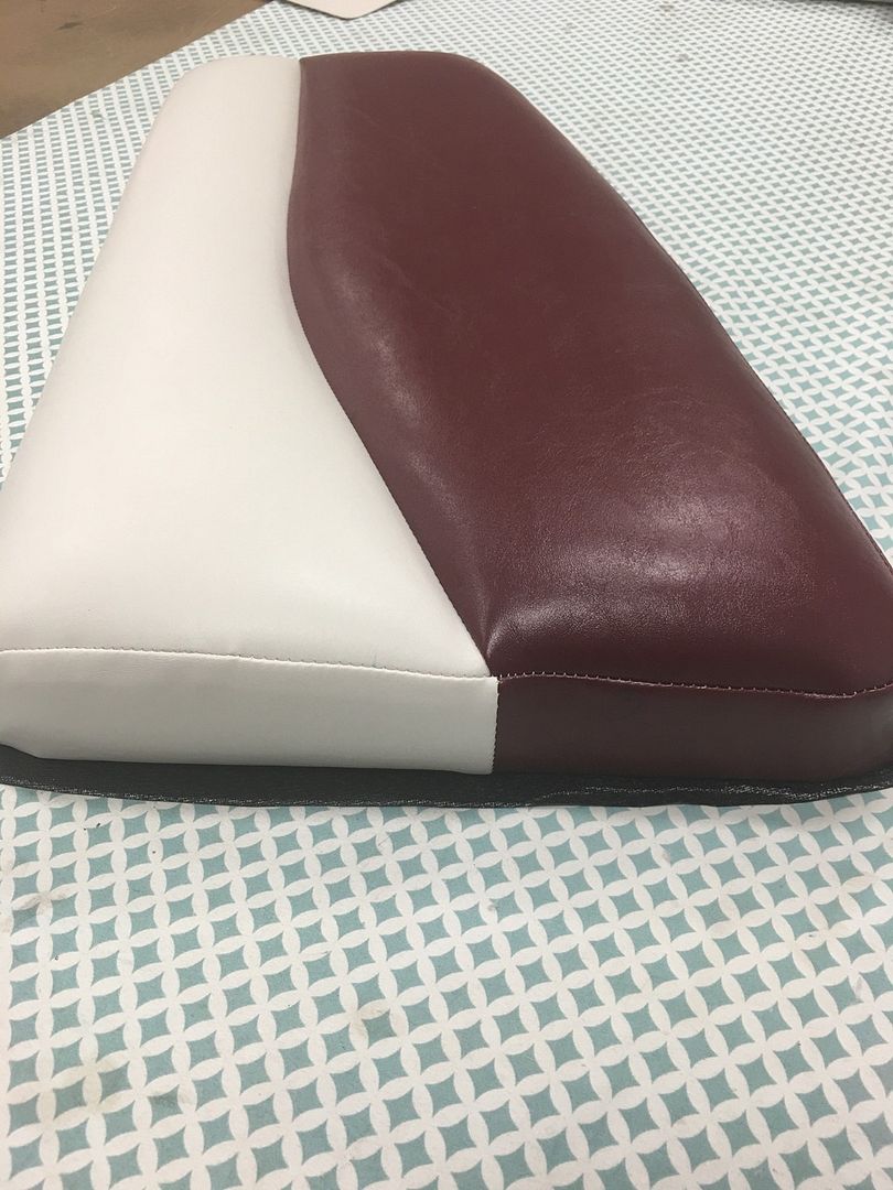

I got the first few layers of csm on the transom and hope to install this week. i also got all of my interior upholstery back today from the shop and it looks great. Now if I just had a finished boat to install it in :0 i will try to add some pics soon.

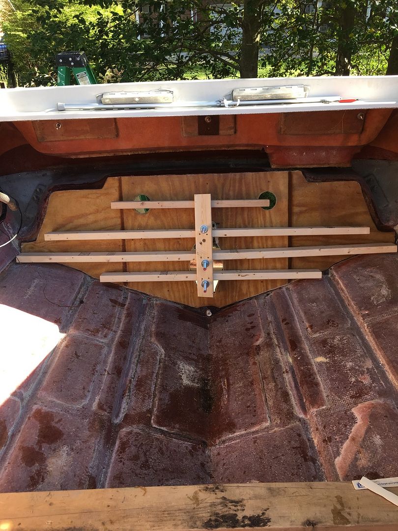

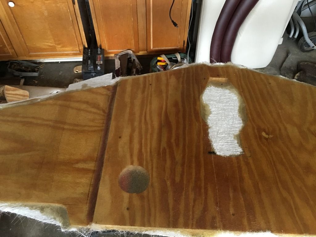

So i am posting some pics of updates. Grinding is complete except maybe for some touch up. Been doing lots of wood work for the interior of the boat and have taken a lot of it to a local upholstery shop that gave me a good price. i am very please so far with the upholstery. got the transom cut, glued together and fillets made. have my glass supplies and hope to get started soon on stringers after i get my transom in place. getting ansy now that the weather is turning. starting to see some progress other than demolition so i am excited.

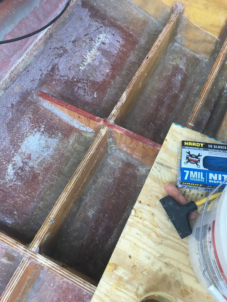

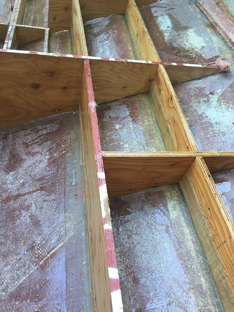

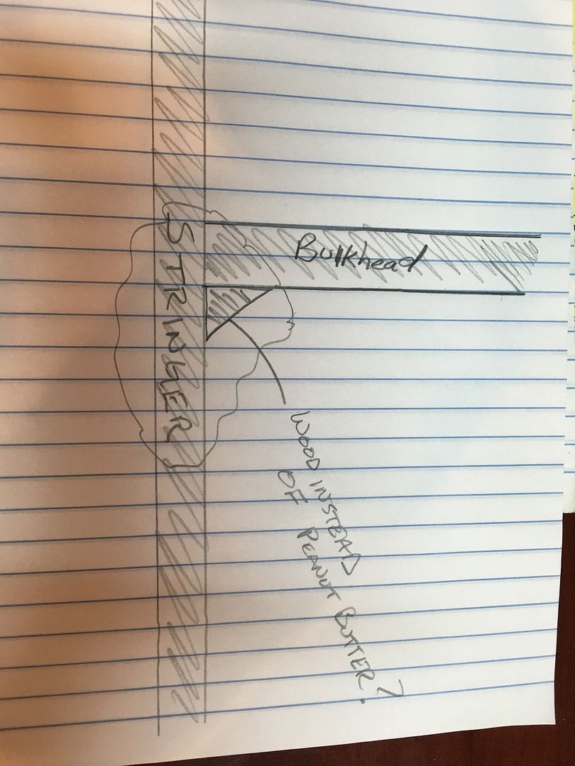

Anyone know if it would be a problem to use wood as my filets where my stringers intersect my bulkheads instead of using peanut butter? Pic below might help explain.

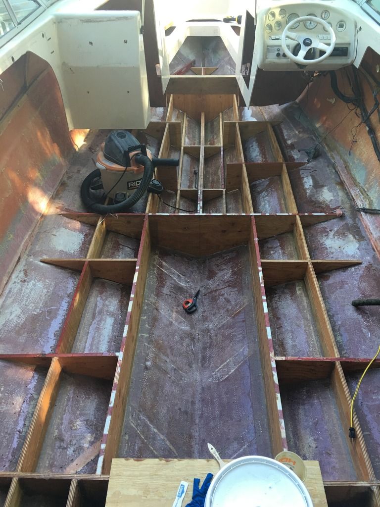

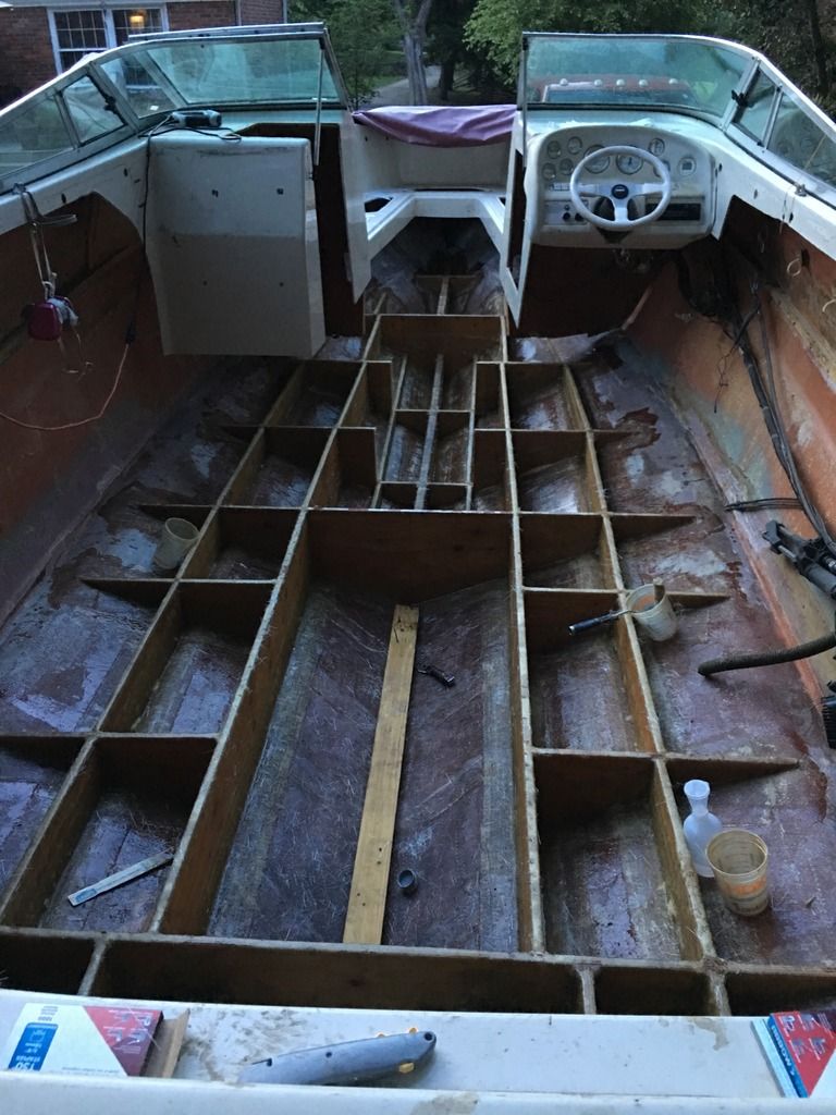

It was a beautiful weekend here in Louisville so Saturday I was able to get some work accomplished. I got my motor mounts installed but not glassed, transom tabbed in, and several of the stringers cut and dry fitted. It is motivating seeing the bones going back in the boat. My goal is to get the rest of the stringers cut this week at night so that maybe I can get them installed this weekend. Slowly but surely she is coming along.
Let me know if anyone has any thoughts on my previous post, hope to be glassing the stringers soon.

Looking really good! It's a lot more satisfying putting it back to together than tearing it apart, isn't it?
Maybe others will more experience will chime in, but re: your question about using wood instead of PB for fillets, the concern I'd have is that PB fillets will really seal in those wood ends from water intrusion while wood fillets (even if covered with layers of glass) won't provide that same amount of protection.
I don't know how important the strength and rigidity of those joints would be, but I'd guess PB would perform better there, too.

PB is cheap.I'd use it for ALL your filleting.:nod:

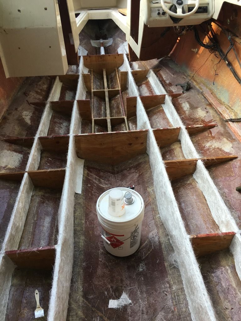

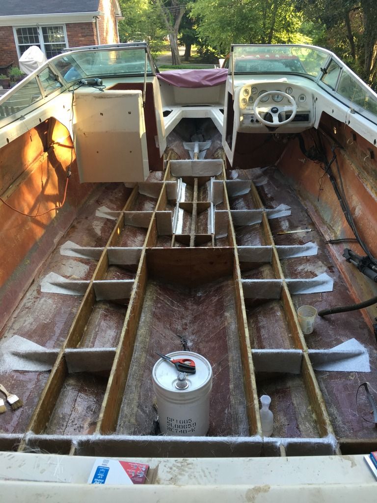

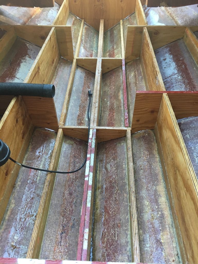

Well it has been a little bit since my last update. Things are moving along at a decent pace I guess. I have all the stringers and bulkheads in place and I have all the stringers tabbed in with at least 1 layer of 1708 biaxial cloth. Tabbing in the bulkheads is my next task and then I will wrap the tops of them all with a layer of 1.5 oz CSM. I am very pleased so far with how the fiberglass is laying up. It has been and will be a lot of late nights after the kids are in bed but I am hoping to get this thing splashed in July. Hope to have all the below deck fiberglass layed up by the end of the upcoming weekend so I can start installing the deck and get the motor test fitted. Will update again as the weekend progress happens.
Also, do you think it is necesarry to foam the small areas that are going to be under the ski locker floor? There wasn't foam in them originally and it is not a big area but it creates more steps if it needs to be done.

Well it has been a pretty productive week. The weather is blazing hot which makes it a lot of fun to work with fiberglass! Well I have officially capped all of the stringers with CSM, all except 1 that is because I ran out of resin😡. I knew this was coming so I ordered another 5 gallons last week and will pick it up tomorrow. I was also able to test for my transom assembly and it fit perfectly 😃. I will be cutting plywood for the deck this week and hope to get it installed also. I really want to get this thing splashed in July so I'm keeping my fingers crossed🚤. Well here are some pics. Doesn't look like much difference from a week ago to most but it is huge for me.
