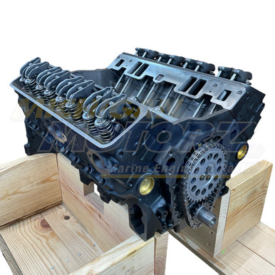

Apparently he hasn't done anything to it. Not even removed the heads , so no head gasket change and it has 100,000 mi on it, sounds like he just took all of the accessories off , added that manifold, cleaned it up and painted it . But is now " going in a different direction " He wants $1,800 . I know he's got a bunch of performance stuff that is of no interest to me , so I think I'm going to pass. I can get a used engine much cheaper than that.
I know either way they're going to be roll of the dice, so I think I'm going to roll them with Rapido full engine Assembly

if you haven’t checked out MichIvan motorz worth a look
nola mike
Apr 22, 2009
6,127
Didn't compare all the specs, but have dealt with MM a few times for tech advice and buying other parts--these guys know their stuff and have great customer service. If everything was close in terms of price, I wouldn't hesitate going with them.

Yep I am already doing everything myself that's why so many newbie questions because I've never had to install an engine that wasn't just drop in ready, but the one that was already in there. So mixing and matching parts is new to me. But I know I can do it I just have to learn a lot from you guys. And you've helped a ton.,
That's why I was leaning towards Rapido because they have a full complete drop-in vortec And the price was about the same as a long block remand , minus the fuel pump, but I can't even get them to answer a phone call and now not even emails so I don't think that's a good sign, what if I have issues. So now I'm back to getting a long block crate motor from a more reputable engine rebuilder And then swapping my parts over. I was talking to s&j engines who appear to have good feedback on all of the forums I went to and they actually contacted me back , last night he seemed really knowledgeable And even gave me some tips that were actually cost effective for me so he wasn't just trying to upsell me.. then I spoke with a local builder who suggested the same, keep the non-vortec block And just upgrade to the four barrel that way I can keep my manifold and mechanical pump and make it easier. While still adding a little bit of power. One thing that struck me odd from him though was he said the vortec manifolds are all produced for two barrels I thought it was the other way around. He was saying My two barrel will bolt right up to a vortec manifold..
