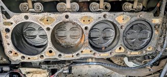

Also. I have a 2BBL carb, will this manifold bolt onto a vortec? And will I have to run a different fuel pump or will the mechanical fuel pump work with it? Or have to contact them?

The 2BBL isn't an issue but the manifold is, the Mans have different bolt patterns
Assuming you have a mechanical fuel pump so you would need to go electric
