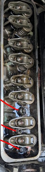

I mean I really don't want to replace the engine by any means, I'd rather not lol But yes I tried to turn it by hand on that 16 mm bolt on the harmonic balancer, it doesn't budge not even a little bit. And from my understanding I shouldn't have to turn it hard enough to the point where it will break, and that's about how hard I'm turning it I'm afraid I'll break it. I did take the drive belt off and check the oil. I have the valve covers off like you suggested, (ignore the whole valve sticking thing I was mistaking they were just opened up because of the position they were in when I turned the key off) I have never torn into an engine before so I didn't know what to be looking for. But other than that , the starboard side I found a couple rockers arms that had rust deposit on it. But both sides look pretty well lubricated and clean but I don't really know what is considered good or clean. So I've just been slowly taking it apart As I check back for any input. It's hot outside so I just work for about 15 or 20 minutes and then come in and do some more research on all of this. Got the riser and spacer and exhaust pipes out going to get the starboard manifold off and then try to see how the starboard side head comes off

Oh and when I crank it with the key and look at the engine with the covers off, I can see all of the valves moving they're not stuck. But it just doesn't move when I crank it by hand. Also the only reason I've been kind of optimistic about it not being internal damage is I find it hard to believe it just subtly had catastrophic failure myself but I just don't see what else it could be if the engine won't turn.

Okay, And these are all the head bolts, I think I counted nine of them?
Also when you say loosen the rockers , I don't remove the bolt completely just loosen them? And when am I marking the push rod, what exactly do you mean by that? Also I was watching one guy take a head off, and it sounded like A bunch of metal stuff fell out when he pulled it out. Is that normal?
Yes, ones under the cover and shorter ones no the outside edge
Loosen the nut just enough to remove the push rod. Take a card board box mark the front of the head and the side working on. Number the rods on the box, push the rods removed partly into the box next to the number they correspond to to where they were removed from the head

Okay thx ! When I get it off I'll send you a picture, if it's catastrophic I guess it won't matter where the rods go I'll be putting a new engine in it lol
