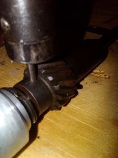

The distributor is ready to go.
The first thing is to slide the oil pump shaft into the gear. It has to be slid in through the top. There is a ring at the top that will not allow it to slide all the way through.
Next the two spacers need slid onto the distributor shaft. The one with the tabs goes on first so that the tabs point up. Then the flat washer.
solar7647
Apr 23, 2009
1,218
Re: 3.7L 180HP rebuild with pics!

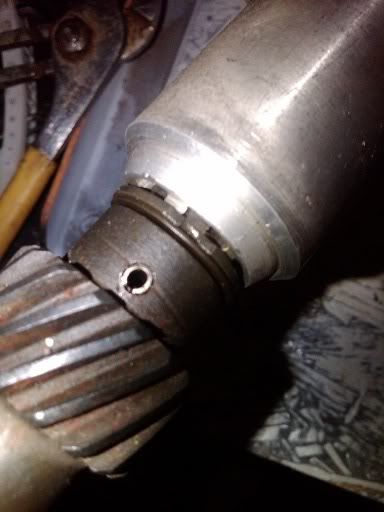

Next is to put the drive gear on to the distributor shaft and line up the hole for the compression spring.
Once the hole is lines up the pin can be pressed in.
last the points and condenser are re installed and the gap for the points set to .5mm
All done and ready to install.
When the distributor in re-installed the alignment of the oil pump will need checked. If the pump is not aligned it will cause binding and break the oil pump drive shaft off the distributor.
