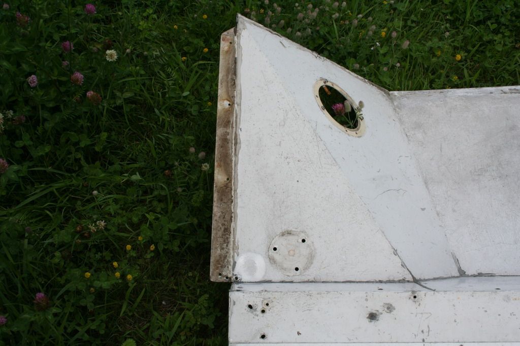

Here is a photo of the removed splashwell... on each edge there is 4 and 5 rivets attaching it to the lower lip of the gunwale

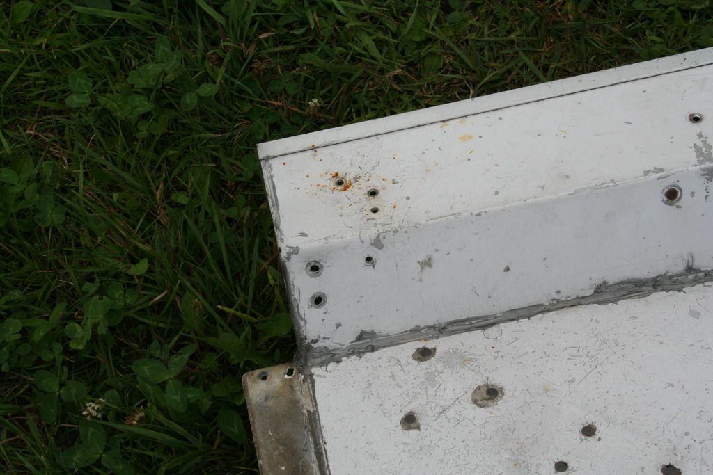

in this photo you can see 15 holes that were attached to either the gunwale or a bracket that was attached to the gunwale

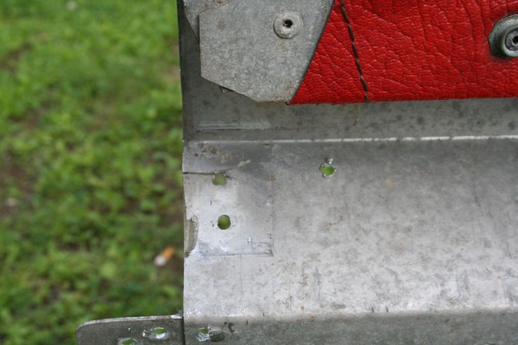

here you can see the ghost of one of the four brackets... I believe not original equiptment

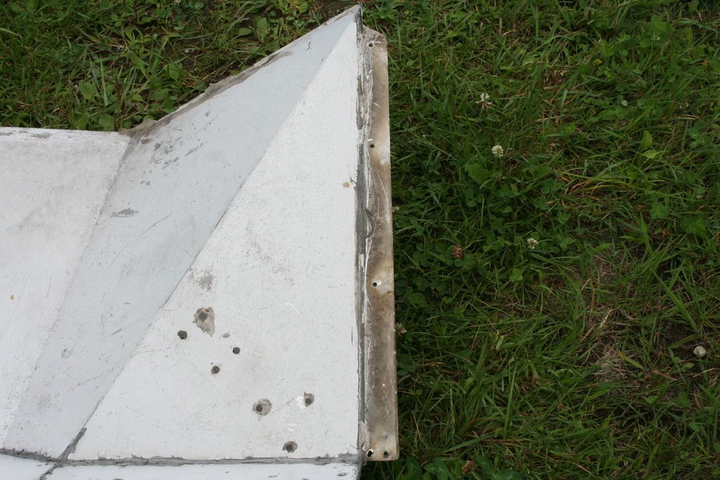

Here is the port side... I did not remove two of the brackets on the port side but was forced to remove all four from the gunwale and splashwell on the starboard side so that the splashwell could be moved forward and dropped down for removal

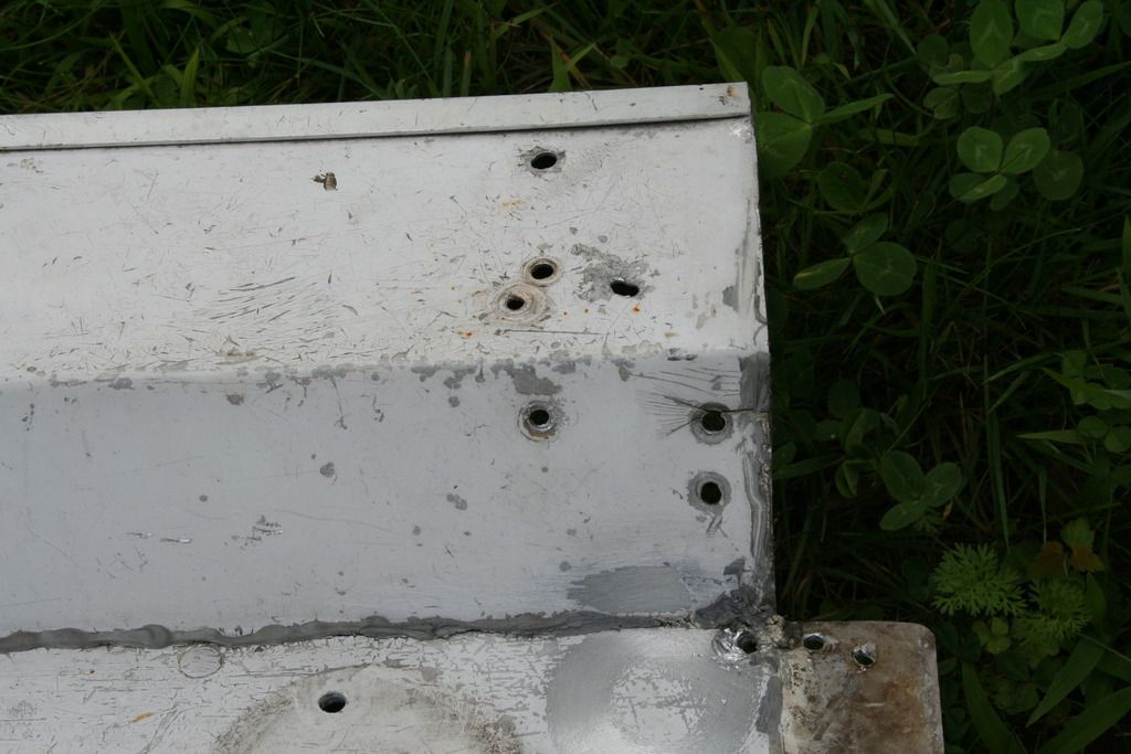

here you can see the underside of the splashwell... note the 4 and 5 holes on the outer sides, this is where the splashwell flange was riveted to the underside of the gunwale... also note that from this view this splashwell looks to be in good repairable shape... as opposed to this topside veiw. the grey that you see here is the liquid steel hidding the cracked aluminum..
