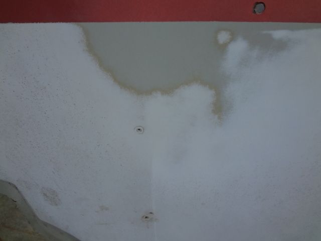

Finished sanding the nib/nubs etc...had a sander in my hand and decided to hit a few spots on the outside of hull...
Several reasons for wanting to do this...
This first spot, notice how much whiter it is in right hand side of the line that went to the speedo pickup? I had thought it was that way because someone had put gelcoat on half the boat after a repair...
I was using a used 80 grit pad on random orbit sander..both sides came off equal and easy...and it is super thin...Guessing it is paint?
This area, was to see what was under the brown...metal flake! and this reddish stripe...what the heck is this?
Tried to sand through it...started showing red under the primer that is under the white...
I have seen other Ebko's with this same stripe...so it was that way from factory...Any ideas on what that stuff is?

That red stuff may be a tint added to the poly resin.I'm just tossing out possibilities here.Never seen anything quite like it.At first I thought is was antifoul paint but no way it's that.

I think that red stripe was laid down in the mold at the factory originally as an integral body stripe in the gelcoat. Or more accurately, after they sprayed the lower hull white gelcoat, they sprayed red gelcoat the red stripe's width higher on the mold. I don't remember, did the PO tell you he was the original owner or how many came before him. In the late 70's metal flake was fairly popular on boats, and VW dune buggy's as I remember.
Perhaps someone paid quite a bit to have the gelcoat shot brown to hide the metal flake, which in the late 80's thru now would date the hull's appearance. Or if it went unsold originally for a season or 2, the dealer or manufacturer may have done it.
The other thought I had RE: the metal flake, was the way the original mold was shot/filled w/ gel & fiberglass. I seem to remember reading somewhere that lots of manufacturers using chopped strand guns to shoot molds often recycled used material & shop floor cleanup debris as fillers & stuff in the gun's hopper. Chopped glass has a shimmer to it anyway, so maybe that too.......

Yep, the red stripe looks like something the factory would have put in the mold first to mark off the water line...mine had something similar, sort of as a pinstripe between colors...

And from the looks of the Brown over the metal-flake, seems more like a paint job from what I can tell due to the primer color under the brown...not sure, but I don't think you would use a primer, if you were re-gel-coating...
