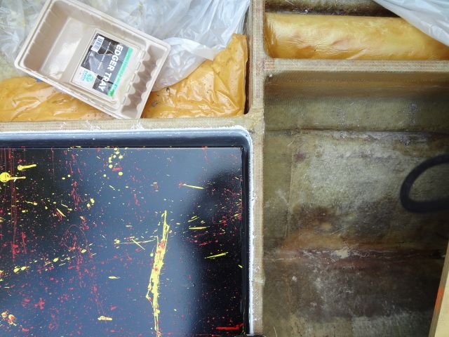

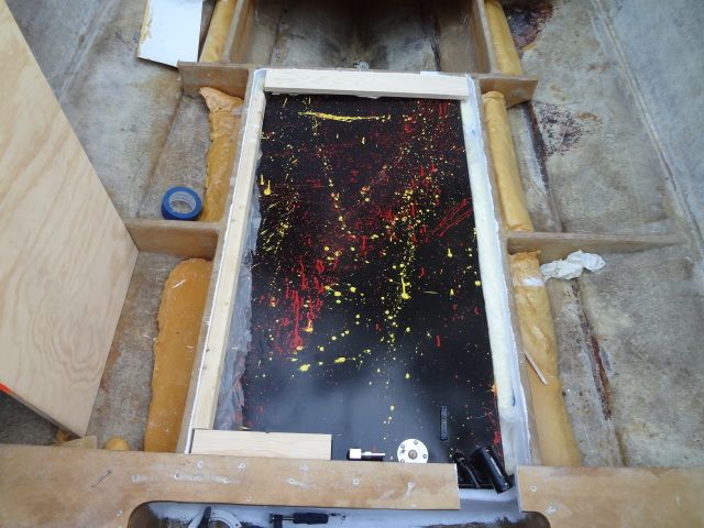

Alright folks...taking into account the help you are all giving..looking for your advice/opnions on what I am thinking of doing here....
The 1x3's are to keep the edges of the deck sections lined up flush with each other...
the 1 1/2 x 1 1/2's I think will hold the tank down...I laid a piece of ply over them and stood on it to simulate screws holding it down...the tank does not lay perfectly flat...so the aft side I might have to shim with some plastic...the rest has good pressure to hold it down...
Here you can see the amount of space I have to fill on the fore end of tank...even less on the stern end...couldn't get a decent pic of it...
Other fore corner of tank...
The two sides...not much room here at all...
Here is what I propose to do...
Lay some plastic 3/4 of the depth of the tank...pour some 2 part foam in there...let it expand against the tank...pull it out...cut the top if it over flows...which it probably will...wrap in plastic..push back into the space...then using the 1.5x1.5's to hold it down... I have drainage in this compartment so should not see any water...foam will be protected with plastic.. I'll coat the wood with some resin/csm...sound like a good plan?

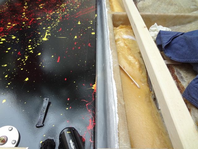

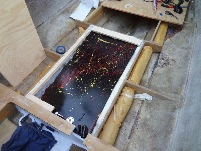

I think this foam together with the 1.5x1.5's is going to hold the tank in place...I can't budge it...

GT1000000
Jul 13, 2011
4,916
OK, here's my engineering side on your tank issues...even though I don't hold any kind of engineering degree [I can spell it though...:p] or even play one on TV...
First off, take into account that you don't want solid hard substance contact between the tank and hull...
So, get some kind of rubber, like I mentioned before... cut some strips to place on the bottom of the tank...check to make sure of your installed height, after that...then use rubber strips everywhere else to fill any gaps between the sides and the deck...don't make it so tight as to make it like a solid mass...
The reason being, when the tank has fuel in it, the fumes will want to expand and contract depending on temperature and how much fuel is in there...
You want a snug fit, but not so tight that the constant expansion and contraction, plus flex in the hull while hauling butt on the waves, could cause a stress fracture...some fuel tanks can change dimensions by as much as 1/2 an inch or more...
The idea of foaming is not bad, but if you don't keep a ton of weight on the tank while pouring the underside of it, the foam could easily raise the tank above your deck height, which would cause you to shave it back down to the correct height...then again, you could screw the tank down, pre-spaced from the bottom, so it doesn't move...
Don't get me wrong, I really don't know what I'm talking about, but I have worked with fuel tanks and expanding foam before, not necessarily together, and know that each of them have their quirks...
If you notice that older cars just had the fuel tank hung underneath the car with a couple of steel straps with some kind of rubber insulation on them and modern cars use fuel tanks that are made of a polyethelene type plastic...this was all done so they can expand and contract...
That is another reason some boat manufacturers foam their tanks in...the foam has a little give to allow the expansion and contraction...others just use either a plastic type tank or the same type of strap set up that they use in cars...
Then again, some are even rigidly mounted, but usually with just a couple of mounting tabs attached to some sort of structure, but the rest of the tank is free all around to expand and contract...
Boy, oh, boy...I hope this long winded babble is of some help, cause by now I am not sure if it is...:facepalm:
I guess that was my 2?, plus or minus a nickle...:rolleyes:
Later,GT
PS- editing for obvious reasons...by the time I got done jibber-jabbing, you had already foamed everything in place...Very nice job...that looks like it will work just fine, just don't put anything too solid between the deck and the top of the tank...

Looks like a good plan. Nice work fabbing some plastic wrapped foam & a tank hold-down system.

GT - I hear all that you are saying and it makes sense..I laid those vinyl pieces under the tanks...to keep it off the gelcoat ...At the time I got it, I was thinking plastic...some link someone shared talking about how to install a tank...Only placing those boards on the sides, the tank center flexes alot...I can walk on it and it goes down, get off and it pops back up..I do not plan on putting foam on the top..though that is how it was originally...I will also not be adding anything to the front/back sides of the tank...that should help some with flex too...
I hope this works..I think it will... we'll see...

Yep, I think you are "golden" with the set up you got going...Looks awesome! and should work out just fine...

I don't know much / anything about tank installation but it looks to me like it's gunna work fine and dandy Troop!
Nice job all around !;)

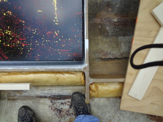

Got three sides done...I forgot to put resin/CSM on the wood....oh well...Should be fine...
