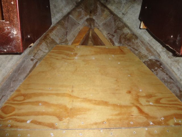

Starting to look like a deck!!!
Got the fuel tank section screwed down...
Ski/Storage Locker too...
Trying to get the last two pieces in before dark...that way I can do the PB fillets in the early morning..then spend the rest of the day pouring in foam....
After that I can let er get wet if the skies decide to rain...whooohooo!
GT1000000
Jul 13, 2011
4,916
Yep, you are officially way ahead of me...I had better get it in gear if I am ever gonna get caught up...:eek:
Looking GRRRRRR-8!!! No doubt about it!

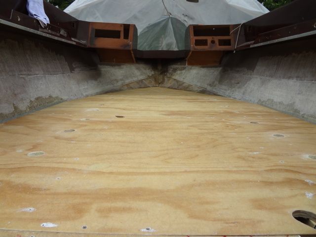

well, it took a little longer than my first prediction...
218 days to be exact...but....
We have a deck!!!
Man I am so happy to have it in there....still has a lot more work to go...but it is flat now...and semi water proof..

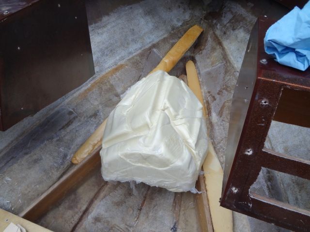

This is the section fore of the ski locker...I was worried about how to get water to drain...had plans for a PVC pipe...but the water drains above had no path to the pipe...and the pipe had no holes :(
so....made a super duper water channel....laid plastic on there over top of the PVC and a couple tube that fit where I needed them to...
I did not think I was going to be able to pull it up though..left the plastic on it for protection...

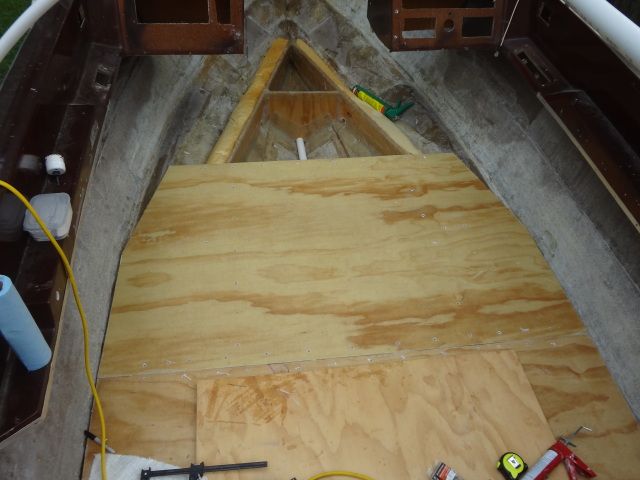

Next to last piece...
Drum roll please......
Last piece!!!! Whoohoo!!
I let the 13 yr old grandson put the last screw down...he stuck with me all day long... was a great help...It was dark...but we got her done...well not done, but down...still got to PB...Tab...foam...then we can lay the top layers of glass and the deck will be finished..I would have got a shot of the entire deck, but it is a little cluttered up...

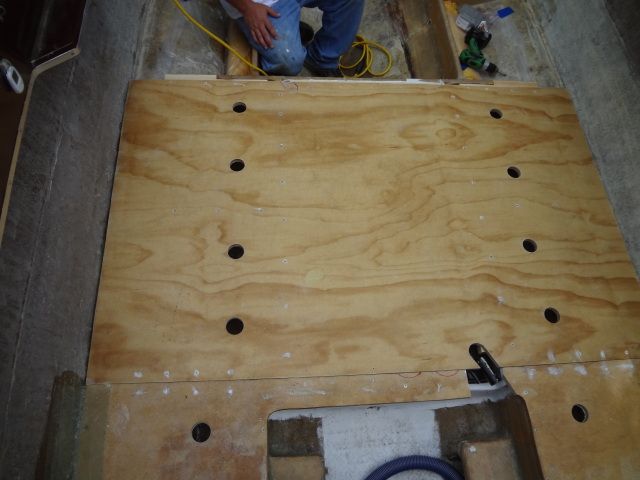

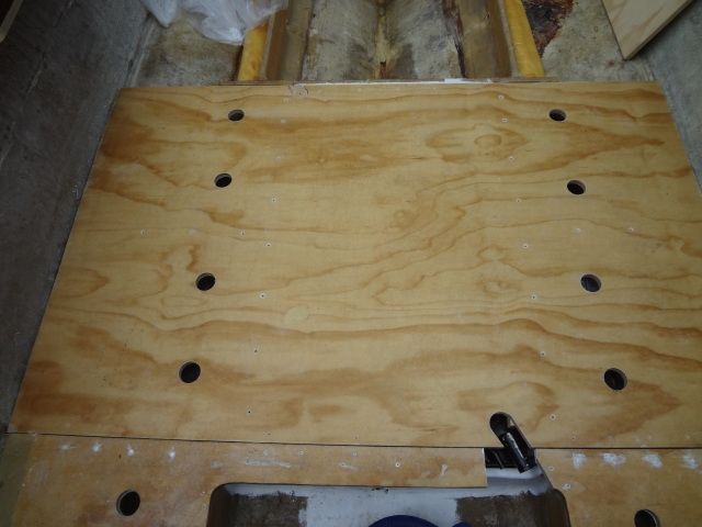

Trooper82
Nov 21, 2011
2,648
Foam is in....used just over half of what I bought..not sure but think it was like 3-4 gals each side...
Getting ready to sand the plugs down..then mix some PB and get them installed...then I am done for the weekend!
Preview...
