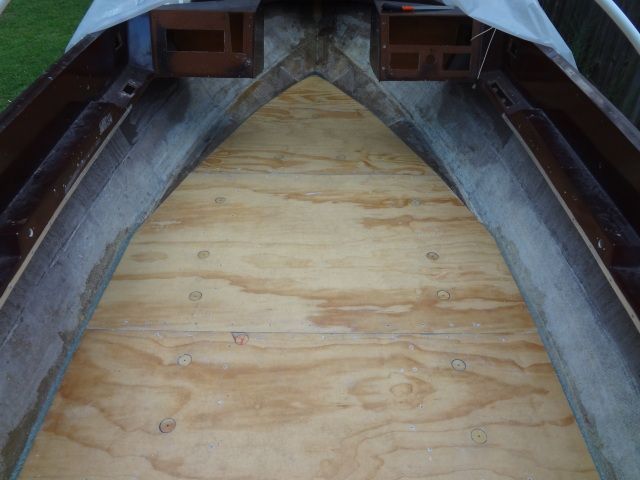

Good evening folks...hope you all had a great Monday...
I found out that there is a tiny problem with having a deck on your boat...especially if you have it outside under a contraption like I put together...
No headroom!! But I can get used to it...

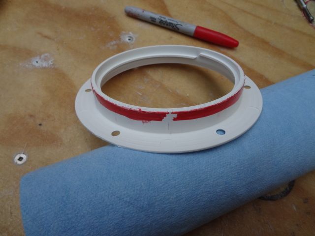

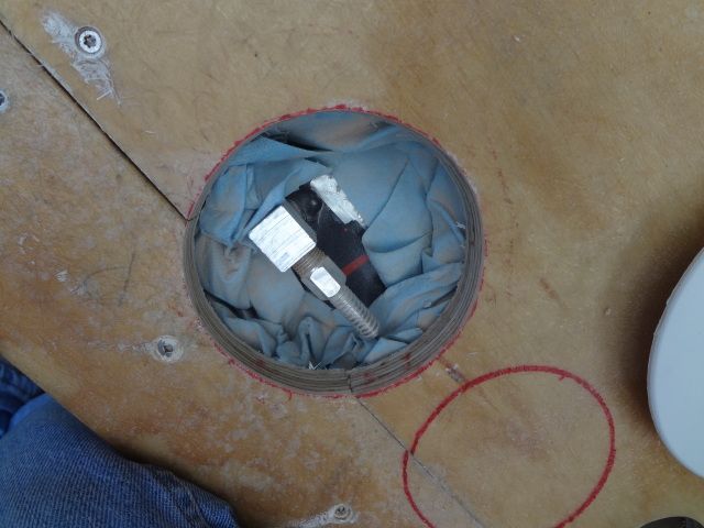

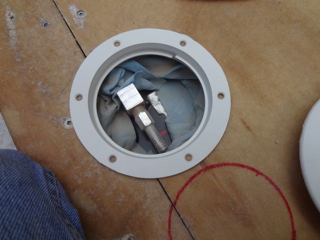

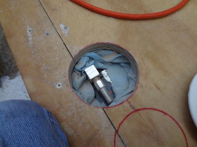

So I started working on the deck access plates this evening...
Took a 1/4" drill and cut the inside edge of my line...then took air grinder to it...
Then a trick I first learned from my grandfather when I was like 5 or 6 I think...I put some ink on the outside edge of my mating part...
Stuck it down in the hole...
Pulled it back out...there are my high spots...
Light grinding on the high spots...and try a test fit again...
to be continued.....
Trooper82
Nov 21, 2011
2,648
Continuation......

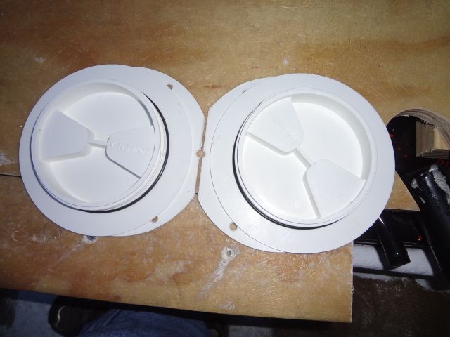

Rinse/repeat...and you get this...I thought I was being real clever...putting these as close as I could...
However...I forgot to account for the lids...bummer!!
Thought it over...figured I could replace these or go with a rectangular plate, if I could find one...

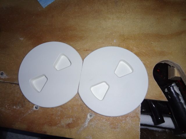

Decided to try jut cutting the lids the same as the bottom part.....and they worked just fine!
You will notice that the lids line up..on purpose...guess if I had put more thought into it, they could be interchangeable too...might take another look tomorrow...these are only sitting in place..can't screw them down and add 5200 until the final layers are put on the deck...
