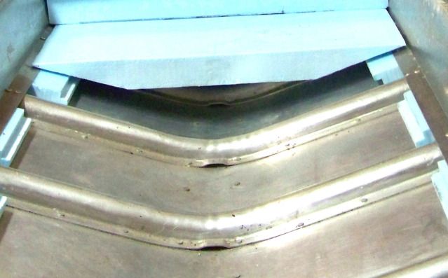

Hi Pete, I've got a '72 Holiday with 1/2" floors that I chose to re-use because they were in such excellent shape. I didn't use pour-in foam and although my floor does have some slight spring, it doesn't feel at all spongey. I used sheet foamboard laid flat as opposed to PMC method of installing it vertically in wafers. One of the deciding factors for me was that I wanted to avoid as many places as possible for water to hide, including crevices between sheets. You also don't want to introduce rattles (plastic bottles) or voids in the flotation (bottles and noodles) or squeaks (from wedging sheets in place). If you put some creative thought into how you can efficiently cut and fit sheet foam, I think you'll get good results without the headaches of pour-in foam. - Grandad

Looks great gdad how much $ did you go for in foam? And jig you see the spaces under the ribs that allow drainage? As long as it stays clean in there it flows nicely.
I see the rib drains in GDs pics, but somehow must've overlooked them in yours.
I wonder how much of that trash has gotten into your ribs through the drain holes and if you're going to be able to get it all out to keep the drains clear for proper drainage?

If you guys are talking about the holes through the ribs along the keel, they're called "limber holes". All boats should have them. Even fibreglass boats should have a glassed in tube or hole to allow water to drain. Larger vessels often have a chain permanently fed through these holes from stem to stern for crew members to periodically drag the chain back and forth to keep the debris clear. Broken bits of foam are likely to clog these holes, so clean your bilge as much as possible before re-installing the floor. I suppose a limber chain could be installed even in a small boat, but it'd have to be something compatible with the aluminum hull to avoid corrosion.
