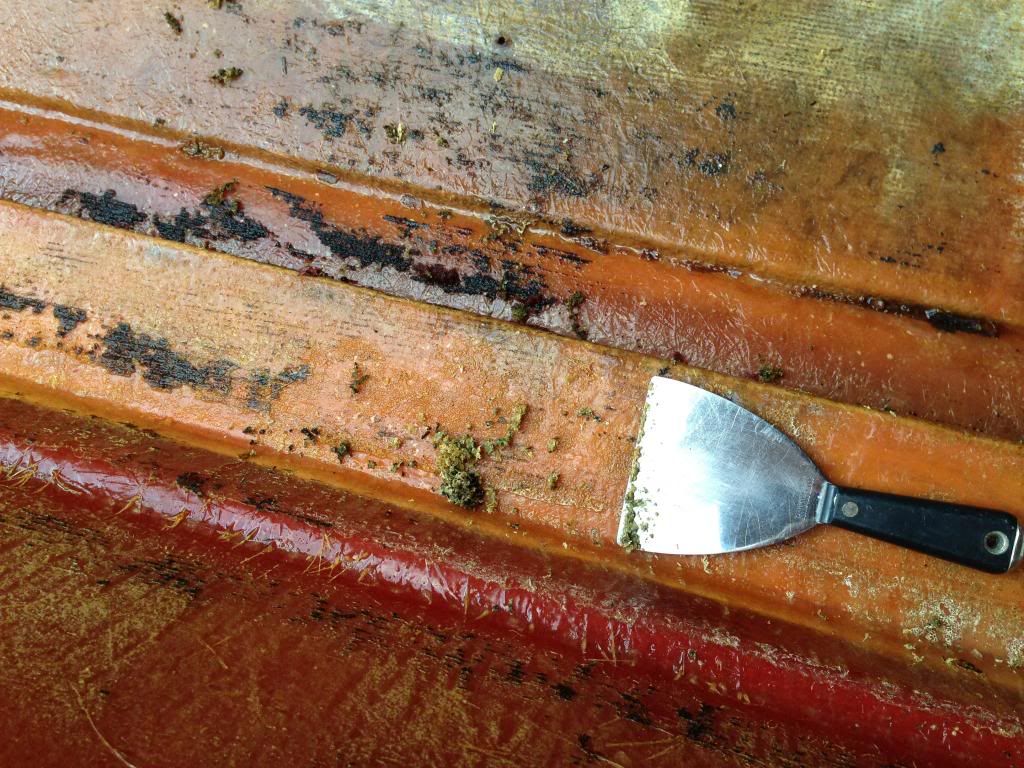

Will the glue that is left on the hull have to be completely scraped off down to the hull? Or can I get the bulk of it along with the carpet fibers left over from tearing out the carpet and call it done and ready for new carpet when that time comes?
Thanks guys.
Started a boat restoration photobucket project on my account. Easier to post many more pictures that way to just reference them here. Large resolution as well.

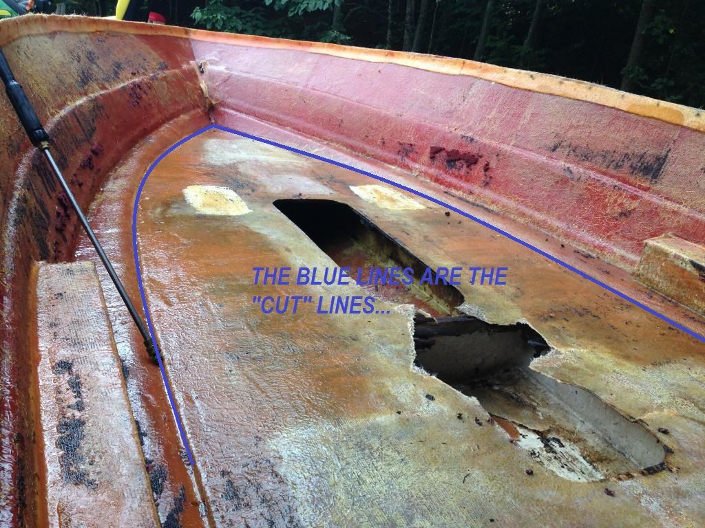

Scott, where is the tabbing that you mentioned? I assume it's the indented "channel" of sorts running along the outside of the deck just shy of the hull? I am about to start cutting out old deck and will just ease my way up to it all calm-like. I'm wondering how the new deck will sit in the bottom of the boat. Does it rest on an edge or just lay on top of the bottom of the boat or am I completely wrong?

Awesome GT. I appreciate the confirmation on the cut lines. Does the deck just drop into that little cleft or is it more complex than that below the deck where it attaches to the hull?

Just runs over & sits on the chine.
I'd probably stay 2" back from the edge and get the bulk of the deck out of the way. Then come back & take that last 2" off....
YOU WILL CUT THRU THE HULL.
We all do :cold:
Admit it's likely to happen, accept that it will, and when it does, move on.
You can fix it later during put back.
But taking the deck up 1st then trimming the last 2" off after, can really help prevent it. And allows you a little extra margin of error for the depth of saw cut. 1/2" deck & some resin & glass is likely near 5/8" thick. Set the circ saw depth for a bit shy of 5/8", cut 2" away from the intended removal line, and you probably won't make more work for yourself. Slow & steady............

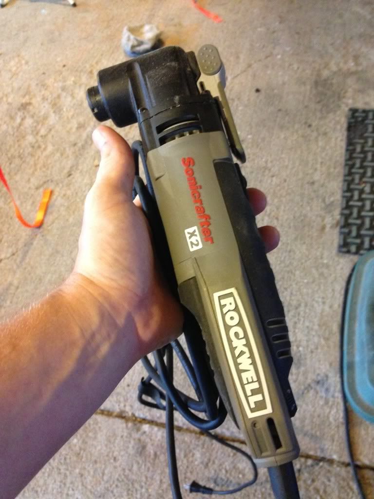

I LOVED the multi-tool for removing that last 2":
89avanti
Nov 25, 2012
137
Re: '89 Bayliner Avanti restoration - where to start?
I had my oscillating tool in my pile o' tools for this project JB ... good call on that one. What blades did you end up using most? When I get the majority of the deck cut out am I supposed to cut down into the edge where the deck is recessed? Will it be obvious that I'm still cutting the deck out? I assume I'll see ply until it's gone and then I'll know where to replace what.

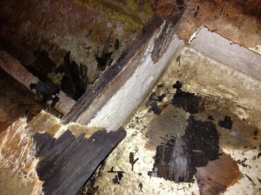

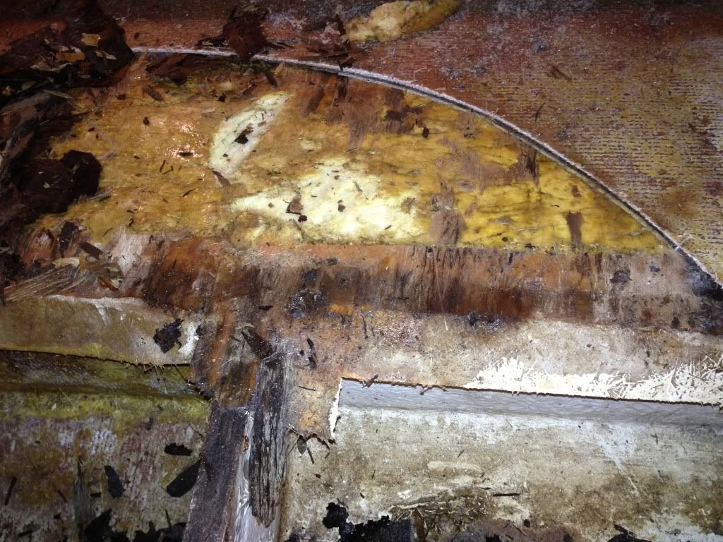

What I found on the first few cuts. I wasn't prepared to see a bunch of foam. Is that normal? Should I leave it? Looks good other than the top layer that was up against the rotten wood.
Tossed a picture of the bulkhead between the cooler and locker. I assume this guy is coming out or can I leave it?
