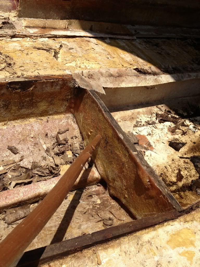

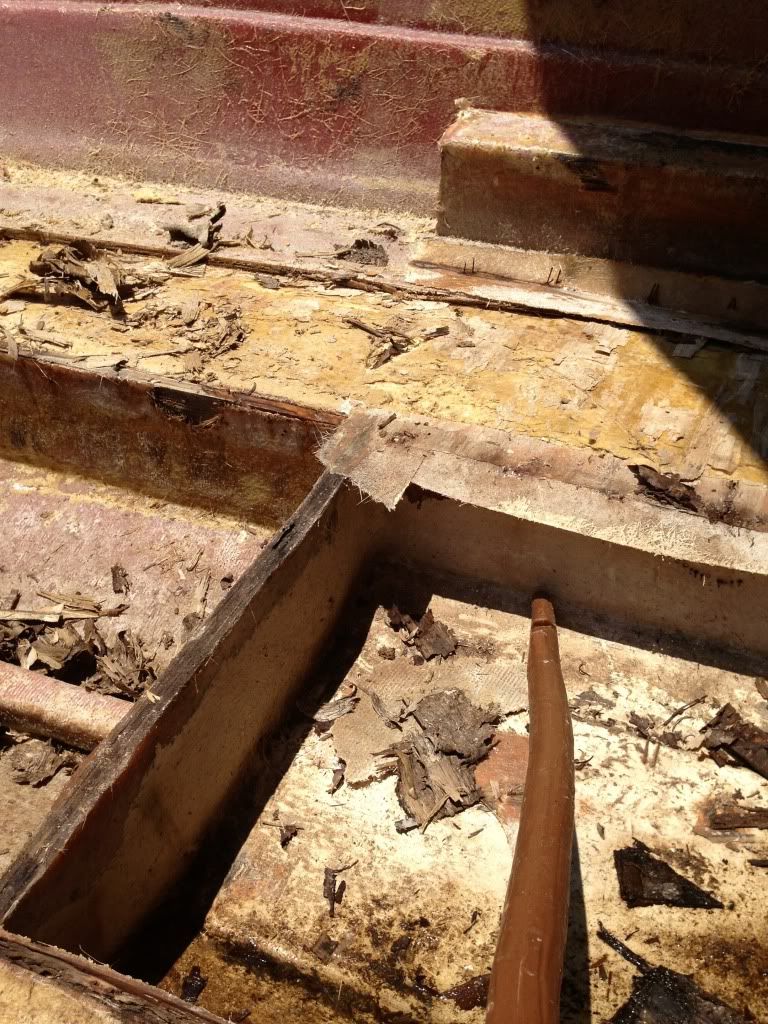

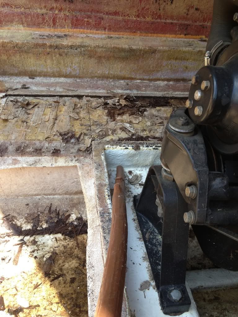

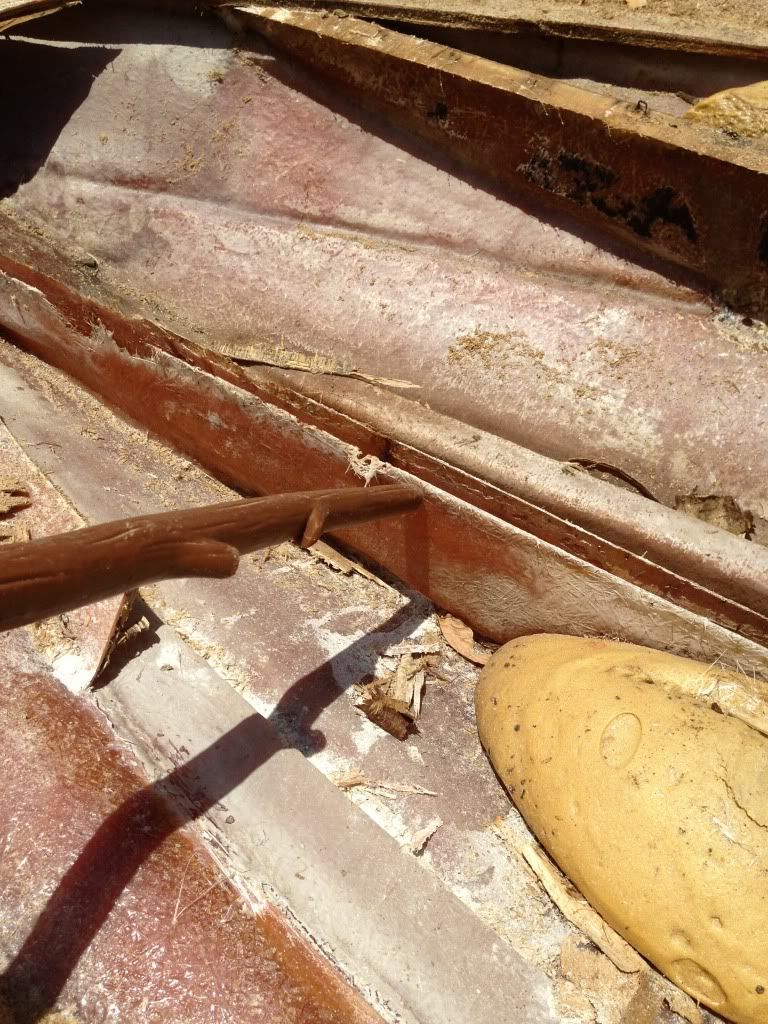

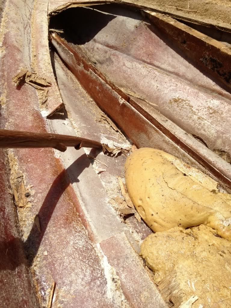

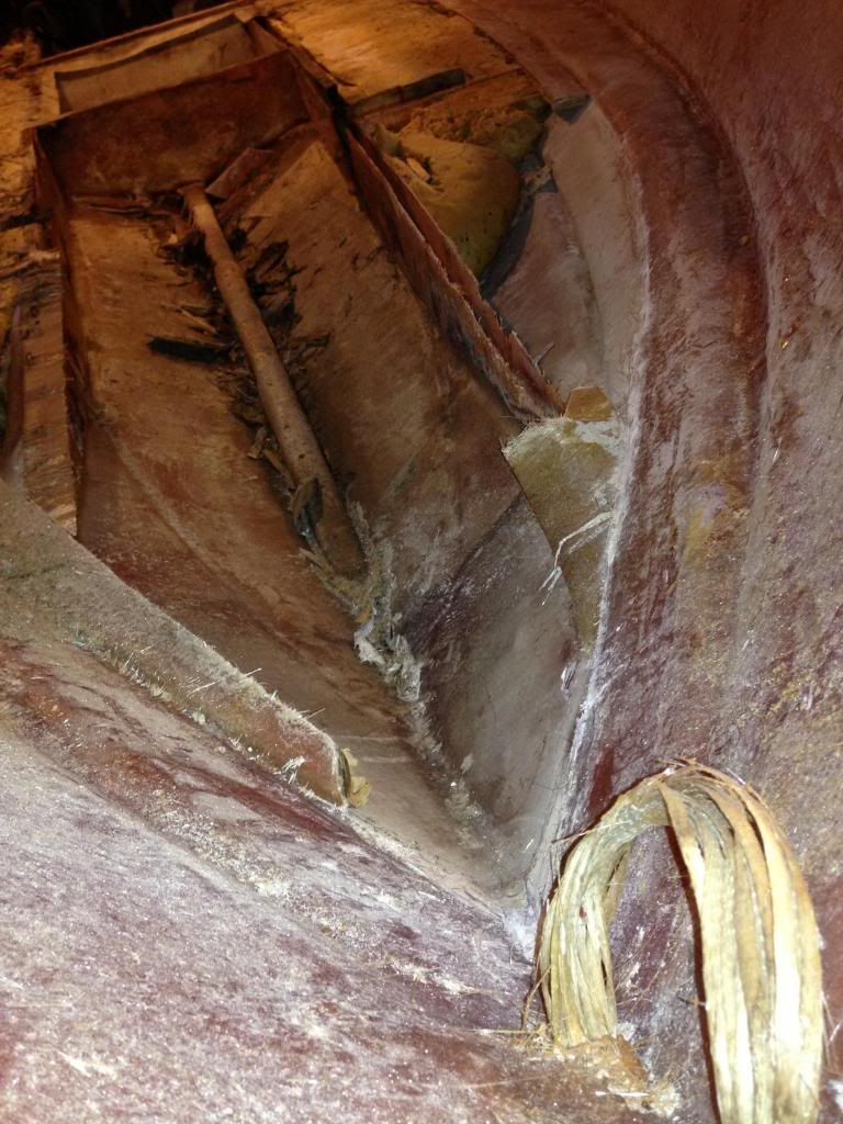

I took a few more pictures of the bulkheads and stringers ... cooler, bilge, etc. I wanted to know if I have to remove what I'm pointing to in all of the pictures. There is a foam picture too and I was curious as to if I needed to fill that in all the way to the tip of the bow.
I inspected the engine blocks and they're fine. The center stringer keeps surprising me. It looks good all the way to the back. The PVC you mentioned that in hind sight you would have used through the mouse holes ... how would you do that? I'm not seeing the benefits of running PVC through those holes... ??

"I inspected the engine blocks and they're fine. The center stringer keeps surprising me. It looks good all the way to the back. The PVC you mentioned that in hind sight you would have used through the mouse holes ... how would you do that? I'm not seeing the benefits of running PVC through those holes... ??"
Here's a great pic of how one of our members (GT1000000) used PVC on his Limber Holes to seal them and prevent contact with water flowing to the bilge. Note how he first layered the wood with resin and then applied the PVC. Very effective!!!

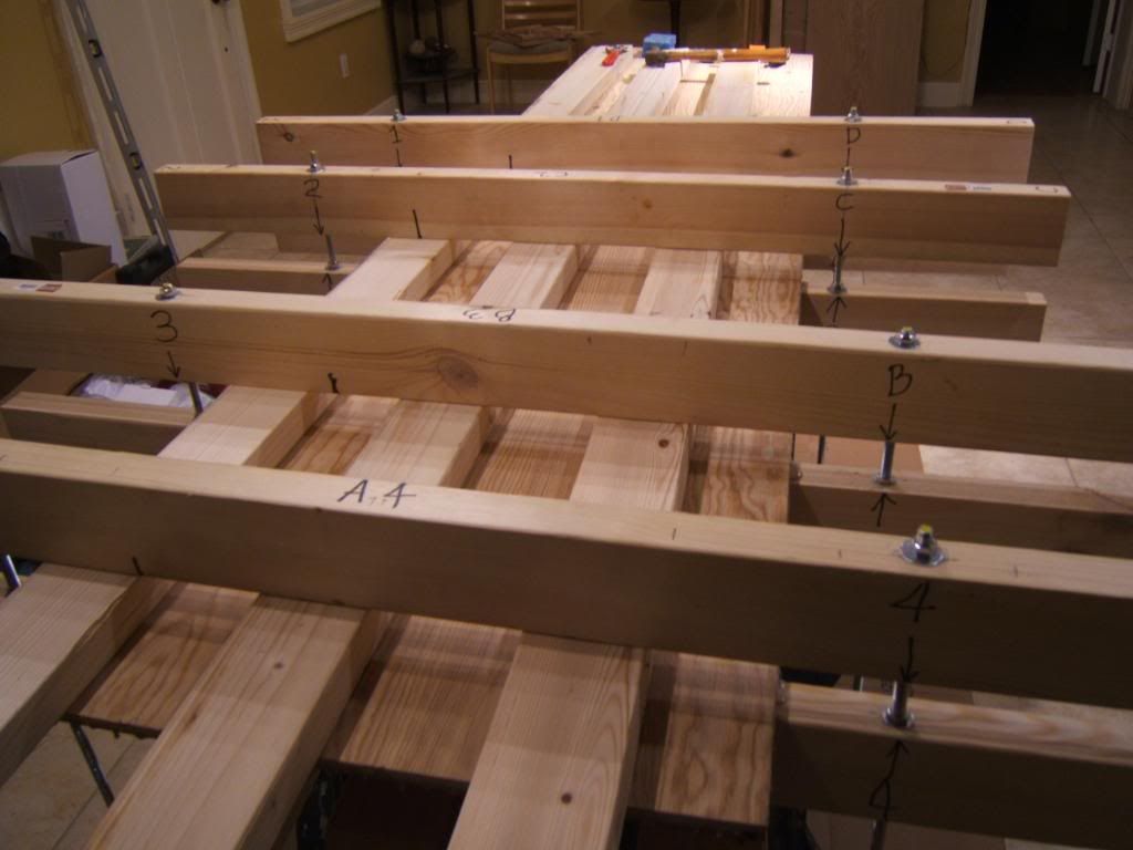

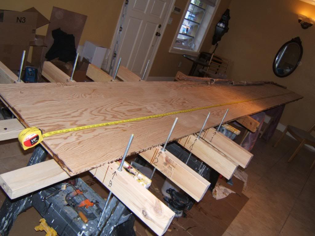

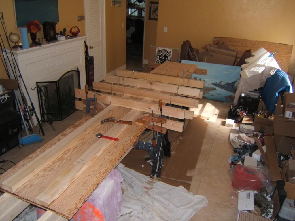

GT1000000 has a great pix of building similar stringers for his rig, in his living room. But pretty good pix & narrative if that ^^^ doesn't get the gears turning.......
His Bassassin thread:
Love, Necessity and Pride
His 2ft tall stringer build (starts @ post 191):
2 foot by 16 Foot Stringer Blank glued, tomorrow AM, weather permitting, cardboard template of knee stringer...
Cut and pre fit knee stringer, then begin laying out the other 6 stringers...
We'll see how far I get by the end of the weekend...
First 2 pcs...
Growing to 8 feet...
12 feet laminated...
the final piece...
2 foot by 16 foot stringer Blank ready for some cutting...:D
TGIF!!!

I would not advise trying to re-use the "Slots" I'd cut em out flush with the hull and grind it smooth and start from scratch. That way you'll be ensured of having a good structural bond to the hull. If SigSaur has dealt with 84 lumber then I would for sure check them out before I went with the blonde wood. I've used it and had "De-Lam" issues with it. Once it's encapsulated in resin and glass just about anything will last with proper care but I'd still go with the best quality I could find for my Dollar's!:D
