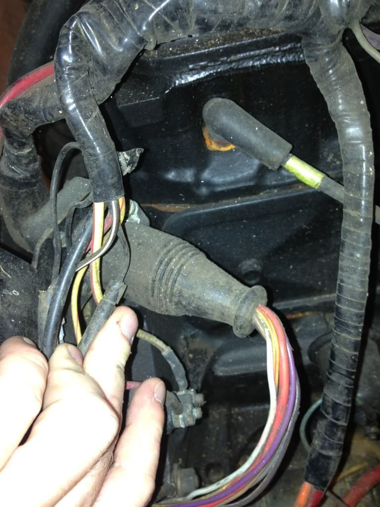

There should be a connector at the engine
Scott right once again. Wiring harness at the engine for the majority of it.

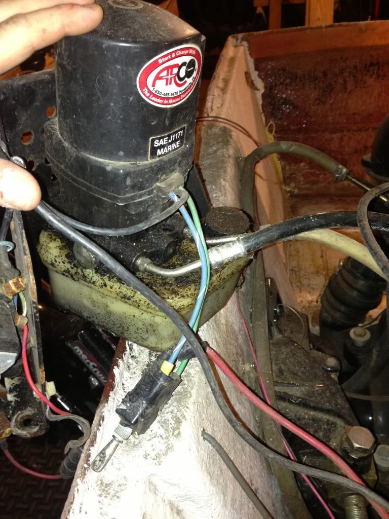

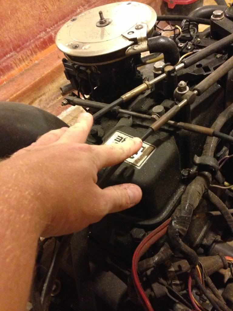

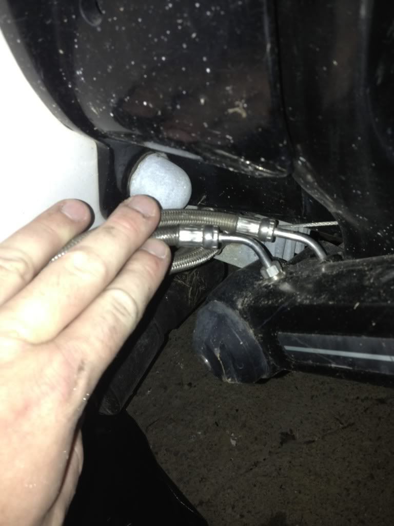

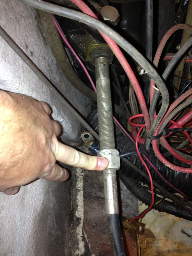

Questions about a few other items attached to the engine.
1. These appear to be the throttle. One goes up to the console and the other is going down to the bottom of the engine.
2. Is this the drive train? Or whatever the boat equivalent is? It's also going up to the console.
3. This appears to be related to the trim. Hydraulics? It's on the bottom of the outdrive.
4. Is this the trim pump for the hydraulics I mentioned in 3? I think the PO did some fancy fix stuff here because there is a switch in-between the solenoids and the pump. Surely he wasn't controlling trim from the back of the boat?!?!

I'm at work but does the post for pulling the Merc show what to do with the drive cable and throttle cables? They're very rigid and I don't want to bend them.
