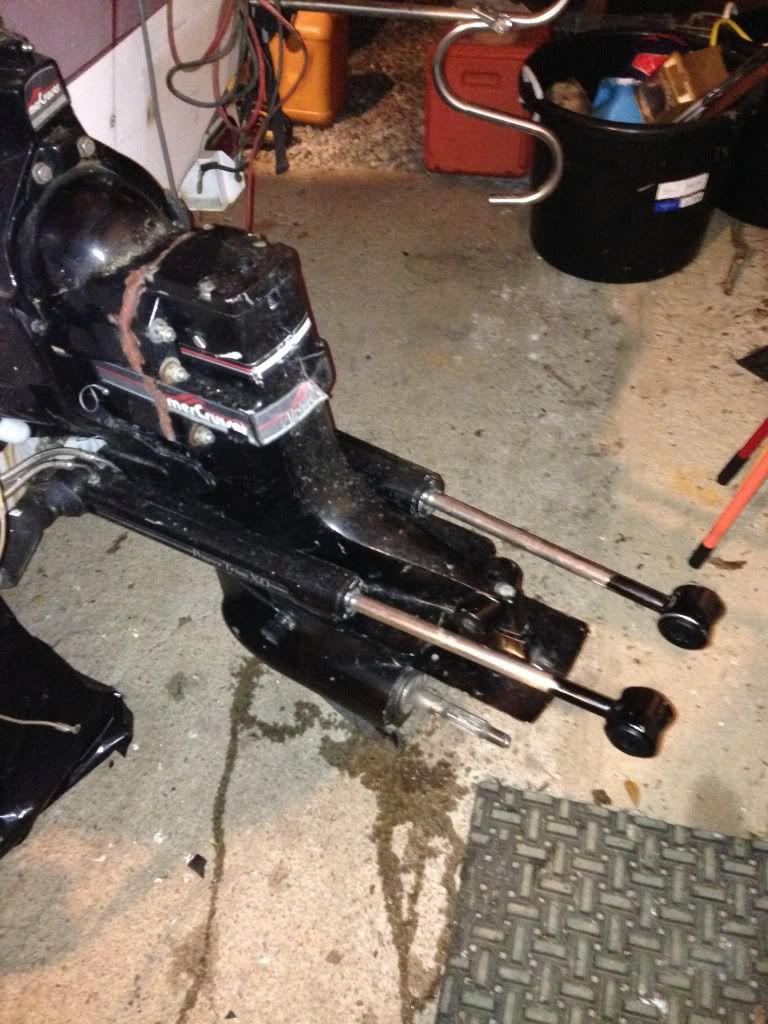

OK. I'm well on my way. Took the propeller off and got the bar and bolts for the trim arms disconnected and lowered. More tomorrow. I have to have the engine out by Monday when I have to return this hoist. It was $45 for the weekend or per day.

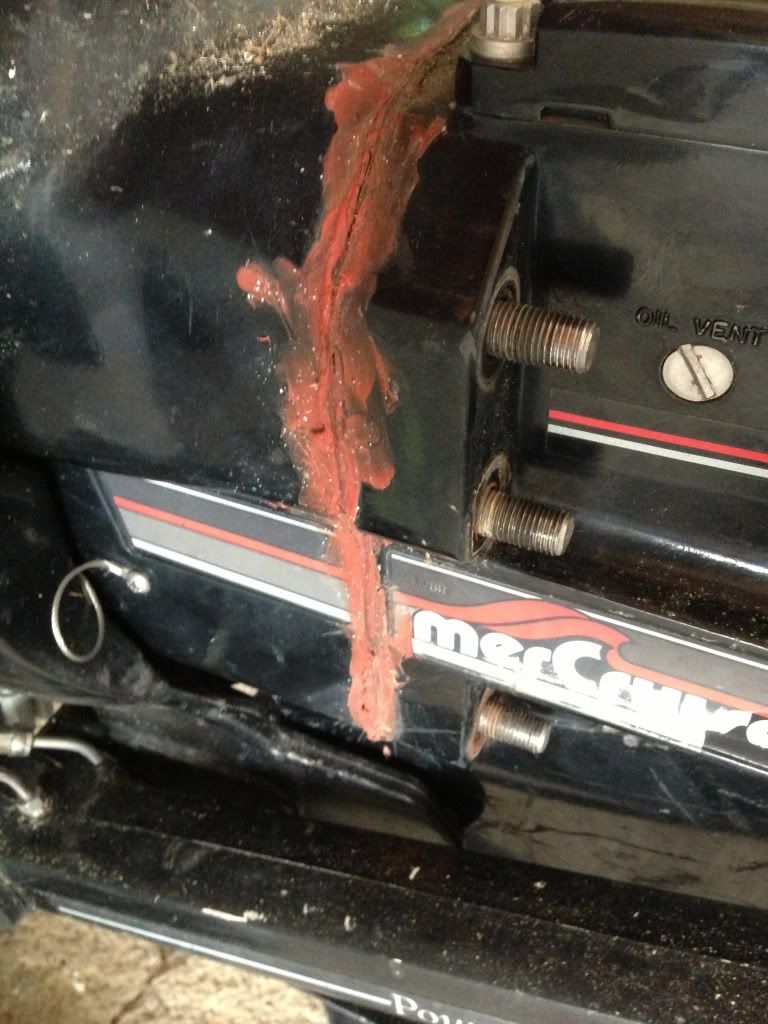

Im learning about self-etching primer for touching up the outdrive. That stuff is amazing what it does to aluminum. I'll need to clean it all off because there is some red gasket stuff seeping over and it just looks terrible. Gotta have side projects.

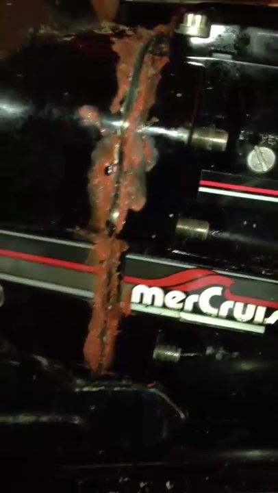

So that terrible red stuff. Yeah, can't get the outdrive off because of it. Suggestions before I start with a razor knife and a chisel?

Is that red silicone?

I bet its red gasketing goo, silicone/etc etc

I don't know guys. It's red gasket something. Definitely not straight silicone. I guess I have no other option than to cut it off. Needless to say I will be cleaning this up nice and tidy like.
On to the razor blades and scraping. Glad I got self-etching primer today.

OK, irregardless whatever it is...
Once you get to the point of trying to wedge something between the two parts to begin separating them, go very slowly and use the thinnest possible putty knife to work in there...do a tiny bit on one side, then move around to another spot, keep moving around until you start to get some separation, the use another putty knife or even some wood/plastic shims to keep the gap you started, open, and keep working around the whole perimeter, inserting wedges, little by little...I don't recommend using heat from a propane torch because you may damage some seals inside, but that may be another option, just use it sparingly...if you get a little separation, spray some penetrating oil into the gap and let it sit over night...another thing you can do is to put the nuts back on the studs until they are even with the ends of the studs, and while doing the prying thing, tap/ bang the nuts evenly all around...time, patience and persistence are your friends...good luck

OMG 2 hours later and I'm still trying to get this red goo off this outdrive!!! UGHHHH

If you are going to repaint, you could probably use a wire wheel on a drill motor to knock a lot of that stuff off...

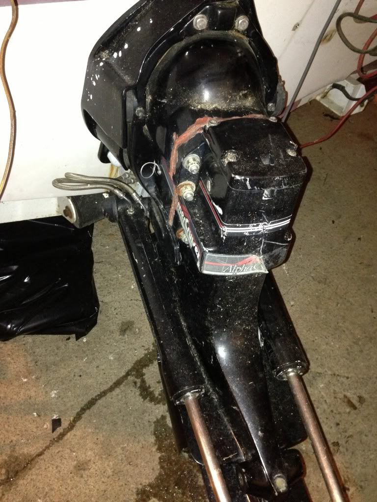

Beauty caps and retaining ring and trim cylinder rod removed.
I've worked on this outdrive for about 3 hours and it's not going past a quarter of an inch. Made a video.
I've triple checked the throttle to make sure it's in forward. I even pulled up some old pictures to make sure I had the orientation of the throttle right so I wasn't mistaken. It's in full forward. I've read a couple of posts explaining how to pry it off but I need clarification.
