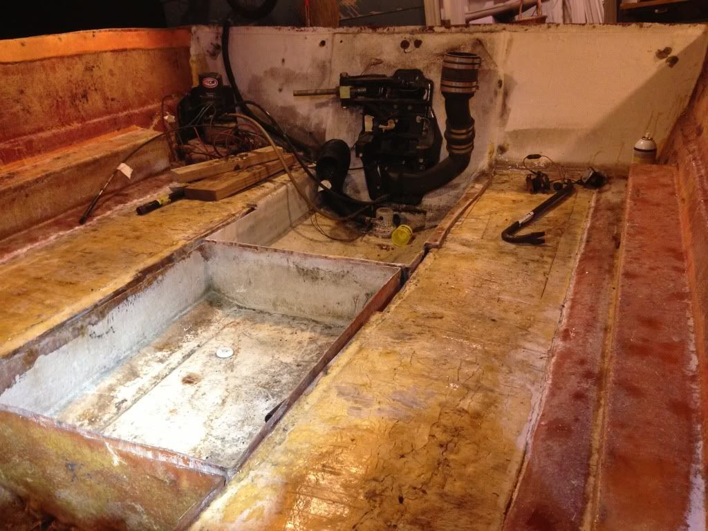

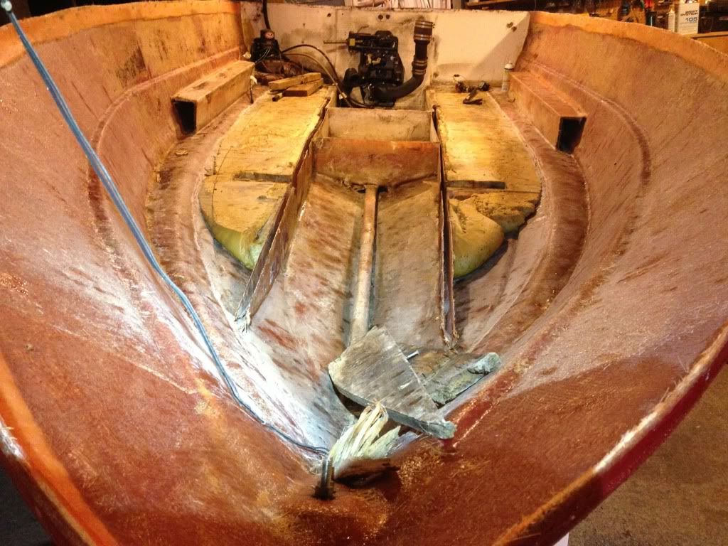

Took a well deserved night off last night. Caught a cold from my wife and kids I believe so letting my body rest with a double dose of NyQuil last night helped tremendously. Slept for 11 hours I think. HAHAHA...
Going to get some fuel and jump into this transom assembly and on to the transom. I am going to deskin it to see how bad the rot is before I start mindlessly cutting it out. Any other "gotchas" I should keep my eyes open for?

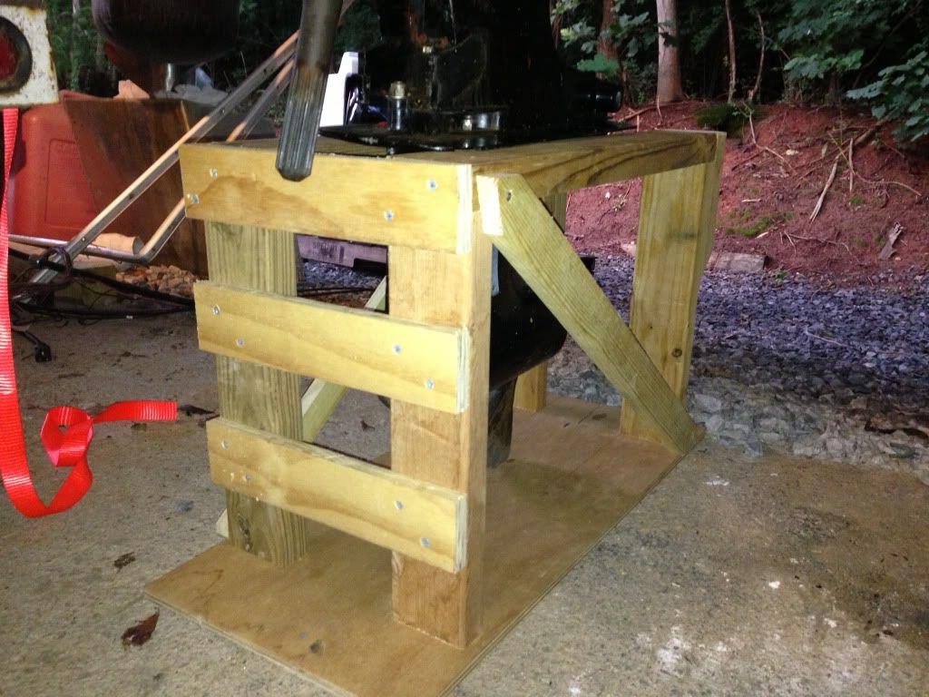

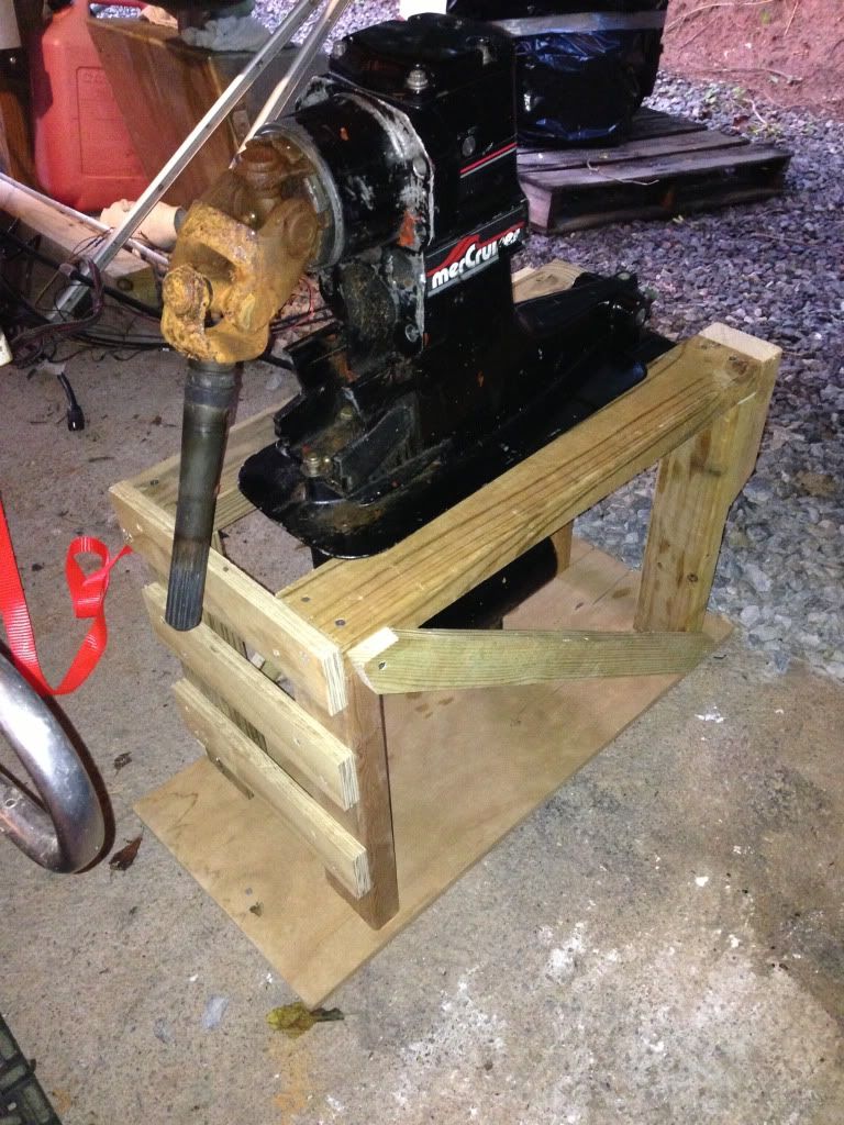

I went ahead and built a outdrive stand this afternoon. Took about an hour ... scouring over pieces of wood and designing something with a twist off what people posted on the forum. Figured since I had some work to do on it I might as well have a stand. Scrap wood to the rescue.

WOOHOO Petty Officer 2nd Class!
