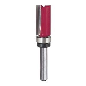

What about using a router with a flush cut bit (with a guide bearing), like this one:
A cutting head length of 1" would be good, using the original transom skin as a template after the plywood is installed. That way you would get a perfect matching profile to that of the keyhole, and it would be cut at exactly 90 degrees. You would have to do two passes, the second pass would use the first passes cut as a guide for the bearing. I saw it done this way in an older thread, looked like it worked really well.

Yep ^^^ that's one way.
-Brandon
That would probably work much better than a Dremel. Personally, I'm not skilled enough with a router to free-hand the keyhole. With my luck, the bit would grab and plough into the hull and the transom core. I'm much more comfortable cutting with a saber saw while the piece is nice and flat on some sawhorses. That way, a screw-up only ruins the board. Mess up the cut badly after the board is installed, and you have a much bigger job... That's just me and what I'm comfortable with, though.
