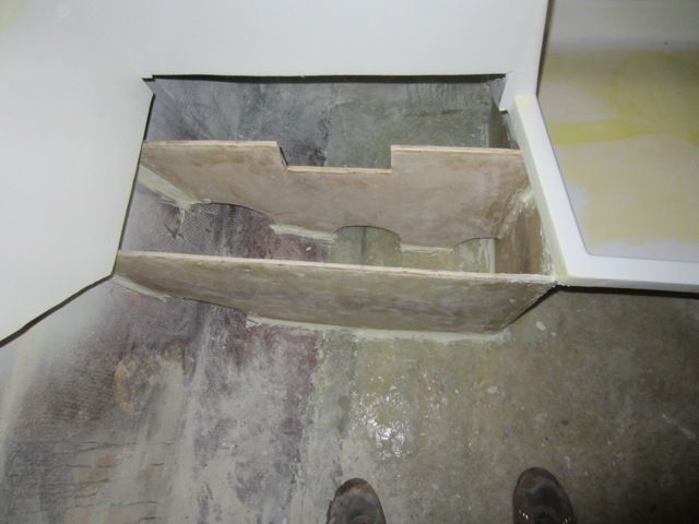

I've also started to rebuild the inside - I have a new design for this which is completely different to the original. I cut the pieces of ply to shape and glassed them with CSM on both sides. In the photos they have been put in place using PB and I will tab them in with CSM in the next few days. Ideally I really need to finish the rear compartments and sand/polish the exterior by the end of next weekend as the boat is then going back on the trailer and booked in with a local boat guy to fit the engine for me while I'm away with work. I don't have any engine knowledge/experience so I have paid him to completely strip and refurb the outboard. Fortunately there were no major issues with it which was a pretty big relief. I'm pretty excited at the prospect of seeing the engine back on there!

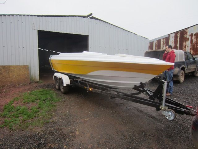

The entire boat has now been wet sanded from 1000 grit, 1200, 1500 to 2000 grit and then given a polish. I'm pretty pleased with the way it looks and was massively happy when I finished the polishing and finally finished the painting stage of this build! I was hoping that the paint runs in the yellow would sand out and leave a smooth finish after polishing. Unfortunately, when I tried to sand the runs down I went through the surrounding paint before the runs so gave up on that idea and just sanded them a bit. So if you examine the paintwork they are quite easy to see in the yellow but I've spent enough time and money on the paintwork for now. I can always come back in the future and re-spray the yellow. I don't think anyone will really notice but it frustrates me that it isn't perfect!
I had a mate helping this weekend so actually have a picture with me in it for once.
Here is the boat being pulled out into the open air with her new paint job and on the refurbished trailer!

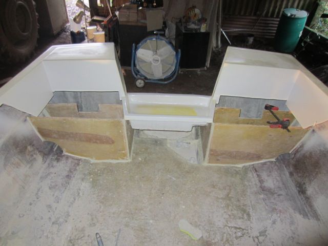

I finished off the rear compartments that the battery etc will fit in this weekend. The holes I left for drainage and wiring (can be seen a few posts back) I lined with drainage pipe cut and twisted to size. I sealed these in place with PB and then both rear compartments got a covering with gelcoat for extra protection and to make them look nice. I also installed a small transom plug in the back of these compartments above the bilge so that if any water does get in there I can just unscrew the plug and let it out. I've put a third transom plug in the bulkhead behind the fuel tank so that I can periodically unscrew this and make sure no water has made it's way into the fuel tank compartment somehow.
I have to go away for work now for 2 weeks so no boat building/updates unfortunately. But the guy who has refurbished the engine for me is going to install it on the transom in this time so the next update will hopefully be a good one!

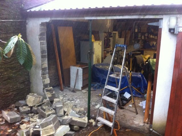

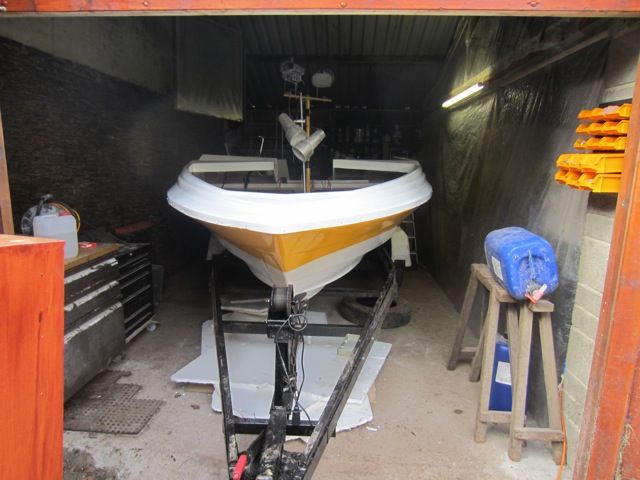

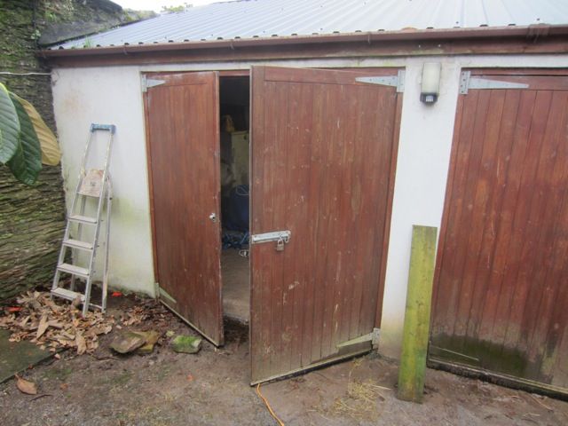

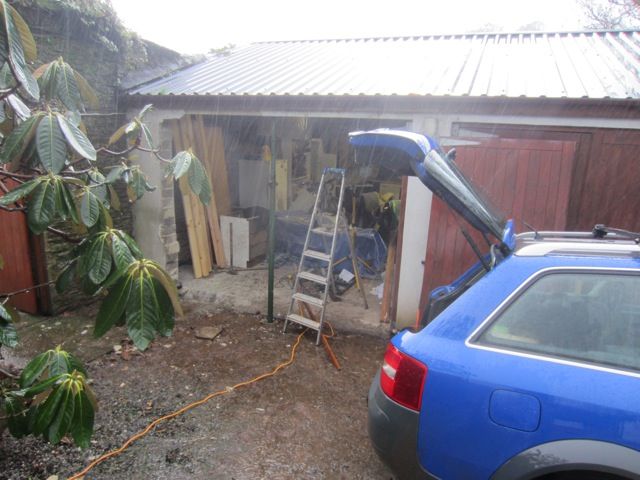

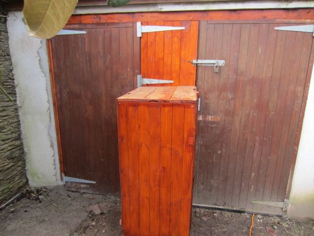

I'm back from work again now...hopefully for a few weeks of boatbuilding! Haven't been able to get much done on the boat recently but I have done some work to the garage at home on weekends when I've been able to get home to widen the doorway. Upshot of this is that I now have the boat undercover at home which is great as I don't have to rely on other people's kindness for space etc anymore (although a number of people have been very generous in allowing me to work on the boat in their sheds). It wasn't a big project but my first shot at building work!
One slight hiccup was that the front of the boat and the trailer sticks out the front of the garage more than I had anticipated now that it has the outboard back on so I had to cut the door I had just built in half and make a box section which latches on to accommodate this!
Anyway, sorry for the non-boat specific related post. Building to start again now...

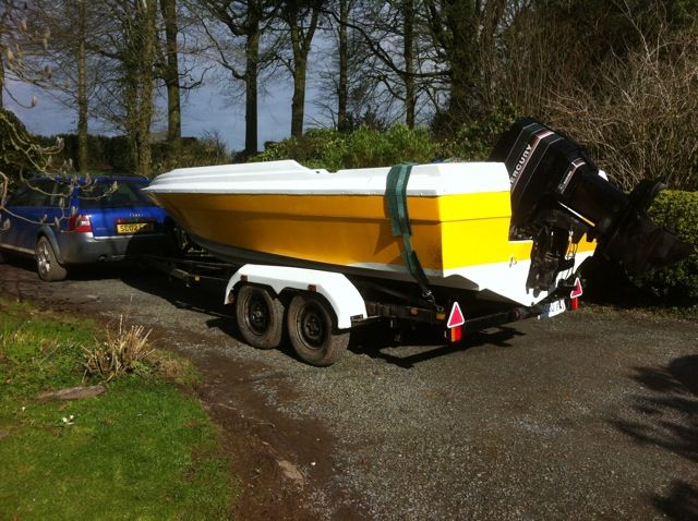

As I said, she now has the outboard back on. It's pretty exciting to see it with an engine on again and I really want to get this project finished as quickly as possible now so I can get it splashed in the Spring sun!

Very Innovative work on the Garage!!!! Looking forward to seeing her splashed.
