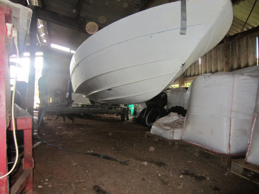

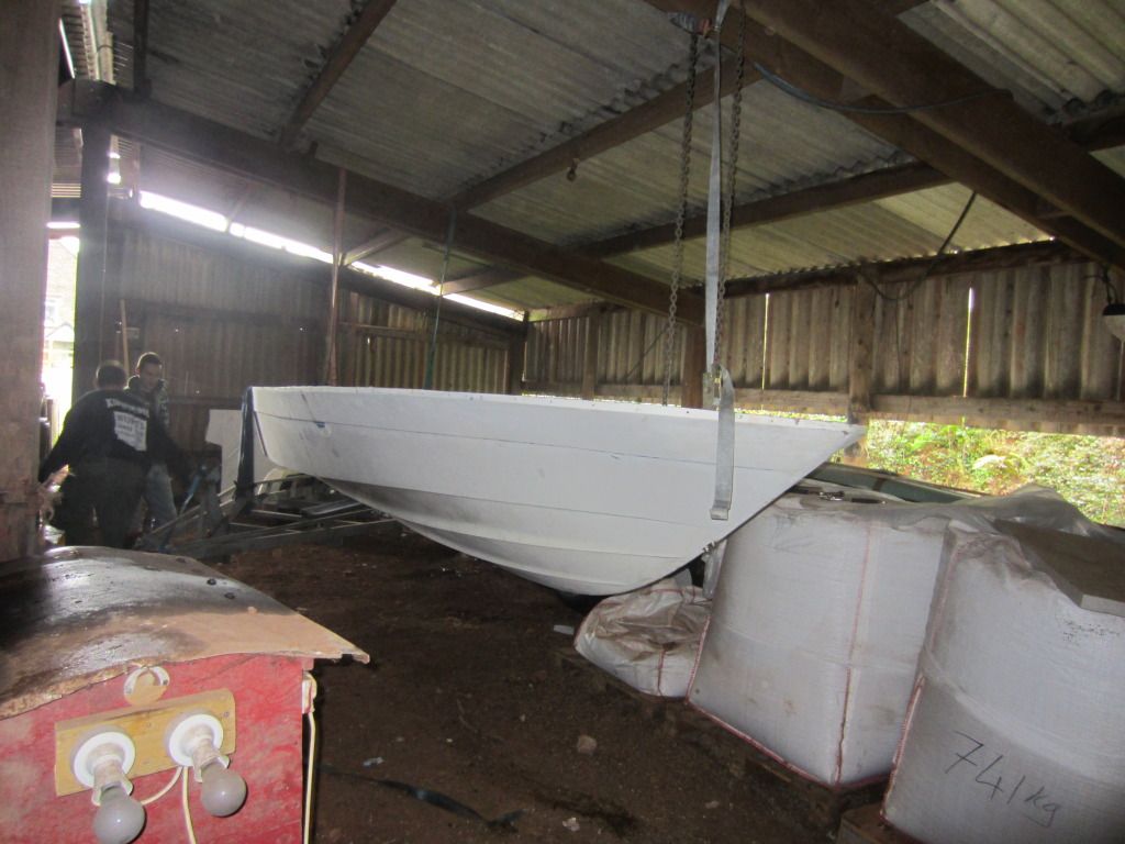

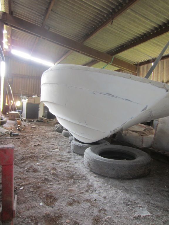

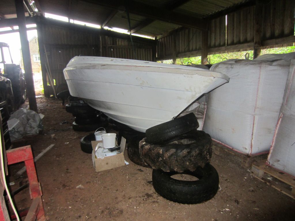

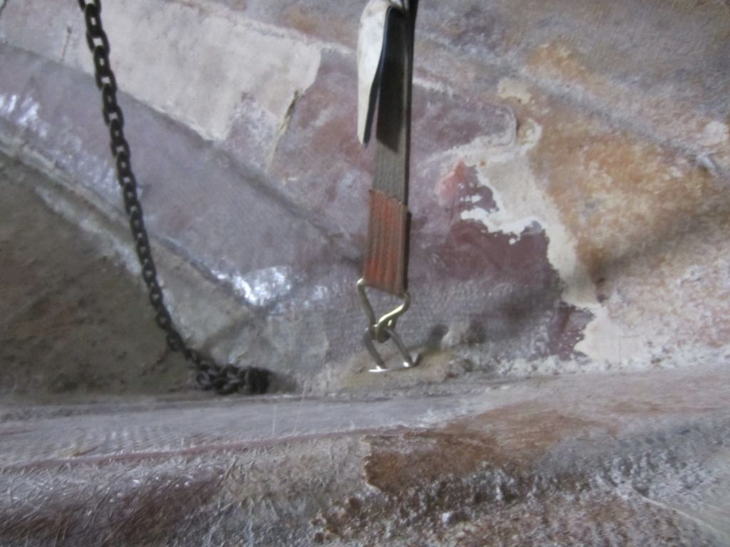

So I finally managed to get the boat off the trailer (with the help of a couple of mates). I re-installed some new U-bolts (although I won't seal them properly in place until after painting). I put the bow U-bolt in the wrong way round allowing me to use it as a lifting eye more easily:

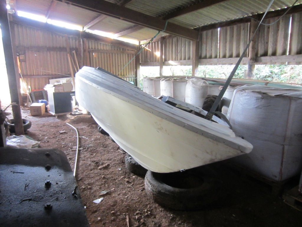

Using some big beams in the barn we were able to gradually lift the boat off the trailer using ratchet straps and hand lifting until it was suspended in the air:
We were then able to move the trailer out and put the boat down onto some old tyres.
My plan is to lean the boat right over to one side and then the other while it's supported on tyres to get all the fairing and painting done. I am going to get the trailer fixed up while the boat is off it as well (the brakes aren't working for starters as I found out last time I moved the boat, which was 300 miles!).

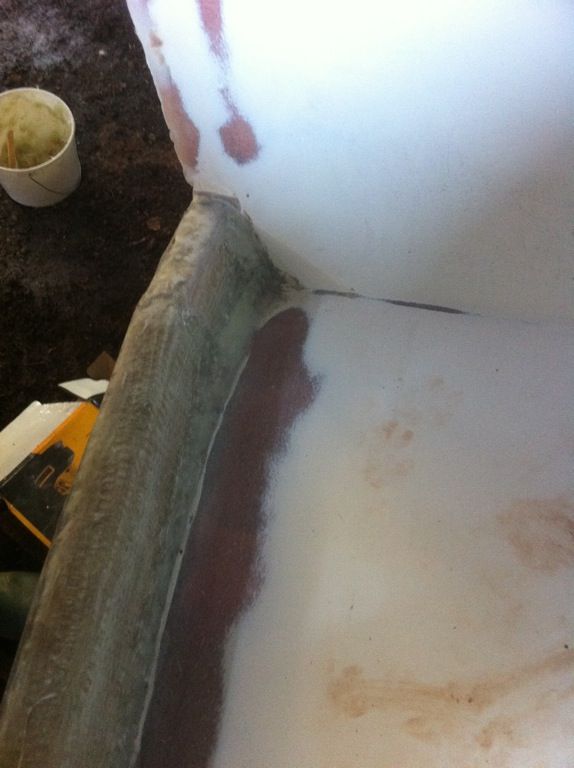

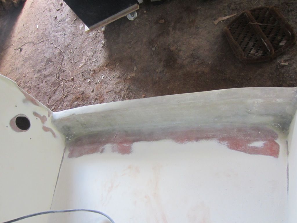

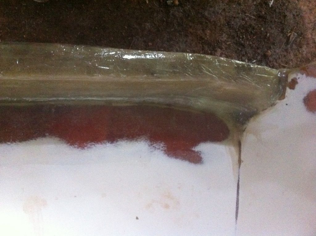

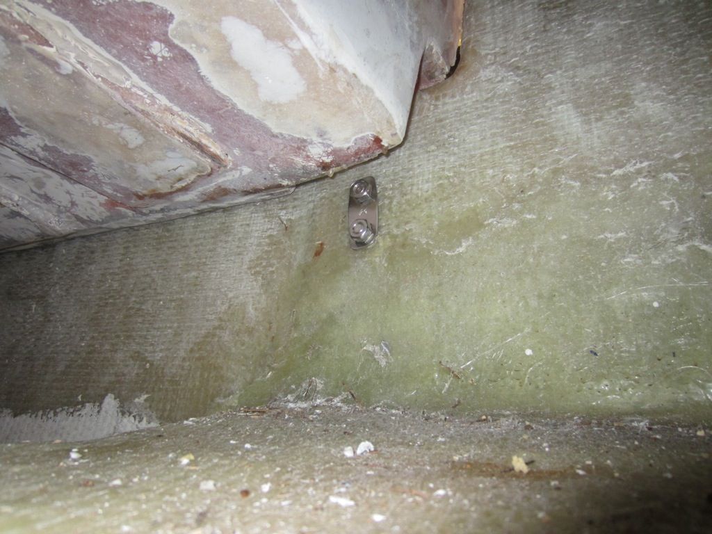

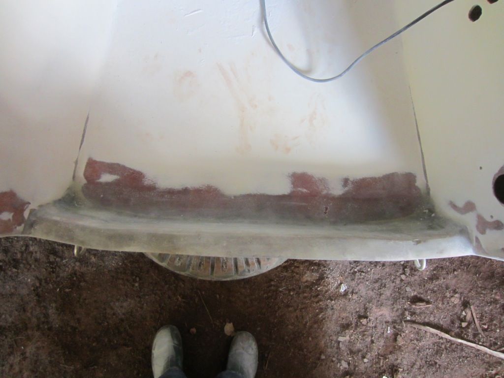

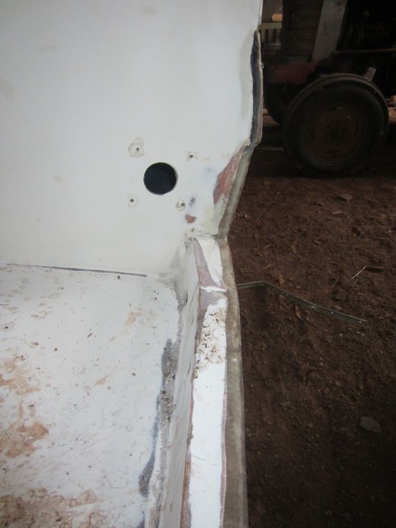

I had some time to work on the boat last weekend and managed to make a bit of progress. My new transom is thicker than the old one which meant that the cap no longer fitted at the back because the splashwell has a lip that goes over it. The following pictures show how this stopped the cap sitting in place correctly at the stern.
I cut the splashwell lip off with my angle grinder so that the cap fitted over the stern as it should.

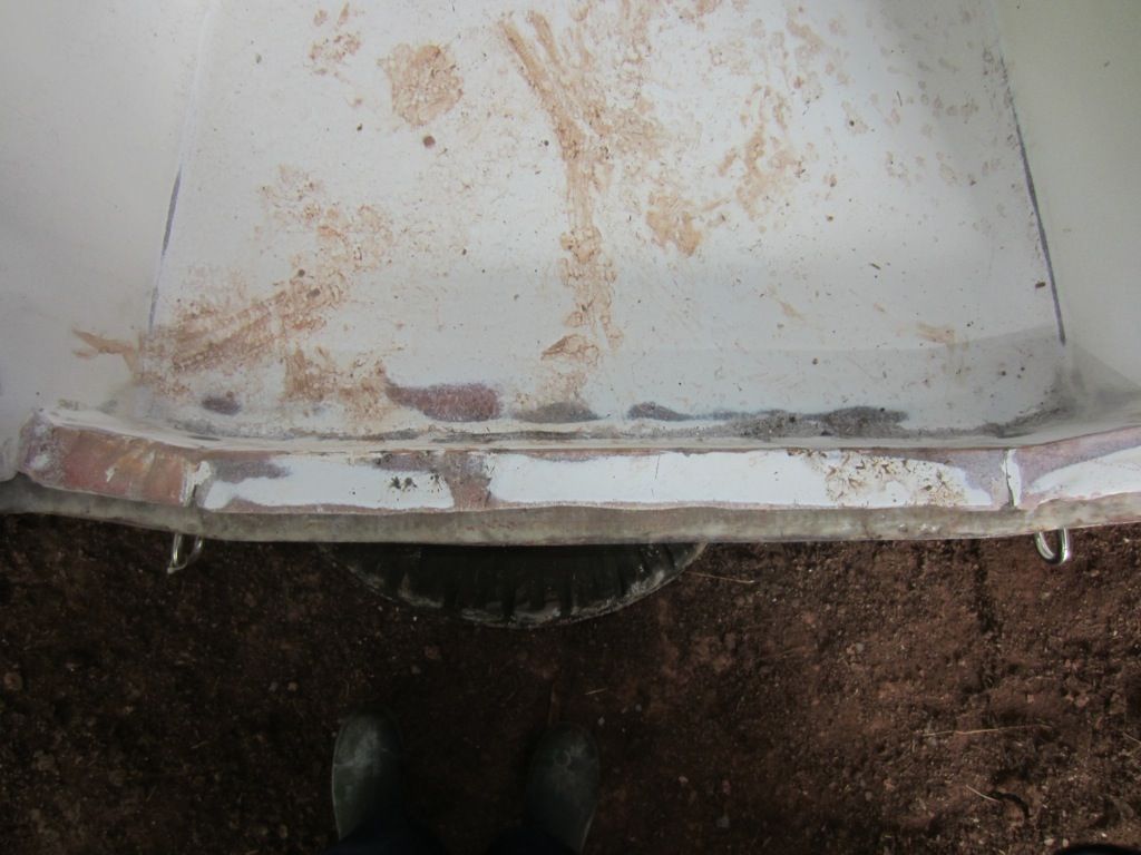

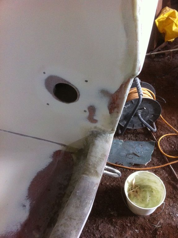

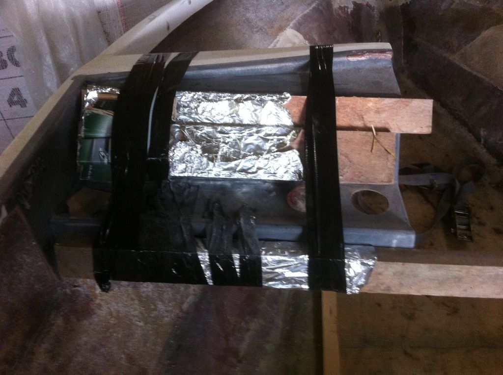

The next picture shows how the transom U-bolts are very close up under the splashwell so I needed to clear these with the repair so I could take them out again during the painting process.
I cut some pieces of cardboard to the right size and covered them in foil, then wedged them in the gap between the splashwell and transom. I then mixed up some PB with chopped fibres and filled in the gap.
jmmacky
Jun 20, 2011
177
Re: Bayliner Capri unintentional restoration project
I sanded off the rough patches when it had dried, replaced the lip with a layer of CSM, sanded this down and then applied some smooth PB (silica and talc) to try and get a nice finish, although it will need some more sanding.

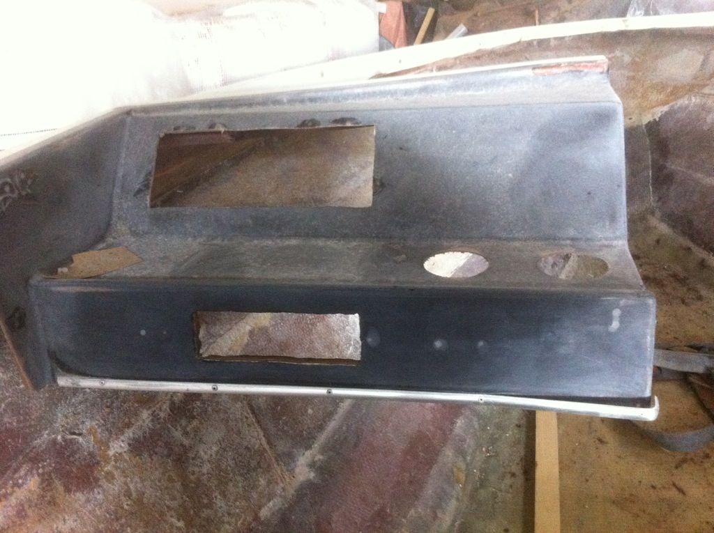

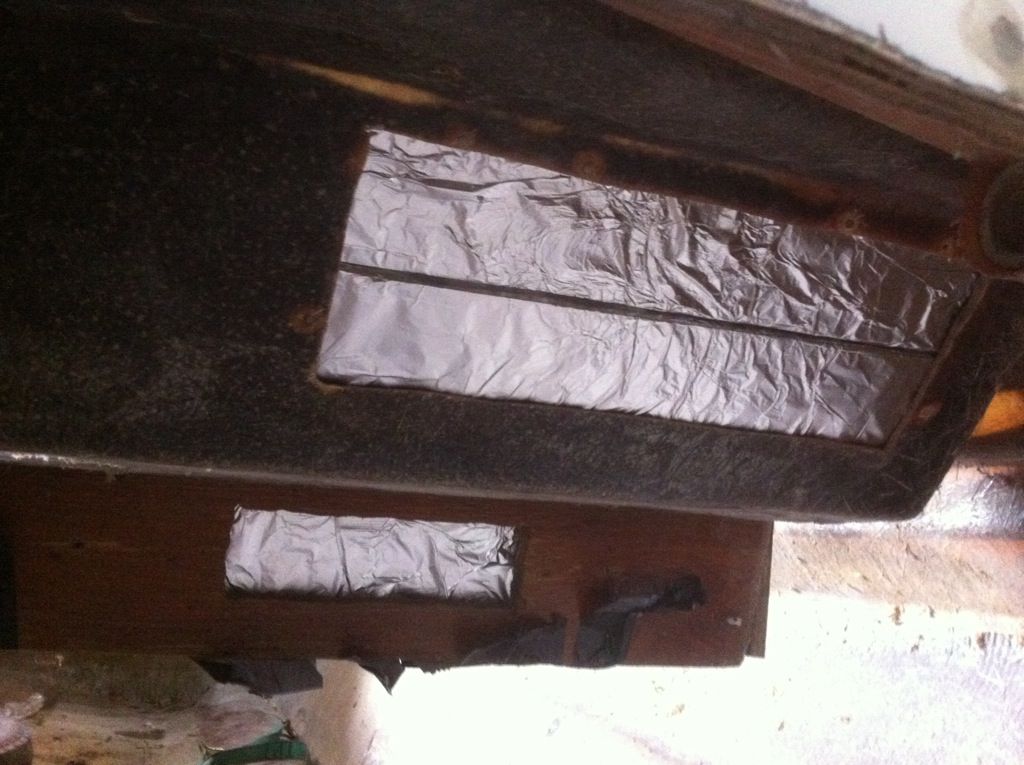

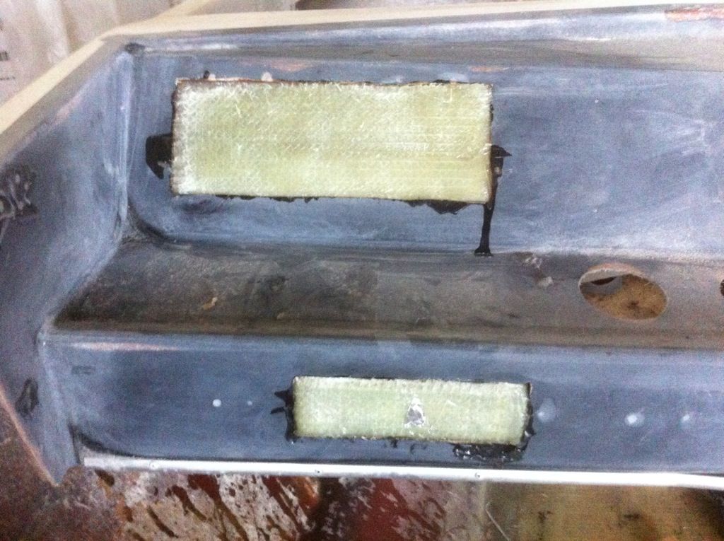

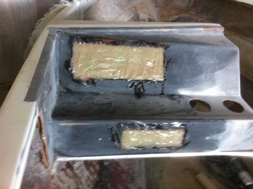

Inbetween doing the splashwell repair I filled a couple of holes in the port side dashboard area. There was a couple of cheap plastic things in these for storage. I'm going to replace them with better ones and maybe a radio so thought I should start with a blank surface so the new bits fit nicely. I covered some wood in foil and taped them over the holes so I had something to fibreglass against.
Into each hole I glassed a piece of my stitch matt (similar to 1708) with a larger piece of CSM over the top. Waited for it to dry and removed the wood.
I sanded this off and mixed up some smooth PB to fill in the gaps. I will sand it off flush with the rest of the dash once it is dry.
JM,
FYI, using Talc in you filler mix is somewhat controversial. Talc will absorb water to some degree so using it as a filler is not really desirable. If you could just use silica or what we in the states call cabosil or aerosil, it would, IMHO, be a much better mixture. You're doing some nice work!!!;)
jmmacky
Jun 20, 2011
177
Ok, thanks Wood, I hadn't realised that. Slightly worrying to hear! Fortunately, I haven't used it for any structural stuff just cosmetic. I was thinking about ordering some glass bubbles to use instead anyway so think I'll do that and mix it with the cabosil for making smooth filler. Thanks for the hint.

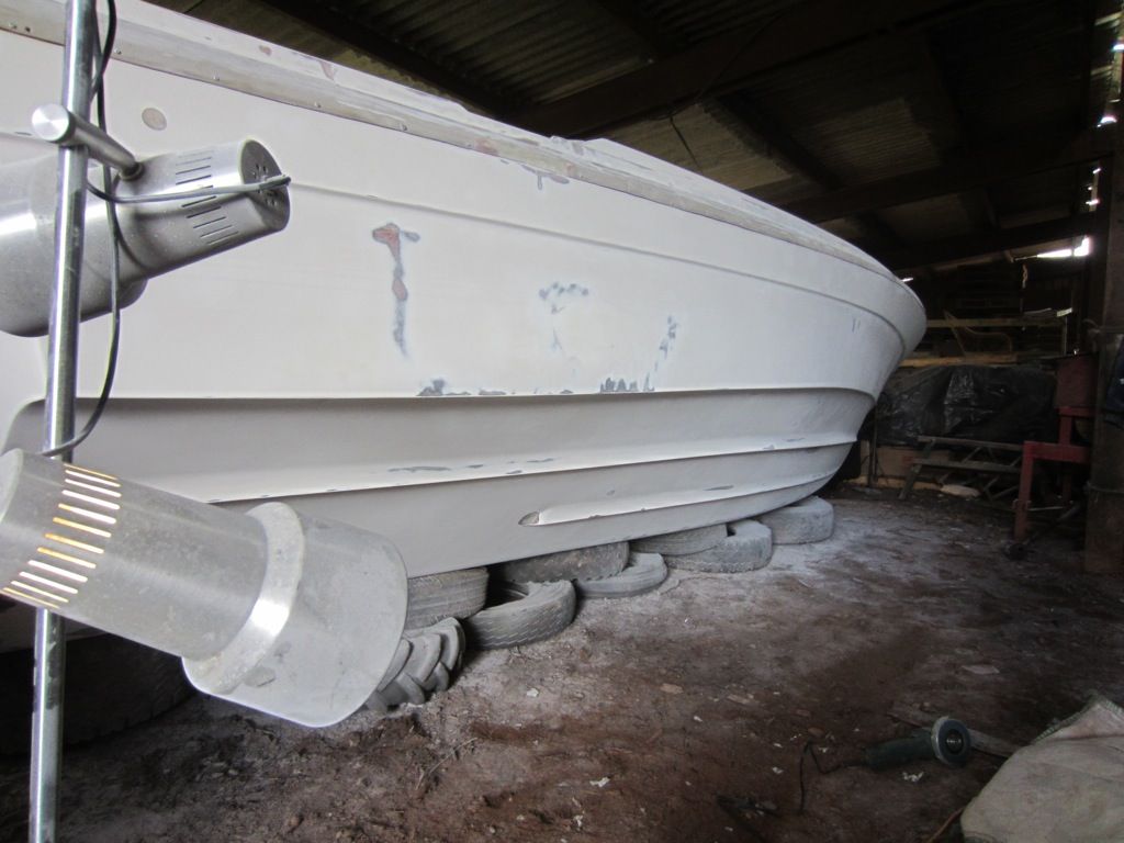

Many many hours were spent sanding this weekend! The entire starboard side of the hull and stern were sanded down with 80 grit level using my random orbital sander. The cap is now secured in place so I am tilting the boat in order to sand, fill and paint.
After sanding:
I made up some smooth filler using cabosil and glass bubbles this time which is really nice to work with. At the end of the weekend I then went round and filled all holes, indentations and undulations with the filler which I will sand down next time I have a chance to do some more work on it.
I also sanded off the stern where I re-attached/repaired the cap last time and I'm really pleased how this has come out. There was a couple of small areas I have now added more filler to but I think it will look pretty seamless after painting...hopefully!

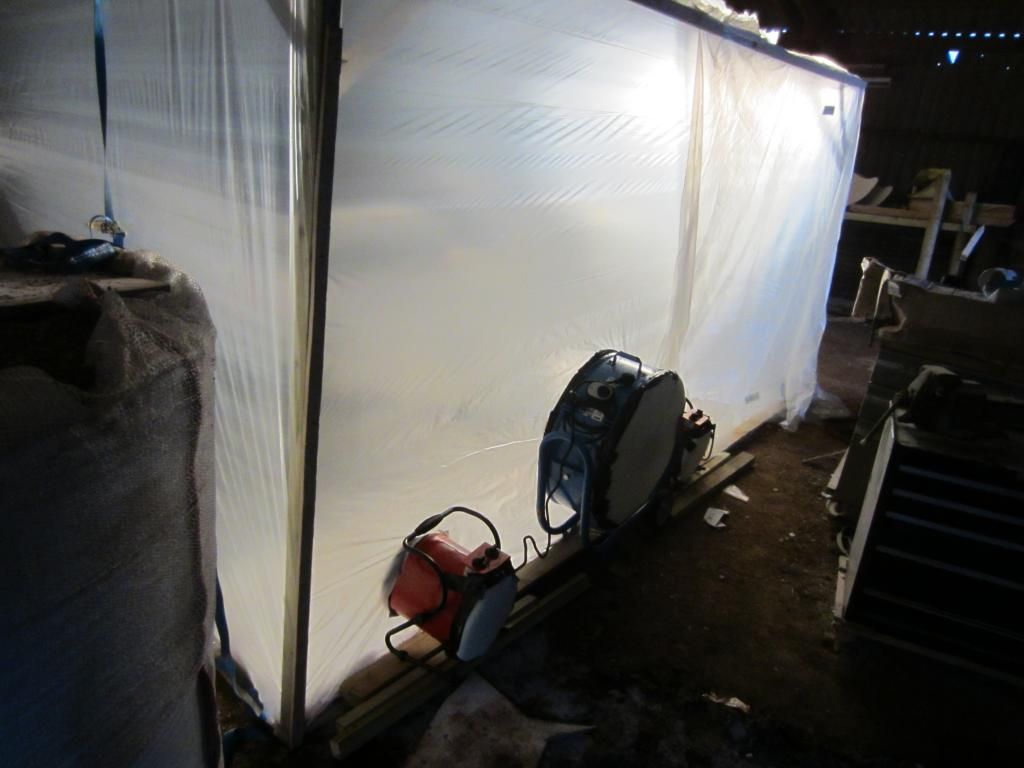

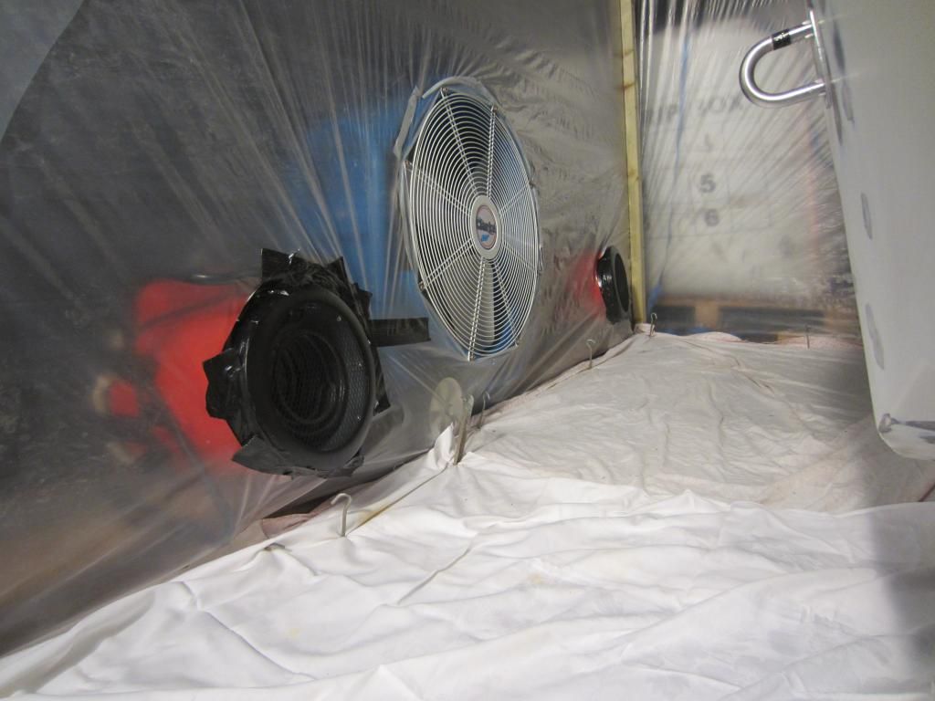

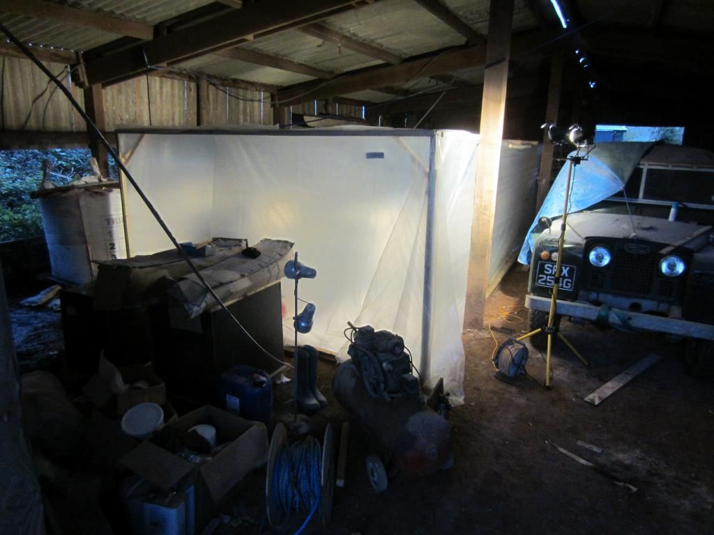

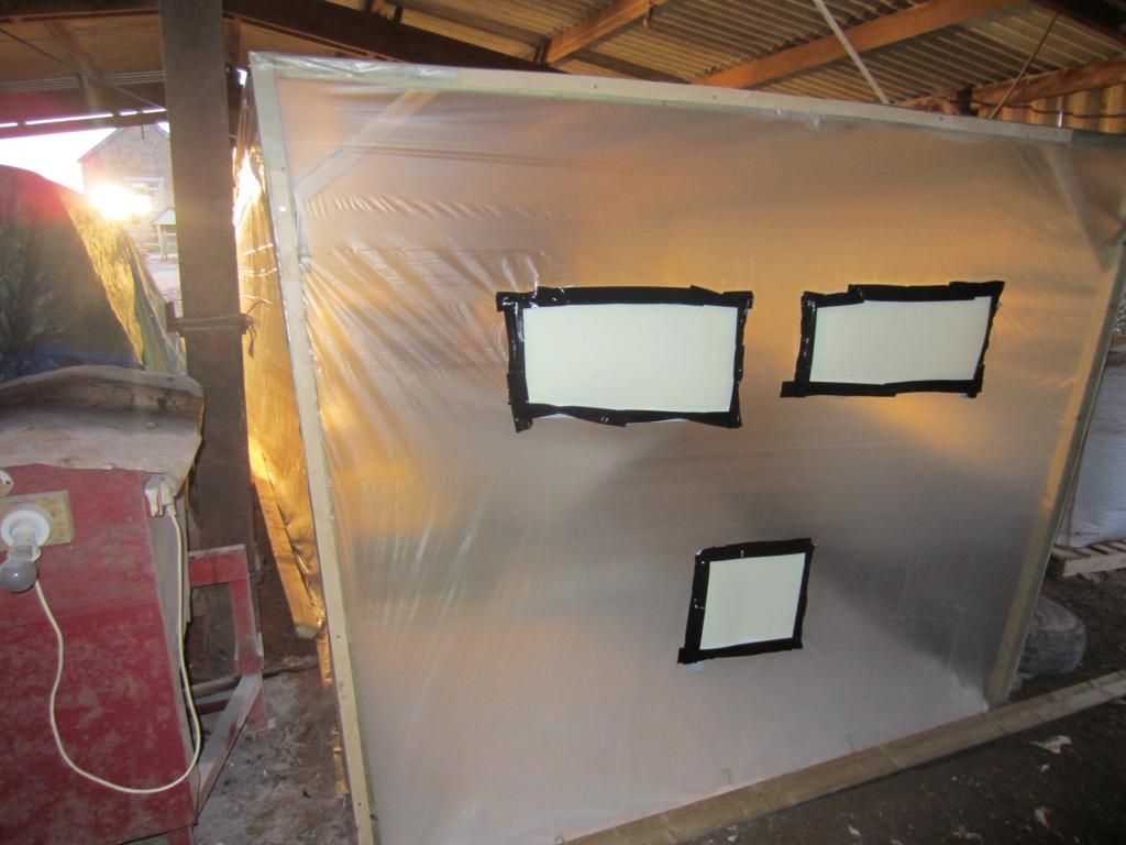

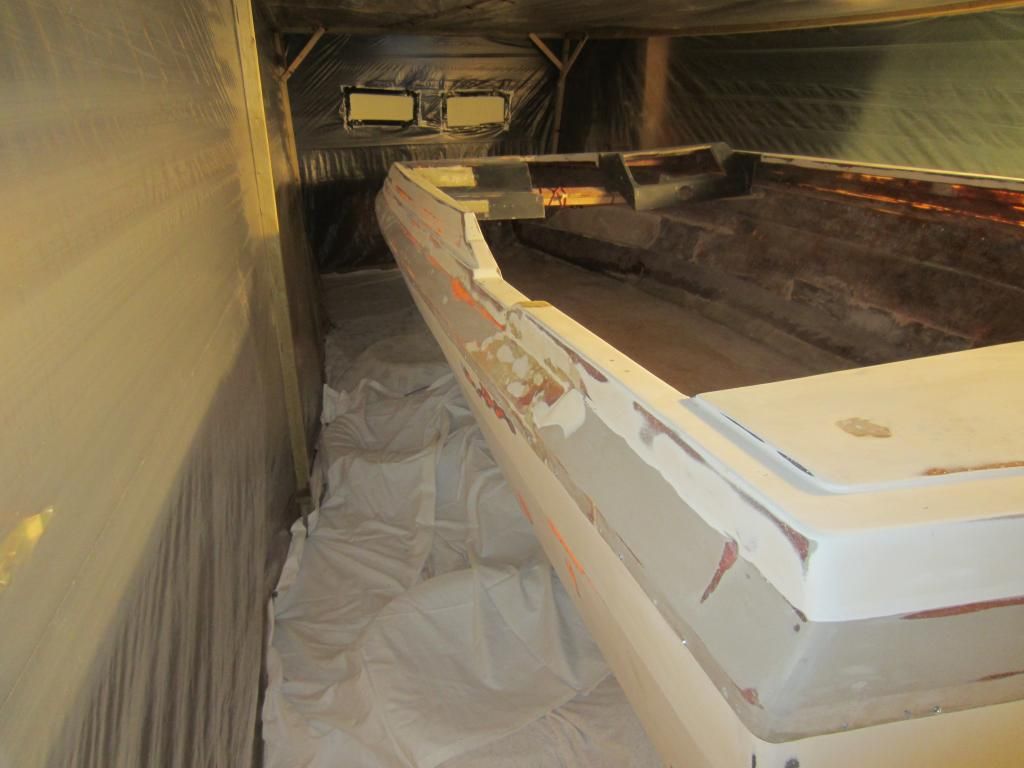

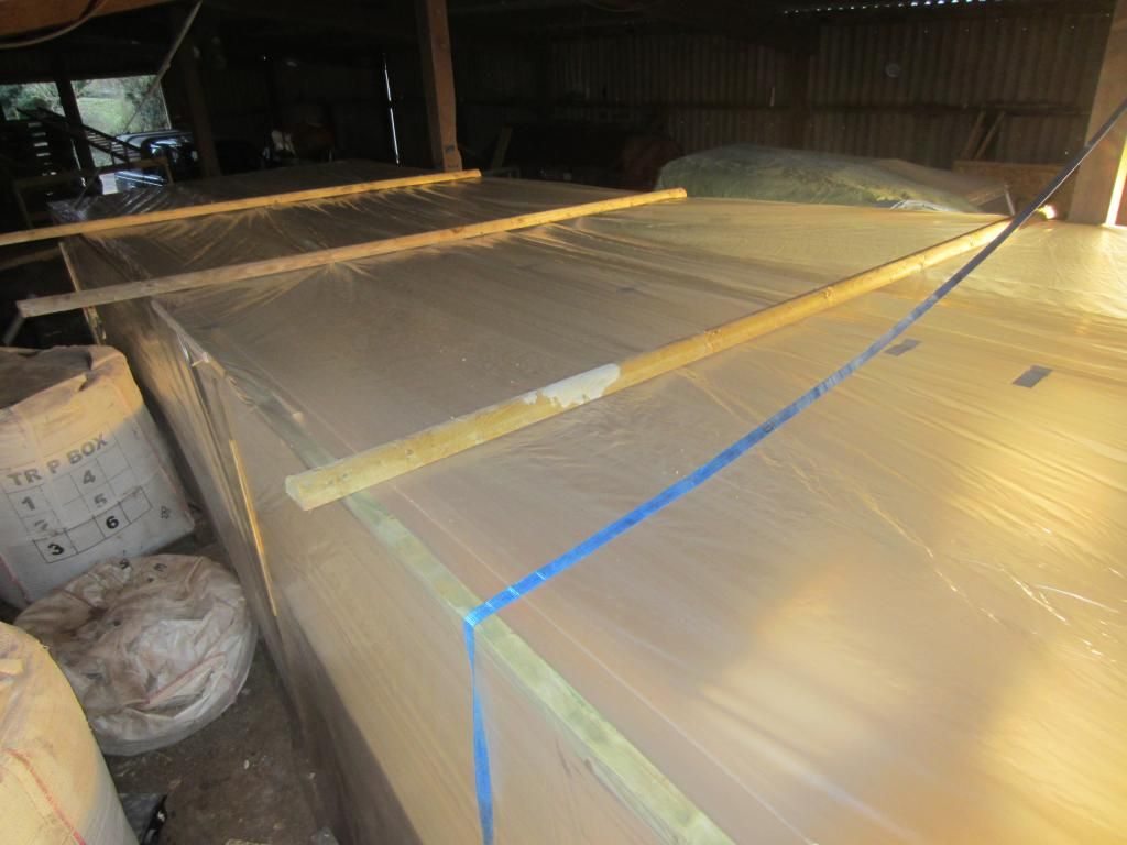

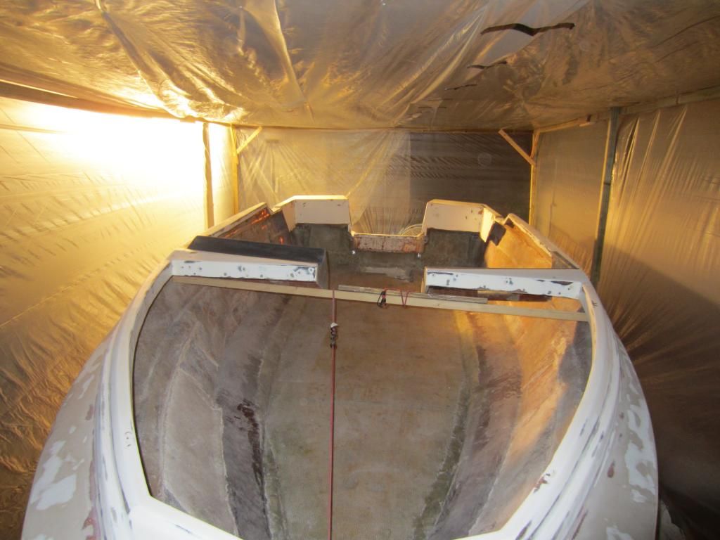

My spray tent is made! I've just made a basic frame with 2x2 and supported it with some struts. It's not particularly strong but it only has to hold up some plastic sheeting. I attached the plastic to the frame using small nail tacks and then re-enforced this in places with batons of wood I cut from some left over ply. In one end I have inserted a 24" drum fan and 2 fan heaters (winter here) and tape to seal it. The air-intake side of the fans I have covered with thin foam to act as a kind of air filter and the other end I have embedded some large squares of foam to act as a passive air outlet. The barn has a dirt floor so I've put tyres down where the boat is going to need support as I tilt it onto each side (using ratchet straps attached to the rafters through the plastic ceiling of the paint tent) and pegged down dust sheets to cover it. I also have some leftover plastic so this will go down as well. The bottom of the plastic walls are also pegged down with tent pegs. The whole design is very experimental! The idea is to not have anything electrical inside the spray tent, which is why there is no outlet fan. Hopefully I can get a good cross ventilation and keep it at a good enough temperature for spraying.

Sorry I haven't taken any photos today but the spray tent worked a treat! I've managed to get 2 coats of my high build primer down. I prepped the surface by first cleaning with water, letting it dry and then a final clean with acetone before starting spraying. I found it hard to spray such a large area as you have to do it in chunks but I'll wait and see how it dries. Also spraying at the bottom near the floor was quite hard but this bit will hardly ever be seen anyway. Tomorrow I'm going to sand what I've done, prep again and then add 2 more layers to that side. I can still see dark patches where the filler etc is so think it will require 4 coats before primer and topcoat.

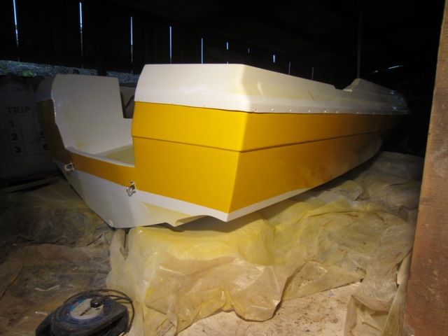

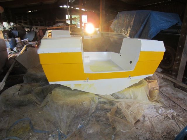

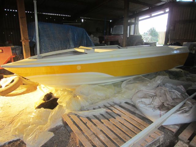

Sorry for the lack of boat posts recently. I have put many, many hours in over the last 6 weeks between paid work weeks on the painting. My spray tent worked really well but I think it was still a bit cold at times and I didn't always give it long enough for the substrate to warm up. I was pretty disappointed with the results I was getting with the high build epoxy and the epoxy primer. I didn't expect to get a perfect finish with my DIY spraying and complete inexperience but the finish was really rough so I had to do loads of sanding between coats and got through tons of sandpaper. Fiddling with all the spray settings each time didn't seem to make any difference. It took hours, was awkward and really frustrating. However, luckily the polyurethane topcoat laid down much nicer, leaving a pretty smooth finish with just a slight orange peel texture to it. I used painters masking tape and then reverse taped it for the stripe.
...But it was still not smooth sailing as I hadn't realised how much paint vapour is created! So there is a lot of overspray from the yellow onto the white as you can see in some of the photos. In hindsight I should have covered everything not being sprayed in plastic when doing the colour but you live and learn! I was planning on wet sanding the entire thing and polishing anyway so this will hopefully get rid of all the overspray - there will just be yellow in some divots in the white where I didn't do enough filling. Because I was starting with a 'high build' paint I thought this would fill in small holes/divots but it doesn't and I should have been more thorough with the filling but no one will notice when it's flying past them in the sea!
