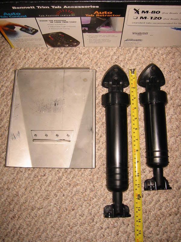

Put a straight edge on the hull and compare the tabs all of the way up to the straight edge, the tabs should be slightly higher than the straight edge when they are fully retracted. Can you post a picture? If it is the mounting place of the tab itself that is one thing, if it is the mounting of the hydraulic ram that is another. My guess is that you will have no issues once you take off that POS from your drive.

Bennett has different sized actuators. You might see if a shorter one would solve your problem?

I had a wonderful conversation with Thomas at Bennett, he seems to think that due to my hull design, they are slightly toed in. He is shipping me a set without the wings going down, and the mounting point for the actuators is closer to the rear of the tab which will in effect have them raised further when fully retracted. Skeg was a little off to the left, the rubber mallet straightened out. THE FOIL IS GONE. Will try it out as soon as possible. The people at Bennett know I bought this boat with these already installed, but are going WAYYYY out of their way to get everything working right, and me happy. I am most definitely a lifelong customer of their now.
