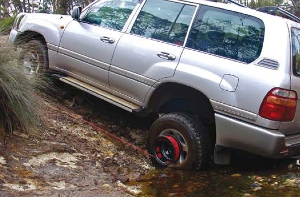

Could use the "Maine winch" method a buddy of mine into mudding told me about.
Hook a rope to a stationary object. Wrap the other end of the rope around one of the front wheels, and put her in low gear. Of course this plan is bust if you have an open front diff, and if it didn't work I wouldn't be a bit surprised... :D
I've done this. It wasn't the smartest thing I've done but it worked. I have nightmares about what would've happened if the strap slipped off on the inside of the axle.
So that's what you call it!! A Maine winch. I thought it was just a dumb ***** mistake on my part.
