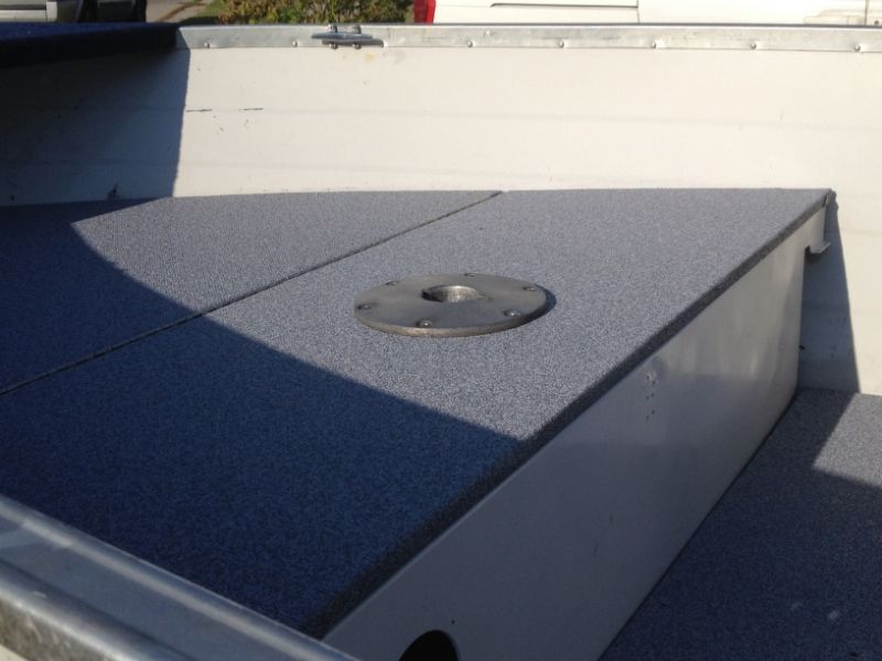

I ran out of foam but was able to get the bow and about half of the boat filled with it so I decided to start putting the floor and casting deck back together in the meantime while waiting for it to get here. I really like how the vinyl came out so far. Hope to be done and on the water soon.

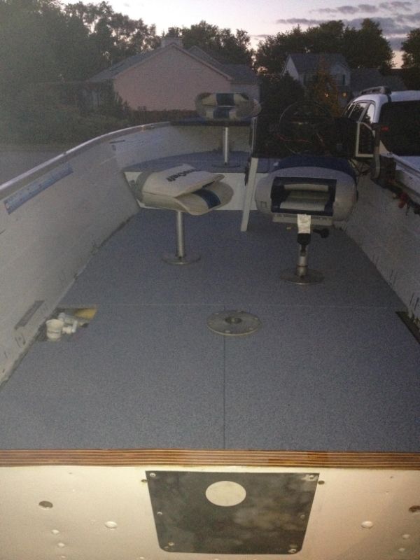

Thanks! I finished with the rest of the floor last night. Crappy pic at dusk but you get the idea. I am still waiting for the remainder of the foam. I think that I may pour with the floors on and let it fill the voids. The main drain channel is dammed off so it shouldnt be an issue.

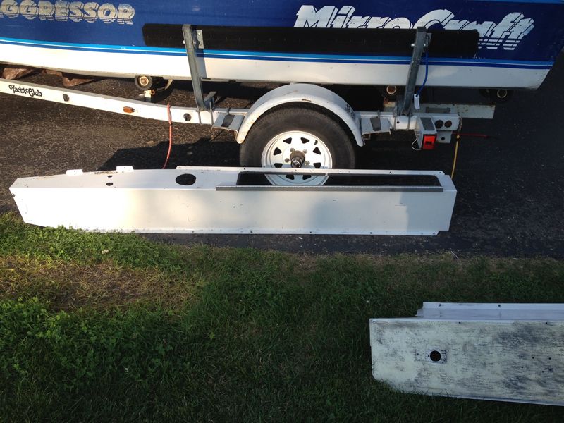

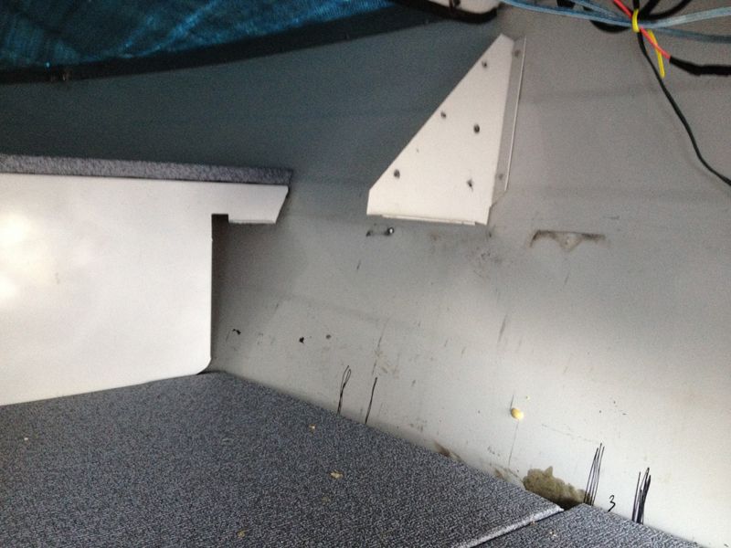

Site was down last night so I couldnt post. Here is the situation. This piece is the rod locker, it goes underneath the drivers side, through the console and into the casting deck in the bow.
Since I had raised the floors I did not take into account that this may not fit. There is a bracket there for support that now is too low and does not allow passage. It is riveted in and I do not want to remove it but most likely will have to. That is just to see if it will fit in the bow section. If that clears I still have a concern with the rivet holes lining up. They still match on the port and rear starboard sides but here seems different.
Here is the bracket and the bow cut away.

This has got to be one of the dumbest designs going. Compartments riveted into the hull and dependent on the thin 1/2" with foam for support. I mean the compartment hinges are RIVETED into the side cabinets. So if you needed to change the hinges you would have to drill out rivets in the hull. What a joke, also I was thinking of doing away with all of the compartments and just having it open but the splash well is also dependent on the them. I am however scrapping the rod locker since it was basically worthless to begin with. I will have to figure it out from there. Just hope that splashwell lines up. Sorry for my rant just a little frustrated, just seems like a hopeless situation right now.

Nah, it aint that bad BD!
You may want to consider cutting the section of the rod locker off that sticks through the bulkhead and just let it butt the bulkhead instead. You could use some aluminum angle to cover the butt joint on the outside and fasten the 2 pieces together through the angle with rivets.
The bracket looks like it's only held on with 4 rivets and you could take it off, then set the rod locker piece and install the bracket back after. Use the same holes through the hull and drill new holes in the bracket.
Even if you don't use the rod locker for fishing poles, you can still use it for storage for other things like life jackets and stuff.
All the hatch cover hinges in my Tracker were attached with rivets like yours are, I drilled them all out and replaced them with stainless screws and nyloc nuts. They use the rivets because they're quick and cheap.

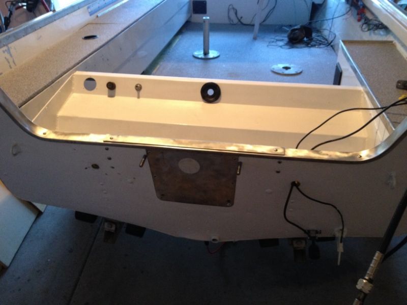

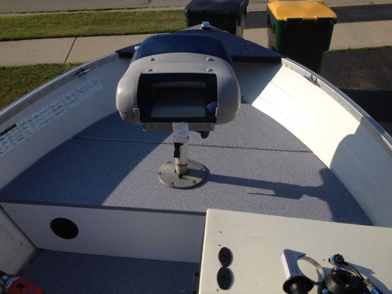

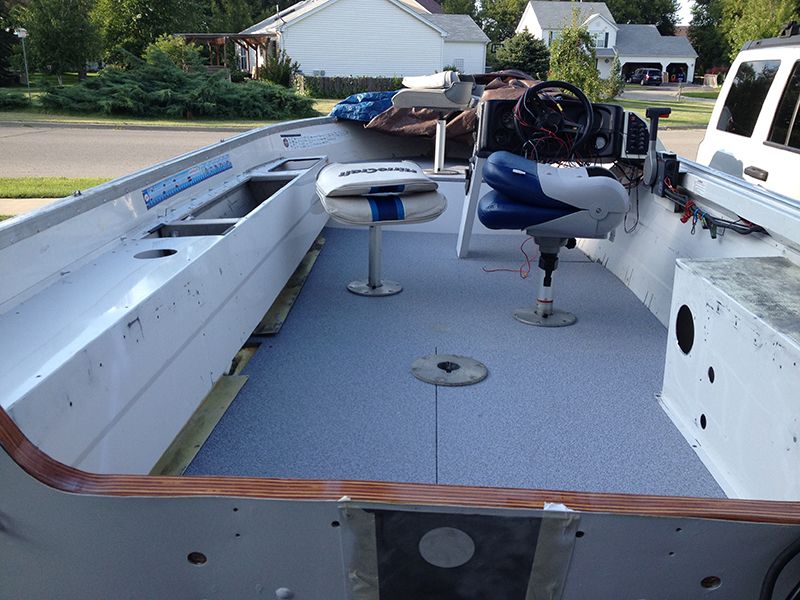

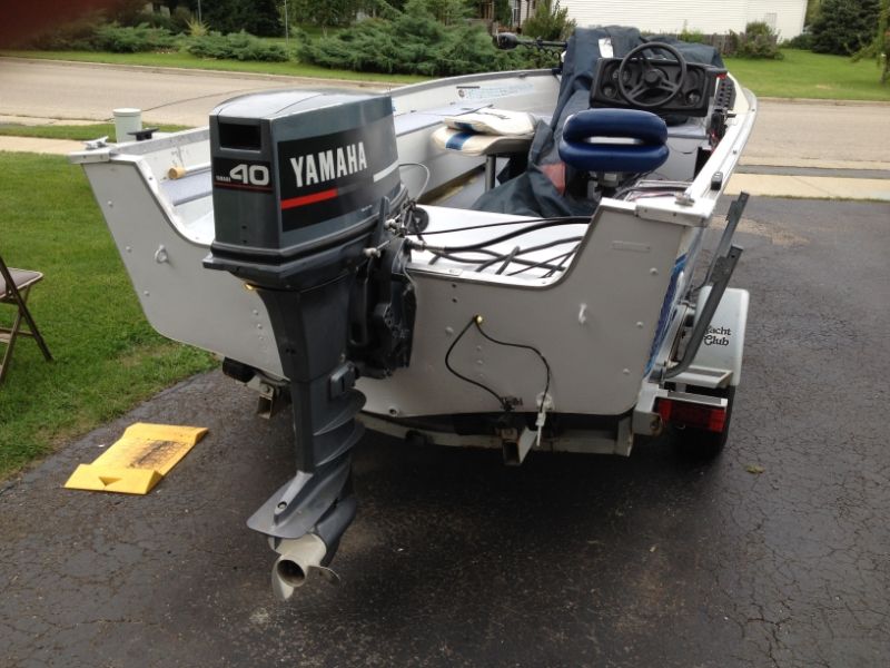

Didnt get a ton done this weekend due to weather and family issues but making progress. Slowly but surely. Splashwell isnt fastened yet, I wanted to dry fit everything before I start riveting. Photobucket isnt functioning for now so hopefully these will work this way.
Browndog10
Petty Officer 3rd Class
May 13, 2014
89
Splashwell and wiring done. Had to work partially in the garage due to rain. Hoping to get the motor on this weekend.
Browndog10
May 13, 2014
89
I got the motor on before the storm the other night. Installed splash well drains and put the bow together and wired this weekend. Not sure if I want the electric anchor yet. Hope I have a productive Saturday between the kids soccer and my softball game and be able to float test launch Sunday. I have a few more things to take care of and hook up. I hope I didn't forget to seal something. Sphincter clenching for sure, but getting ready for the fall feedbag! :)
