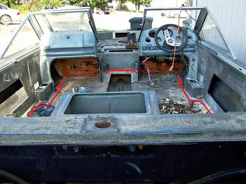

Here is where I am so for, I just started cutting and it looks like it would not have mattered anyways because the floor is pretty rotted would have needed to be cut out anyways. But once you get to the back seats that wood is dry and solid I am hoping that when I take the cap of it stays that way. Anyways here some pics let me know if you think I am starting the right way. My floor was screwed/nailed down there was no way I was going to be able to do what GT did.
I need to know if I should cut closer to the edges, Let me know what you think on that also

It looks like you are cutting the deck out in the central area of the boat. I may be mistaken, but the bottom edges of the console that I highlighted:
look like they are holding the consoles to the deck. The upper outside end of the console is attached to the cap, aren't they?
Until you get these areas freed, there's no way your cap is coming loose. As well as any other structure tying the cap to the hull or deck.
Have you read thru so other resto threads? You need to make sure you've got lots of pix & measurements of the boat before you dismantle it. When you take the cap off, the hull sides could droop open, or the bottom of the hull sag, if you glass the deck back in (or stringers/transom) while the hull is out of shape, the cap may not fit back, or fit correctly.
Most build a cradle to fully support the hull during demo & put back.
Just to be sure we're talking about the same things, the cap is the top portion of the boat, like the lid of a shoe box. The hull is the bottom portion of that box, and the deck is the 'floor' between them, on top of the stringers.
The areas you highlighted have already been cut it is the same way on the other side also. I did find that the cap is also attached in the front of the boat, in the compartments those have beem cut also now.

Best I can assess w/ out crawling around on your boat, is that under that casting platform in the bow, and under the doghouse, seats & rear platform the hull & 'cap' (or whatever you call that 1pcs interior & cap), there is additional glasswork, or expanding foam still holding the 2halves together. In addition to the transom/splashwell connection.
If there is anyway to see up & under those platforms, even hand held camera stuffed up under there...
To answer your question about damaging the cap, do your best not to by carefully lifting & supporting it as best you can. If you do, more grinding, then resin & glass work, possibly some work to re-align & support the joint thru repair.
If you check thru some threads, instead of removing the cap, some restos cut the splashwell off across the gunwale. Remove it, and just have to do a more visible repair to the finished surfaces of the gunwale. You may end up having to do something similar to get the cap off....

look like a standard bass boat. firstly follow the advice of making a cradle as it will save you time later. next tie a 2x4 across the front dock hooks then put a strap in the middle and apply a little pressure then with paint scrappers and chissels start to dig into the floor and under the cap around the consule and lip. they appplied the top on to the bottom with thickened resin it will snap like glass and the top section will come free. its more of a peel of the top job then a lift job.
http://forums.iboats.com/attachment.php?attachmentid=142923&d=1335324097&thumb=1
the link shows a pic from my rebuild where i had to break the cap from the floor. there may also be a piece of glass in the very front if you pull the switch panel up front it will be up front that you can cut. once the front starts to loosen you can add a little pressure on the lift and work your way to the back looking for places its stuck (you wont break the cap as long as it never comes more than a few inchs up once you get to where its holding the transom then put another 2x4 across the rear dock hooks and a 2x6 down the middle of the boat and tie it to the 2x4 so when you lift the frame it will share the load over the 4 dock hooks)..once you get to the back you have a few options. if you can get to the skins of the transom then cut around the splash well into the inner transom skin then chissel the glass to break it where the grinder doesnt fit (the pressure from lifting the front will realy help here as the glass has to be ripped of the transom) or you can cut a window in the cap so you can get between the spash well and the transom. the resin is a pain to break free but you can do it this way as i did mine. the other option is to cut the rear of the splash well out which is the way others have done it. if the transom is soft i would cut the inner skin and keep the cap intact. if the transom is solid then i would cut the spash well as you are going to have to repair the cap so weather its a window or the back of the splash well its still a repair plus it will save you 3-4hrs of hammering and grinding
http://forums.iboats.com/showthread.php?t=543698 (my post ignore the rest of it the picture of the top being seperated in on the first page as the link i put earlier is to small)

Taking the cap off will cease until I get a crane and cradle made. So how do I make this. I can not pull the boat off the trailer like others have as I will need to put the boat in the garage cause I will have no where to store my trailer. I need a system that I can build that will allow me to lift the boat off the trailer and allow me to set it onto a cradle.
Anyone got any Ideas? Or writeups on what others have done. I know Oops did it, but he did not show how he raised his or lowered his on his boat extension thread.

Ok, I read a thread where oops told them how to get the boat of the trailer by just lowering and raising the front so I am going to try that. My question would be where to brace the hull at, and Should I do brace it the entire length of the boat?
Here is a pic Do I brace all locations?
