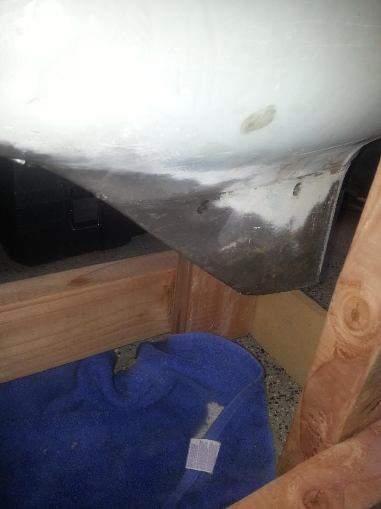

Alright guys, the flying nun has thrown a bit of a problem. Underneath the hydrofoil there are now 6 holes pictured below, what to do what to do???

Hmmm, what some people will do to a drive to put a pair of wing on it lol...I guess al the holes are for different mounting positions, shrug..
Its just the exhaust port area, so if youcan figure a way to fill them before painting, like with jb weld, or something less runny..you coud do away with it....then theres still the mysterious skeg plate..

I think the gasket belongs to the steering knuckle, it just says volvo penta / made in sweden on the gasket itself. Whoever put this together must have gotten a special deal with silicon sealer; it is everywhere. I can't get the drain plug or the dipstick out yet. As for the holes; can I just leave em?

Here is the removed skeg plate; by the way WTF is a skeg plate for? More holes, I may just leave it if there is no real effect.

The skeg is like the rudder, to help steer the boat. Yours has either been dragging ramps, or the bottom...The wings I imagine help keep the bow down on plane....You can just paint the drive and put both back on, I don't think it will hurt much, but may improve performance.

I am going to do a little more research and find out more about them. The bigger problem for me would be the holes; so I'll just knock down the surface on the lower unit and throw on some primer/paint combination and for tonight plan on putting them back on. Thats good news that the transom IYO looks good cuz thats what I thought. Everything is cleaning up slowly but well so I am pleased with the progress and what I am doing; of course with your help! I forgot my other truck had my tool bag in it, so I did not get to pulling the flywheel plate? to get a better idea of the bearings and so forth. I looked through the older posts and could not find the answer to the pressure plate black gasket re-use or replace. I did not order them, but certainly can if the answer is replace. Also, the transom gasket split; does it go on the top or the bottom when I re-install. I read some top and some bottom?? When you put them on what do you do. Your craftsmanship seems to be better then most factory fit and finish. Just a thought for you rather then keep fighting with the weather and elements; wouldn't another out building on your property make sense? You could call it the "Harbor House":)
