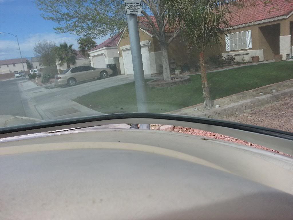

Picked up a windshield tonight for 100 bucks, it is from a 1991 17ft bayliner br. I'm not sure how well it will fit; but I do think I can MIH at least close enough for 100 bucks, it is missing the glass in the middle frame but when I go get the Xylene at HD, I will have measured and fit it well enough. If needed I may have them cut it a bit wider to make up any different and figure out the frame at that point.

However, I did try our purchased windshield today on the build boat; NOT even close!! I will make it work though; you all can throw me ideas on this to help out.
