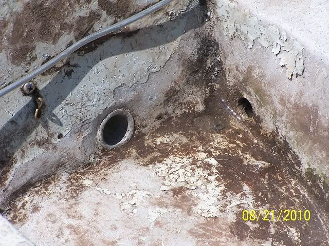

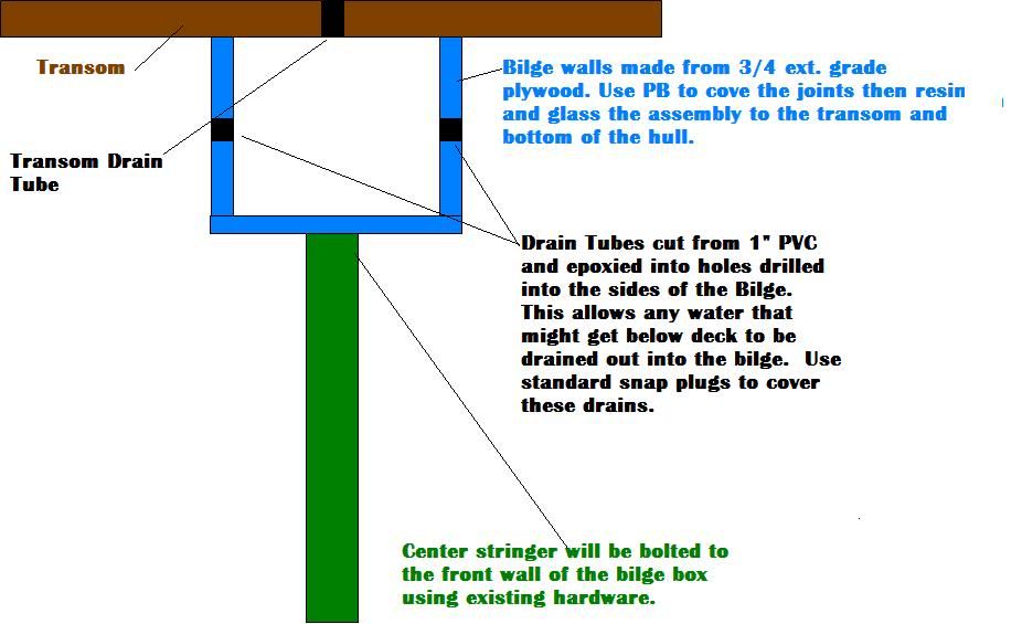

I've never had to use a bilge pump. But if I was going to, I'd plumb it with 3/4" flex tube and port it out the side of the hull under the gunwale at the rear. As for your Bilge, No screws needed. Here's a drawing of how Mine is built and how I'd recommend you do yours.
Crappy pic of mine when I first got her. You can see the side Drain tube. Another one on the other side you can't see.
Here's how it should be built.

Wood thanks for the drawing ... that is the way I will do it. I have a question, both you and Kent mentioned to use pvc pipe and a plug or cap. Why would you want to put a cap on these? I would think that you would want the water to go into the bilge wether on the trailer or the water. I am missing something.

Well.... If, I mean, When water gets in via rain, or splashing or Transom Wash Over, or what ever via "Deck Side", you don't want water going under the deck via these tubes. So they are Only there in case of a puncture to the hull or deck allowing water under the deck in an Unwanted case. Make sense???
